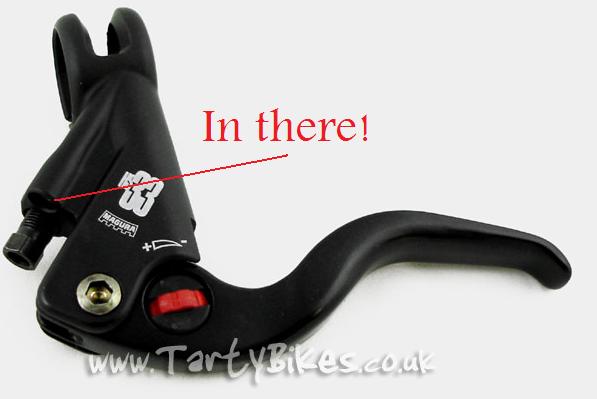

it should look like a grub screw, [so you'll see the space for an alen key] theres not alot to see, if you don't understand i'll use my amazing paint skills though..
ninja skills...
Some amazing paint skills there. Thanks for your help, i'll try and bleed it again tomorow night.
