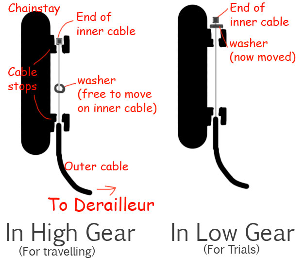

The solution to your problems:
You need to do a bit of tinkering with limiter screws and whatever but I can now change gear in around 2 seconds, it works perfectly for two gears :D
Thanks Tom, that pic is really helpful, i think im gonna go to my local bikeshop and see if they can set me with it.
