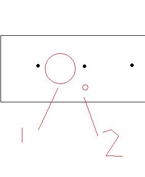

Drilling Holes In Rim Next To Nipples

If you start with a small enough drill bit you wont have a problem. Your just not holding it still by the sounds of it. I've never slipped on metal. Maybe that some with experience. I personally wouldnt bother drilling it though.
if its still built up, mark out your centers properly, center punch em, stick the hub axle in a vice, hold onto the rim and use a hand/pistol drill to drill em.
shudn't be much need for a pilot hole on these as you wont go above 6mm anyway (or shudnt do (Y)), id personally go straight through with a 5mm, would take plenty of material off and would look nice if you managed to put a slight (6-7mm) countersink on the outside.
No need for a pillar drill for the insides, might even be a problem finding one you'd even fit the rim in that way, know mine wouldnt go that high :).
Josh.
EDIT- Why not take the rim tape out? would make things easier for you
Edited by Rob Leech
When I did my rear rim (I did 4 holes around the spoke hole) I made up a little template/jig, centrepunched each hole and then rinsed through them all on my dad's pillar drill. Even then it took a LONG time, not sure if I can ever be bothered to do it again!
