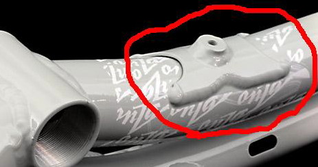

If you land on it hard, all of the force of your landing is put through those three relatively small areas, into the downtube/chainstays.
The smaller the surface area a certain force is spread through, the more pressure it will exert.
Edit: Meaning if the mount is on a large gusset which is welded to the downtube, it's less likely to crack than one with a small/no gusset.
A frame won't crack just because it has the mounts - but it does dramatically increase the CHANCE of it cracking there.
The old polished T-Mags were terrible for it as they did not feature a gusset like the one pictured above (clearly Onza learnt from that mistake!). I think it's more of a question of bad design. A bashplate is there specifically to be bashed instead of the frame, it wouldn't be doing much good if it still caused the frame to break! If well designed the bashplate should prolong the life of the frame; even if when the frame finally fails it's at the bashplate mounts, the main point of including one is to extend the frame's life.
