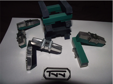

but i always have to rely on tar to get a good hold, i've used rockman blues (plastic backrings) , tnn lgms , tnn belaeys and heatsink yellows in tnn backring.

Using TNN LGM's or Belaey and i know that is wasn't the pads as i was using the Belaey on an echo urban rim before, And they where working amazing as they do,
So i got a echo tr rim and they where working mint on that to so yeah i found that it was the rim, Pads just don't like it :ermm:

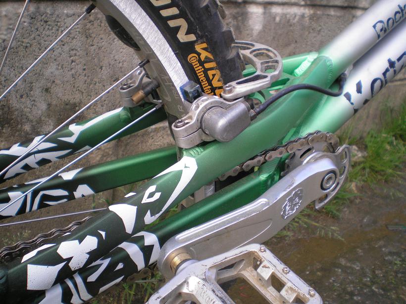

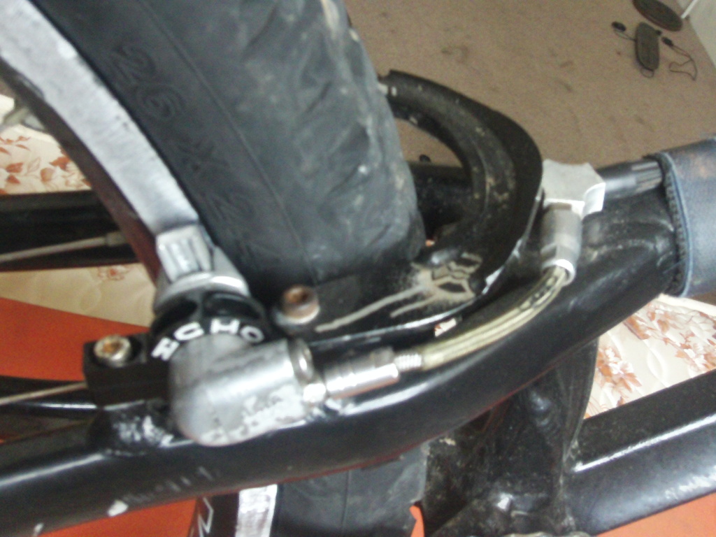

Only other thing maybe try a 2 bolt booster and put the booster on top of the clamps using smaller blots like in the pics
post-18818-0-59676600-1304780687_thumb.j
post-18818-0-85561200-1304780711_thumb.j
Hope this helps
Jamie

I am finding a similar problem with my atomz UN Elitis rim, only seems to hold a grind for a very short time using Rockman blues and TNN Belay pads which are some of the best performing pads on the market. The next step I am taking is to try some heat sink yellows as I used to use them on a tryall rim with a dead grind and found them to be awesome. New rim time if that dont work.
Has anybody else had problems with their trialtech rims not holding a grind? Because I have used a sport 26" rim and two SL 26" on the rear. I also have used two front square holed 26" rims from trialtech and I think they actually hold a grind amazingly!
I have also found out that TNN belaey eat the grind as they are pretty hard compound. I have used Coust! pads and Heatsink yellow pads. They are soft so maybe that changes things. I am now using try all Yellow pads because I got a deal with try-all. I received them today so I need to try them. They just need time to bed in but then we'll see if they eat the grind as they are hard compound.

"real" cousts. But Heatsink and coust pads are the same compound so go for it!
Edited by Canardweb
The only pad I found that worked well on my TT Sport were Hs Yellows.
Im buying another set soon as my beleays eat the grind way to quickly.
The other thing I would suggest is buy the TNN LGMs or Belaeys and give it a VERY Harsh gind.

I run a sport rear with a medium grind done in about february and a smooth front square hole and run HS yellows front and rear which both work like a dream. I did have LGM's on the rear when the grind was fresh but they soon lost there performance so I went back to the yellows.
