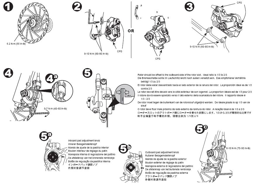

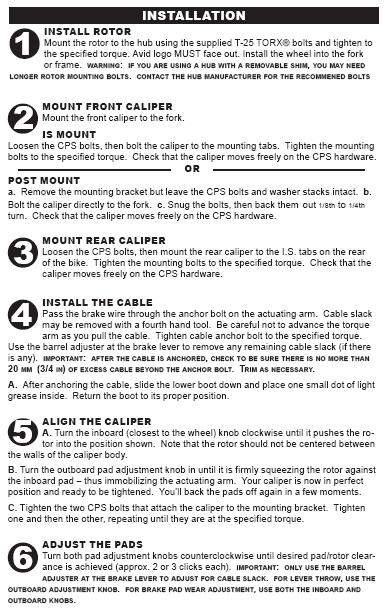

These may help a little
post-24247-0-06375500-1342285578_thumb.j post-24247-0-71593400-1342285583_thumb.j
