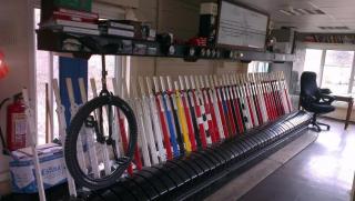

Here's my new ride, arrived this morning so I got it built up straight away and had a quick go. First thoughts are it's very different to riding a trials uni, for a start mounting it is a task as it's bloody huge but I'm gonna get some practice in at work this weekend so I should be good to go by Monday. Gonna keep it how it is for the time being till I've put some miles down then when I've got my confidence back I'll change the tyre for something a bit more road friendly, change the cranks for some Kris Holms with dual holes so I can change the crank length for road and muni riding and probably stick a disc brake or magura on.

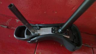

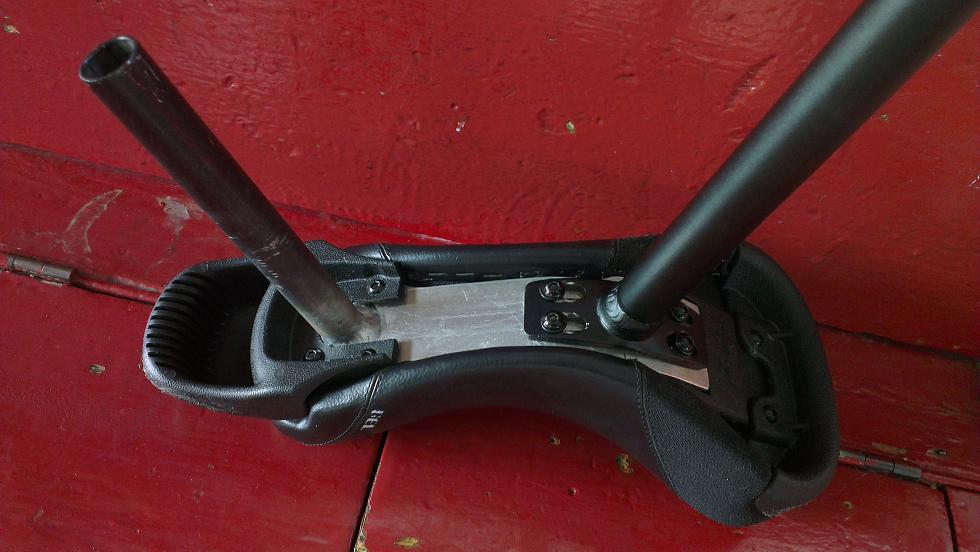

Been trying to sort a brake out on my muni for a while now. Was gonna go down the disc route originally but the price of disc compatible cranks or a hub is pretty much out my league currently so with the frame having magura mounts I thought I'd stick a cheap rim brake on for the time being!
The first dillemma with this though is where to mount the lever, you can buy mounts off the shelf but as I'm a cheapskate I made one up from a piece of aluminium plate and a set of old flat bars sourced on here for about a fiver(?). I made up a rather sketchy template to bolt the plate between the saddle and seatpost like the proper ones but mine has a bar extending down from it. This way I can have 2 bar end attachments, one short one to mount my lever to for use with the saddles original plastic grab handle or a longer one extending in front of the saddle for a bit more control and comfort should I go off road.
Here's some pics of it currently, gonna go and scour eBay next for a bargain pair of bar ends!
