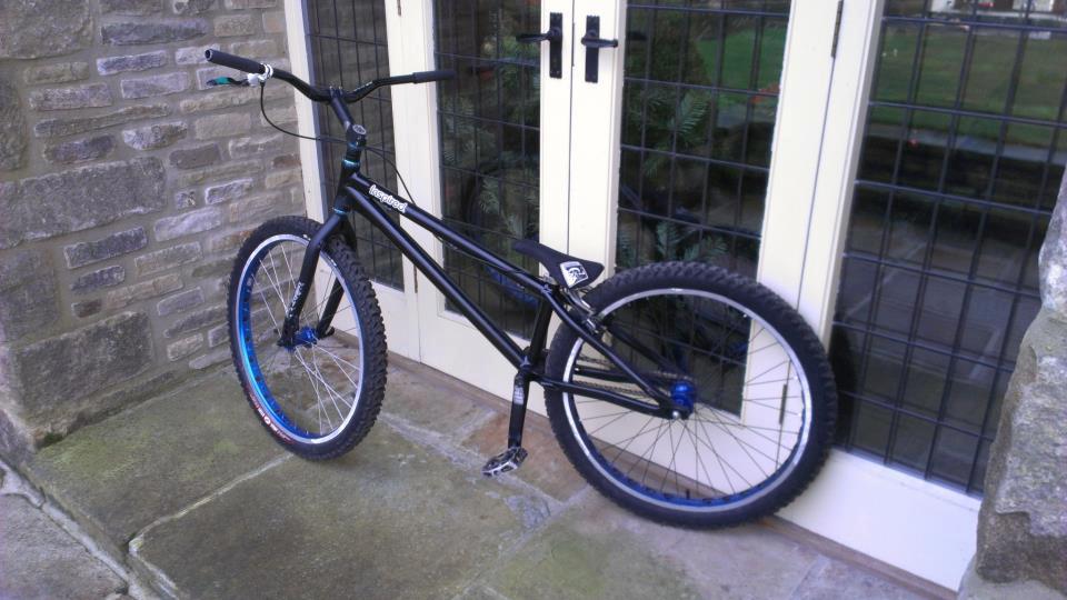

Mark W Posted August 3, 2014 Report Share Posted August 3, 2014 Ali had a compy Hex built up at one point - FFW, High Roller 2.5" rear tyre with a Try-All Stiky 2.0" up front, grind on the rear with LGMs and a BB7 up front. Rode pretty nicely for trialsy stuff. That was 'just' with a 90x25 stem on it with the bars rolled a little further forward than normal, but coming from the front end I was used to it still felt quite a bit longer and more trials-orientated. I borrowed it to ride natural a few times and it was enjoyable for that, but was still decent for bunnyhops and other streety stuff. It looks like TRA's running something along the lines of the Trialtech Sport Forged High Rise stem on that (130x25?) build? Quote Link to comment Share on other sites More sharing options...

Paperclip Posted August 3, 2014 Report Share Posted August 3, 2014 (edited) Rockman 125x27 stem - Trialtech bars. 18/15 gearing, slightly filed out the dropout so I could run the gear ratio without a tensioner, I also used the mec hanger hole in the frame to put a nut and bolt through so I could run a drive side snail cam to tension my chain (worked out really well) it also makes your rear end 5mm shorter which helps for bunnyhops EDIT: I also used a rear maxxis larsen TT tyre that I still have here at home if you want it. EDIT 2: You would be able to get away with a echo TR rim but anything thicker than a 44mm rim you would struggle to get a decent brake set up because of the spacing. Edited August 3, 2014 by Seabasss 1 Quote Link to comment Share on other sites More sharing options...
