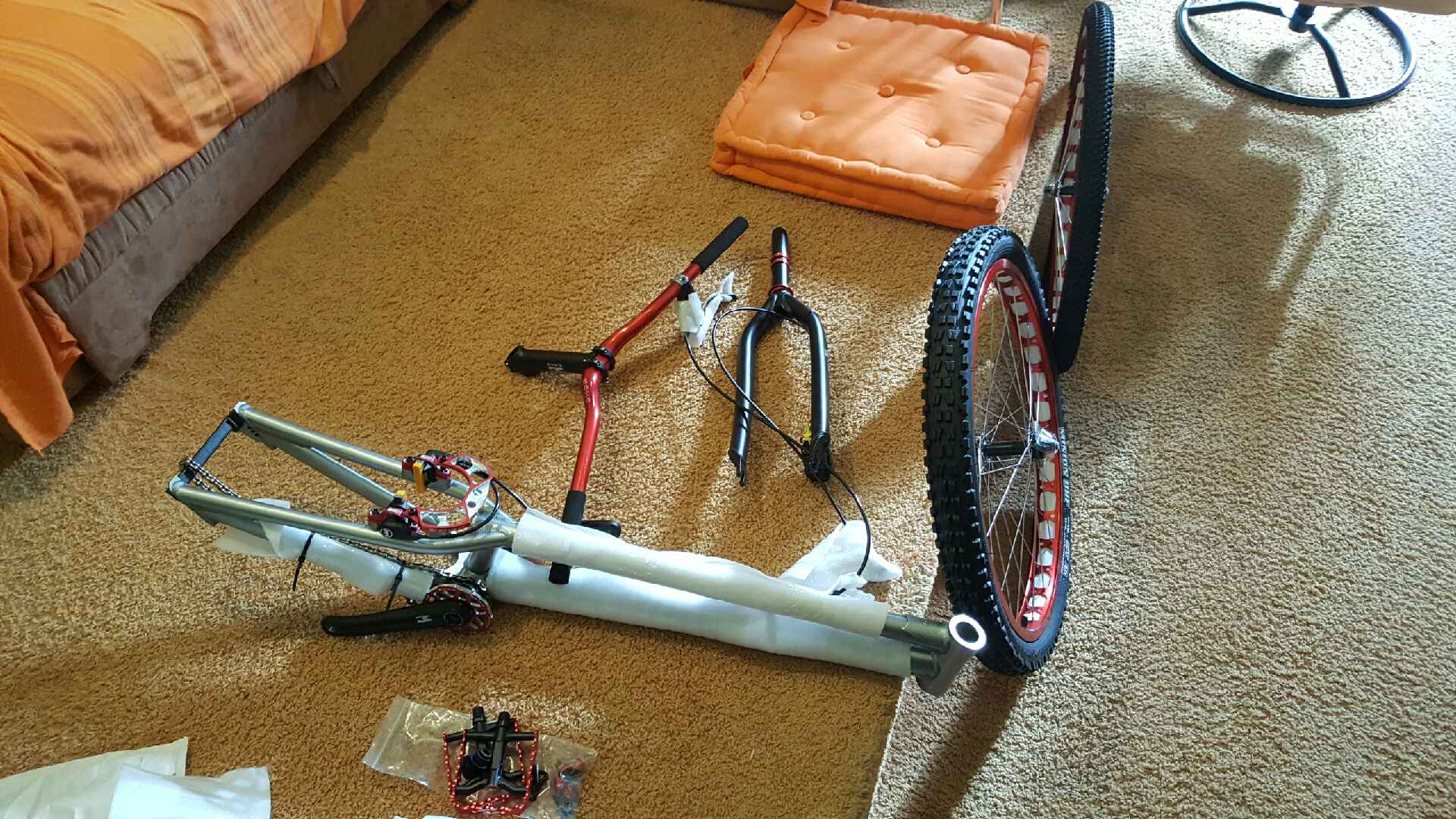

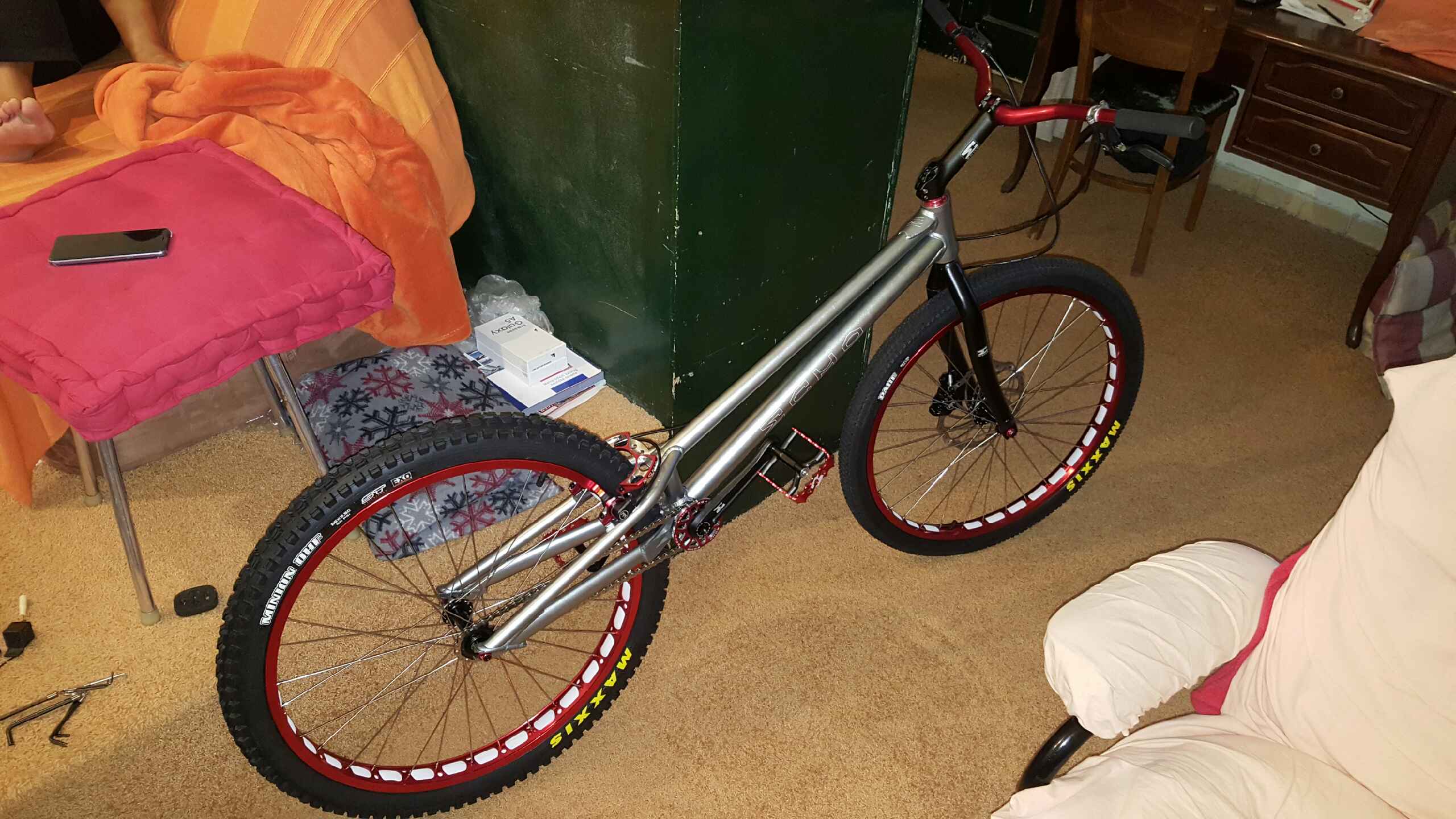

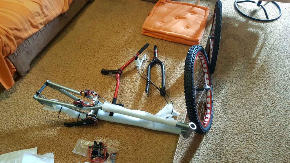

Today my bike arrived. After I assembled it I went for a first ride. It was very weerd. Feeling was that I was to high on my bike and unstable. In the begining I couldn't trackstand longer than on my Kona Kahuna 29er. At first it felt like it was to long. Like I wanted a shorter stem and lot of my weight was in front, above the bar or front wheel. After a while I got used to it and it was better and easier but first few minutes was a shock, compared to a XC bike. Still feel that bunnyhop is not an option for now.I have a lot of practising to do :)
  • Like 1
High BB and a long stem put your weight much more horizontal and further forward than on a MTB, so the differences you've mentioned are all pretty normal. That bike will feel much better on the rear wheel than your Kona, but bunnyhops will likely be harder (they usually are on a "pure" trials bike, though this isn't the case on a "street" bike) (Y)

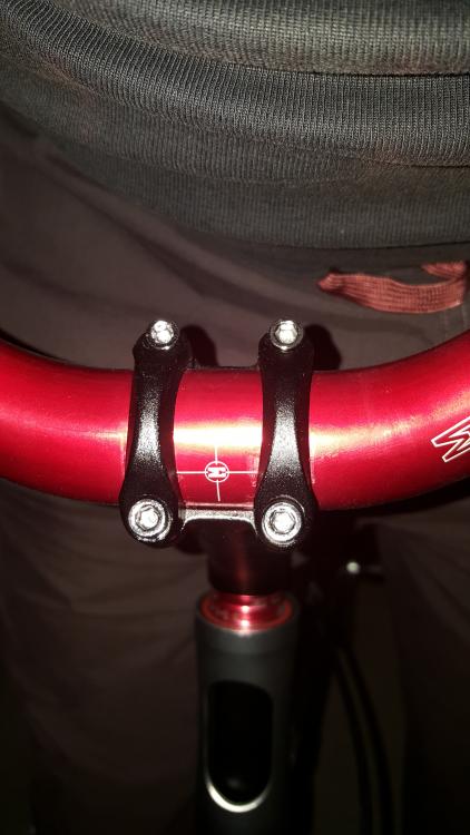

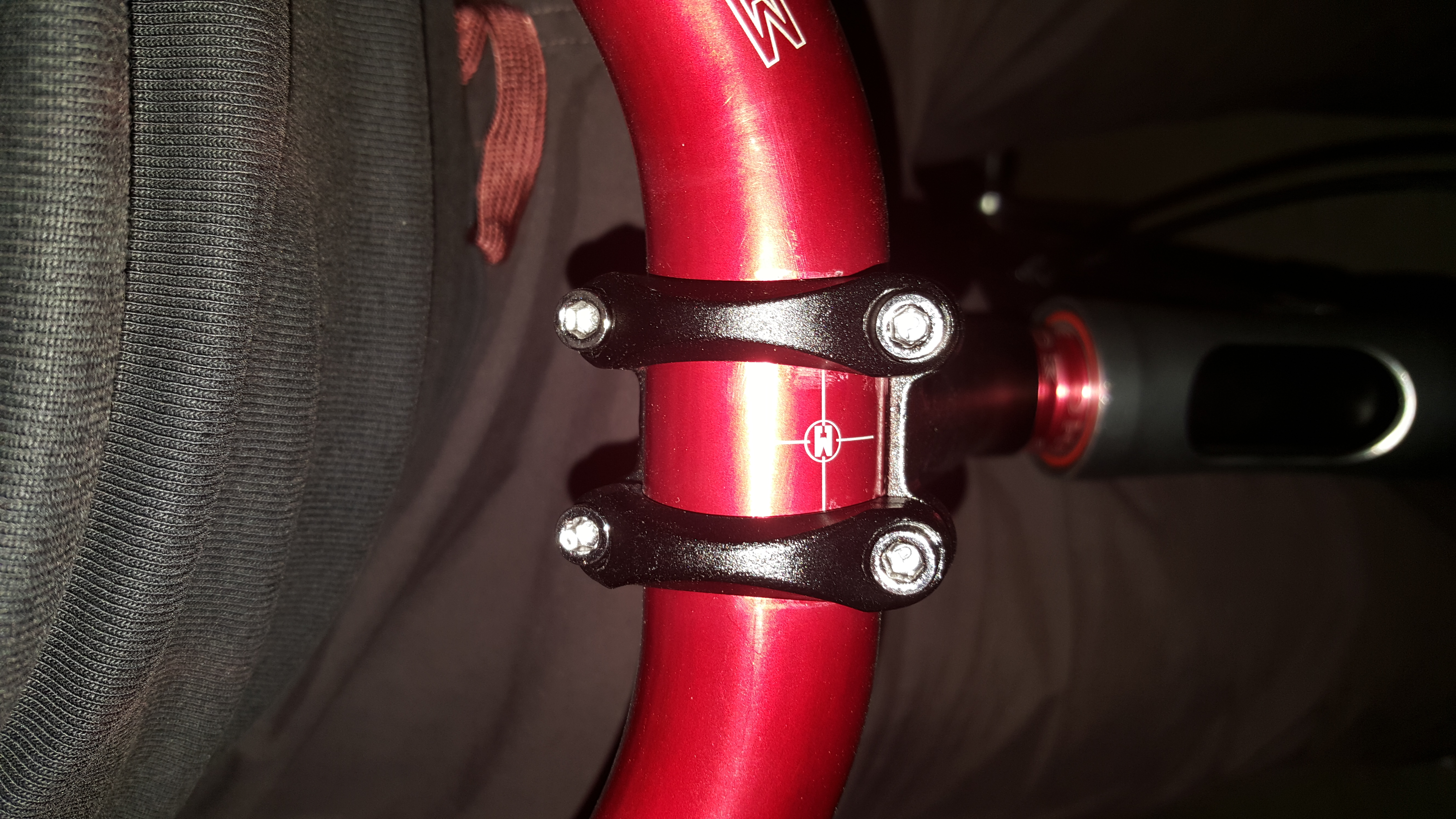

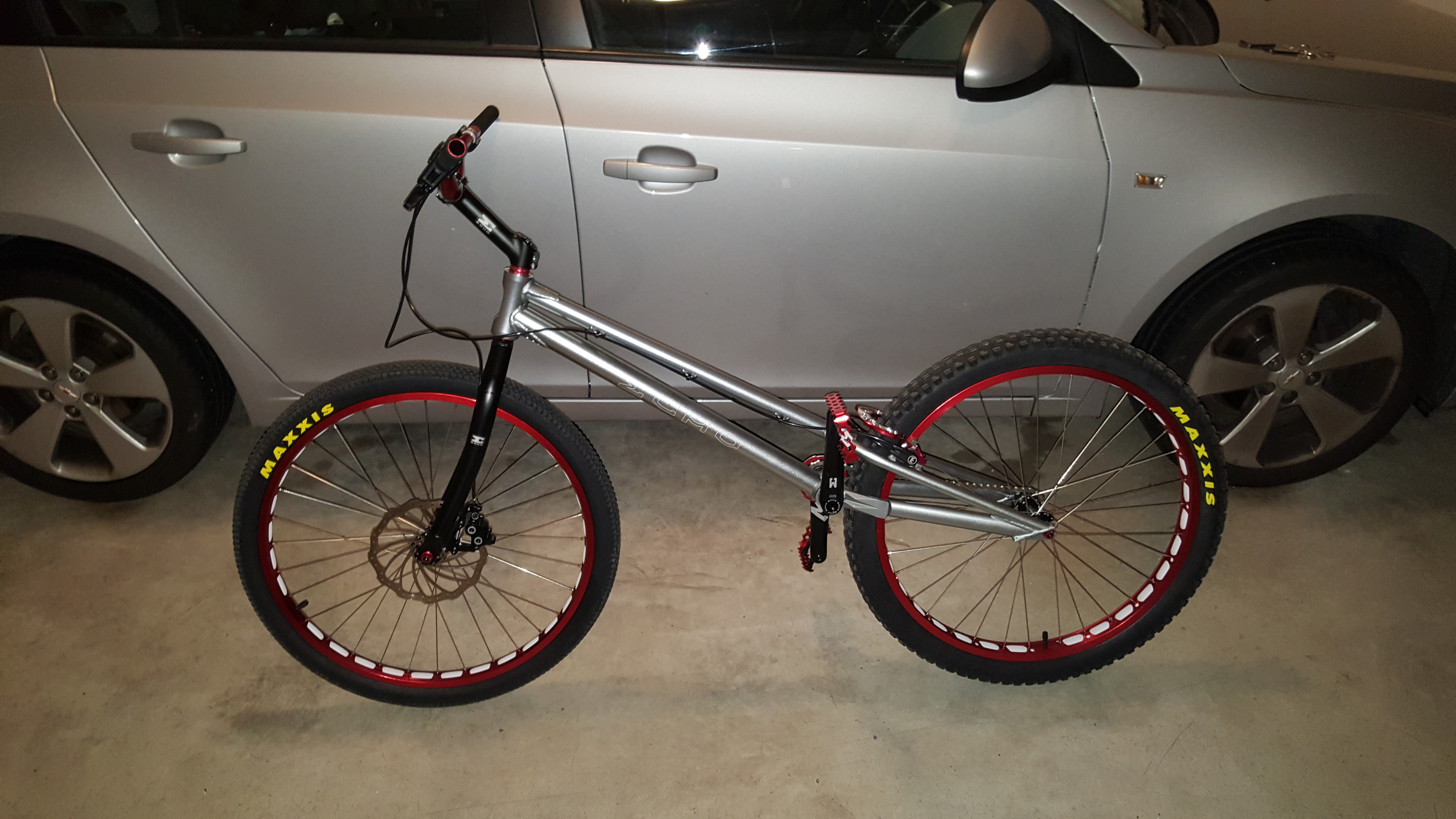

Main thing that bothers me is stem lenght and handlebar angle. In the begining handlebars were racked way forward and lot's of my weight was over front axle. In that position it was difficult to trackstand. Lifting front wheel up was no option. Then I racked handlebar back. That moved my position 2-3 cm back and it was more comfortable and easier to lift front wheel up. Is that handlebar correction okay or I need to get used to handlebars racked forward because that position is needed for advanced moves later?
Below is the pic of handlebar position inside the stem and bike from the side. Originaly horizontal line was in line with the lower part of opening on the stem(between lower bolts) (in the pic is in the middle)

you can ride bars back if you like, but you can also ride bars forward and it is much easier on the rear wheel, so most people ride with their bars very far forward.
The thing is lots of people don't realise how different these are to normal bikes. Basically don't put any weight on your hands at all, when you ride put 90% on your weight on your legs. You can ride weight forward but there is a limit to what your hands will take. Look at the body position at 0.03 in this video, practice that position on two wheels and just on the rear wheel, and get comfortable in it because it makes up like 50% of the moves, notice that he is doing a trackstand, and this is a better type of trackstand for pure trials in my opinion because your weight is ready to produce power.

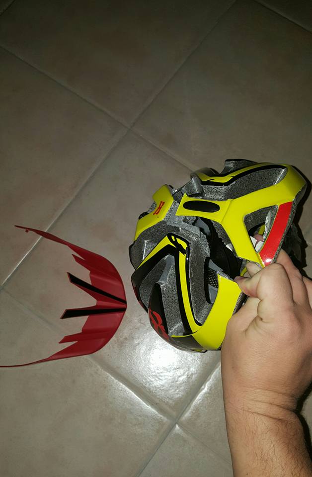

Hi, after 2 months I learned to trackstand good, can do few hops on front wheel, 7-10 hops on rear wheel. From day one I felt every ride was improvement and that keept me going until my rear sliped and I fell from about meter and a half directly to my tailbone and than ,secondary, hit hard with my backhead right on the concreete. Helmet broken, tailbone hurted hard, for about 10 minutes so hard that I was just  laying on the floor and waited for the pain to go away. Ditn't go to doctors, dont know if it is broken or not. Hurts when I am running or riding the bike. Dont hurt when walking, sitting, drive or sleeping so I think it will be okay, I hope.
My motivation is down for now. I'am not sure if I could survive another tailbone impact again. Looked for some protectors but nothing seems good to me. So for now I paused everything untill I start to feel brave again.
Ouch! Reconsider seeing a doctor, just to make sure nothing is broken. And the doctor can advise on recovery time, and what to avoid during recovery.
Can you describe how the rear wheel slipped? I've only been on a trials bike 2 weeks. I'm quite a bit older than you, so my top priority is avoiding injury.
