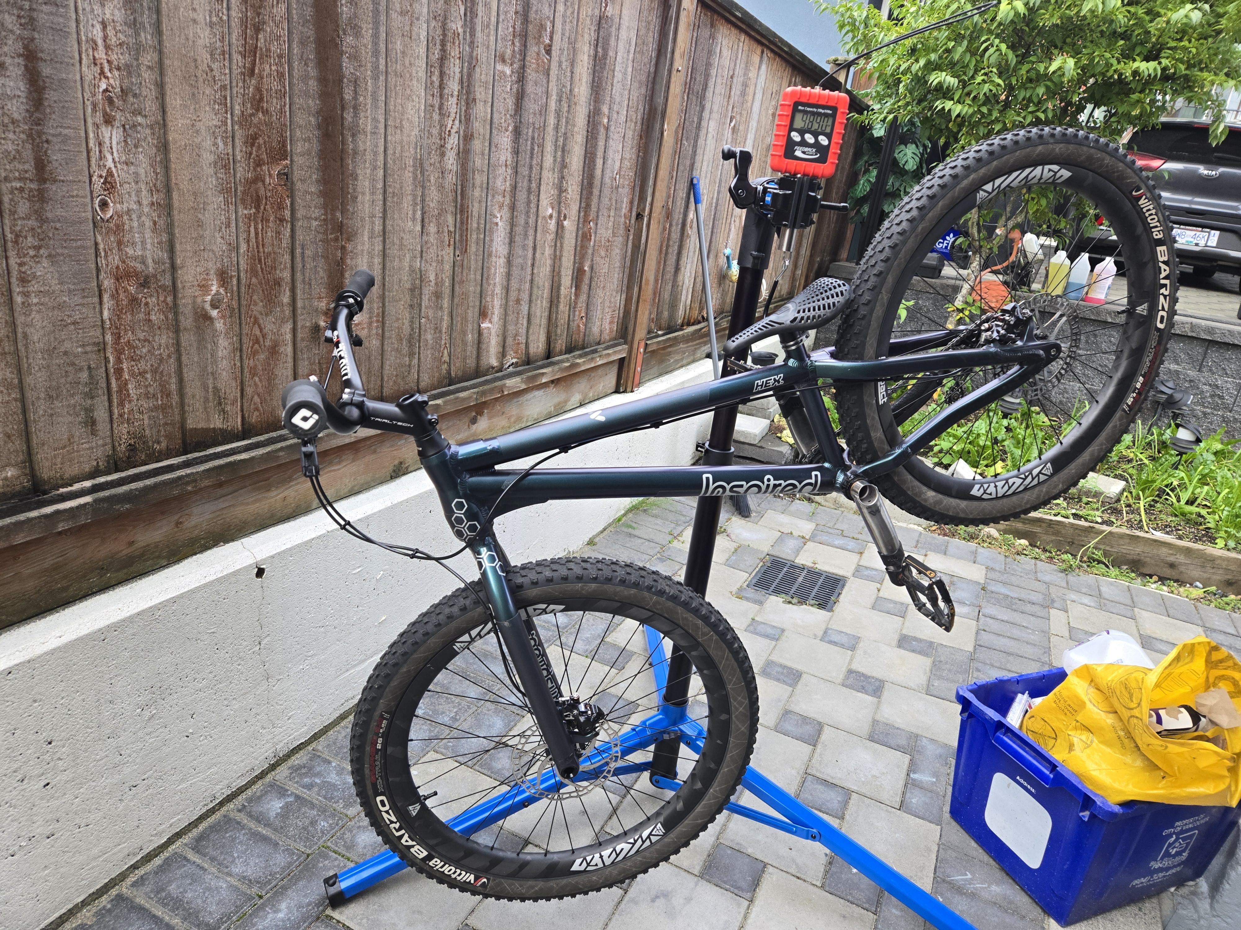

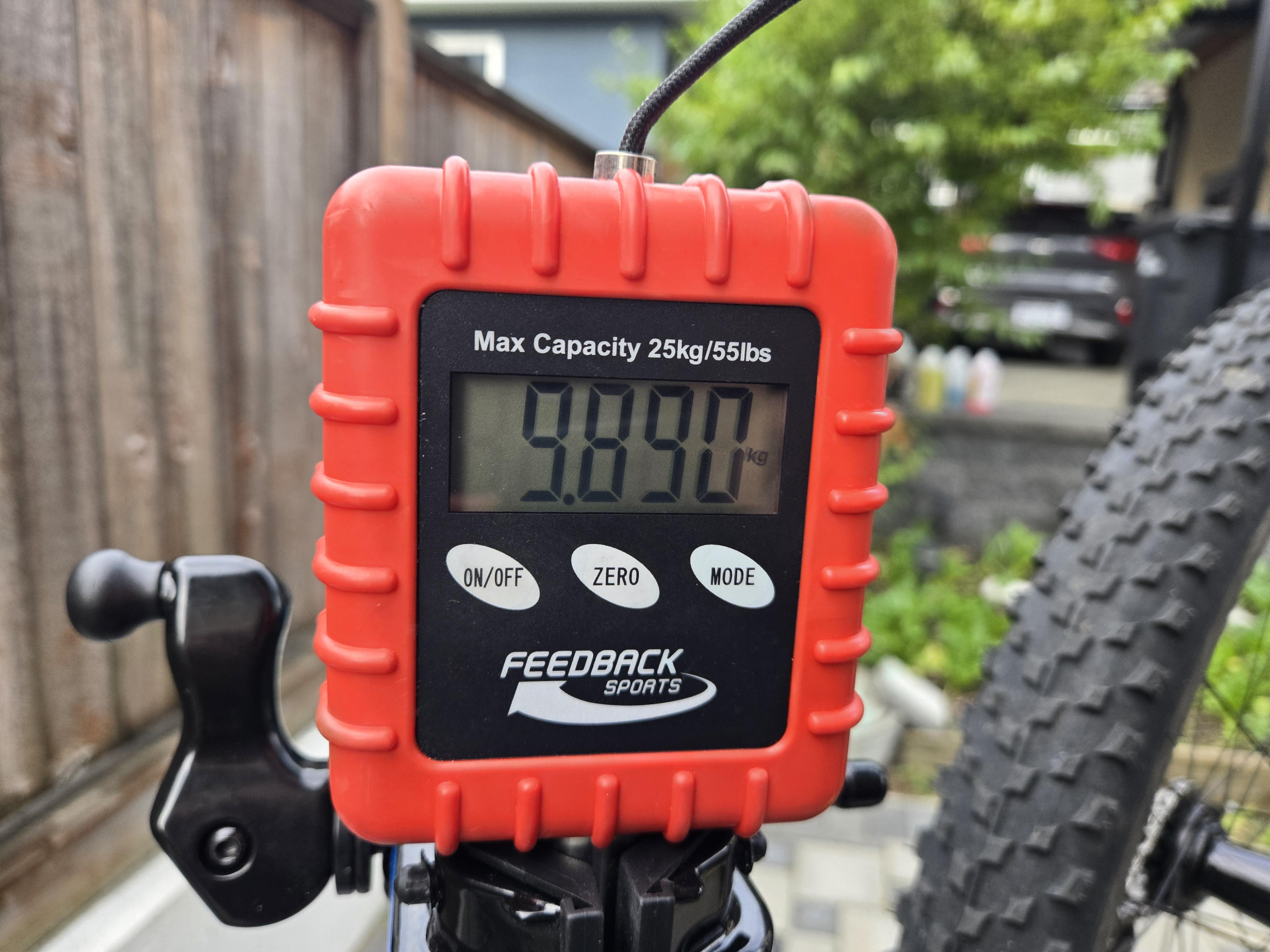

I have no idea how mine weighs barely below 9.9kg and yours is 9.3kg.
My Barzo tires weigh in at 700 grams each and your Billy Bonkers weight ~580 grams each (per Tarty). That only makes a difference for ~240 grams for both tires. I have a Rimpact insert that weighs 90 grams, so all together i should have ~350 grams more in the wheels. You have your custom tensioner whereas mine is a stock Inspired one. But I doubt the weight difference would be that much.

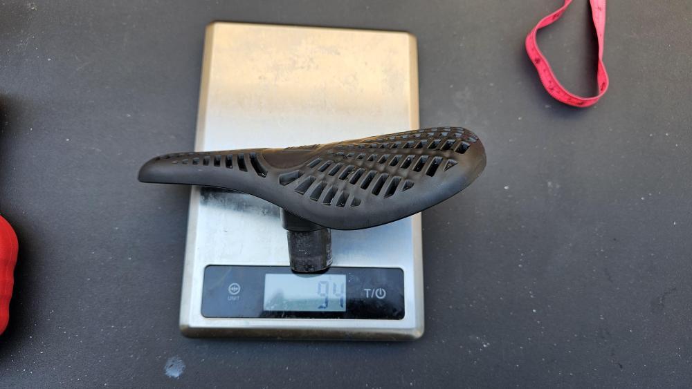

But I have Canecreek Eewing cranks, Stamp 11 Ti pedals, E6 BMX one piece seat with shaved off post (weighs 94 grams), and 7 inch rotors instead of 8 inch rotors on your Hex.

Everything is titanium except for brake bolts (by choice, for extra peace of mind).
So with a pretty much maxed out Hex build, I am still barely below 10kg, which is pretty impressive but still heavier than what others are posting.

As this as struck up quite the debate I can weigh the new blue setup. It’s had a couple changes so let me weigh it with some digital scales and post a picture of current set up! :)
so since the orange bike I have changed the tyres to maxxis, pedals to hope, brakes to Hope, normal tensioner back on (waiting on a new 3D print for mine), longer stem and deity handlebars so it will be closer to 10kg I imagine now
