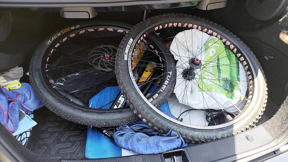

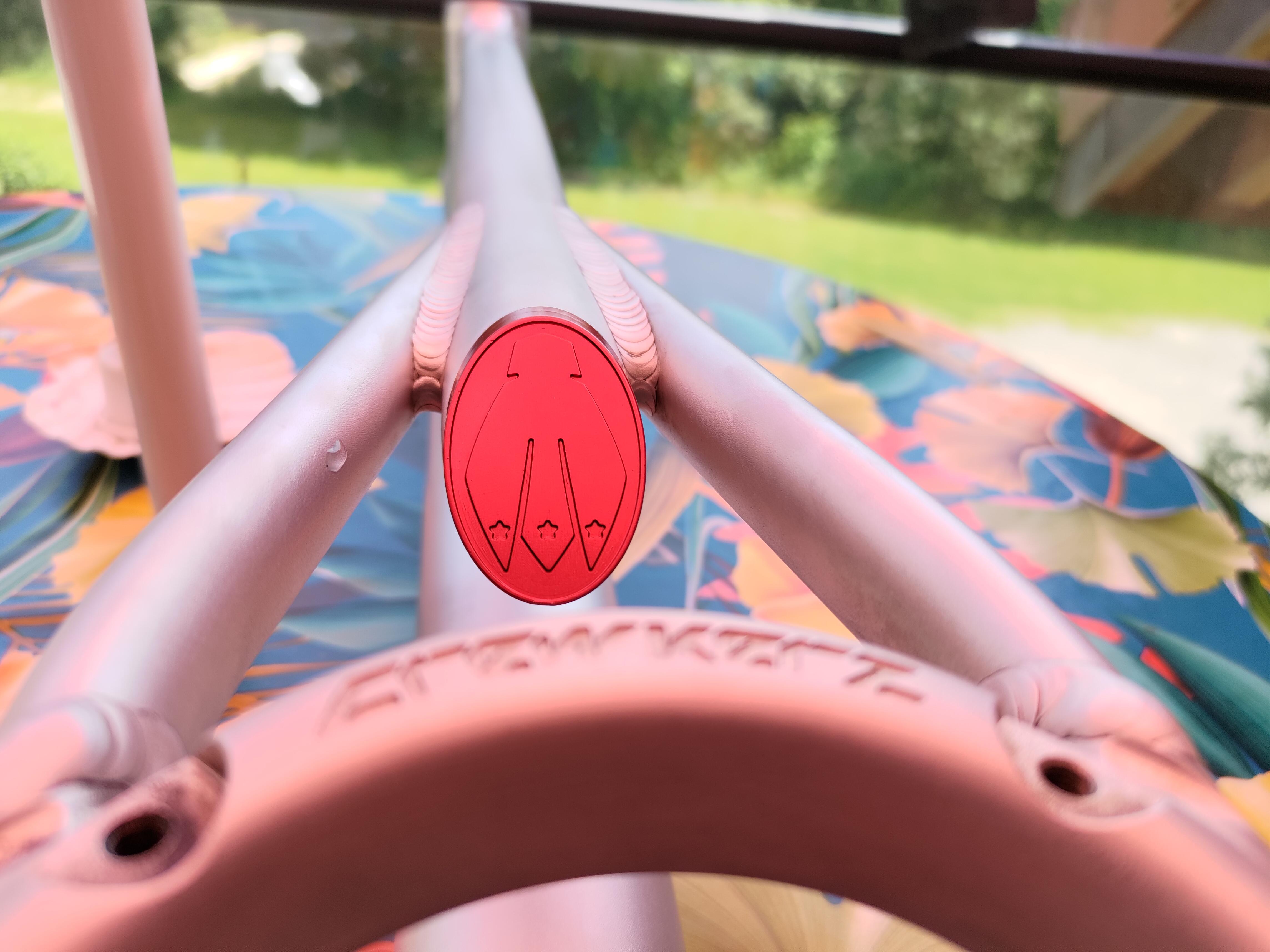

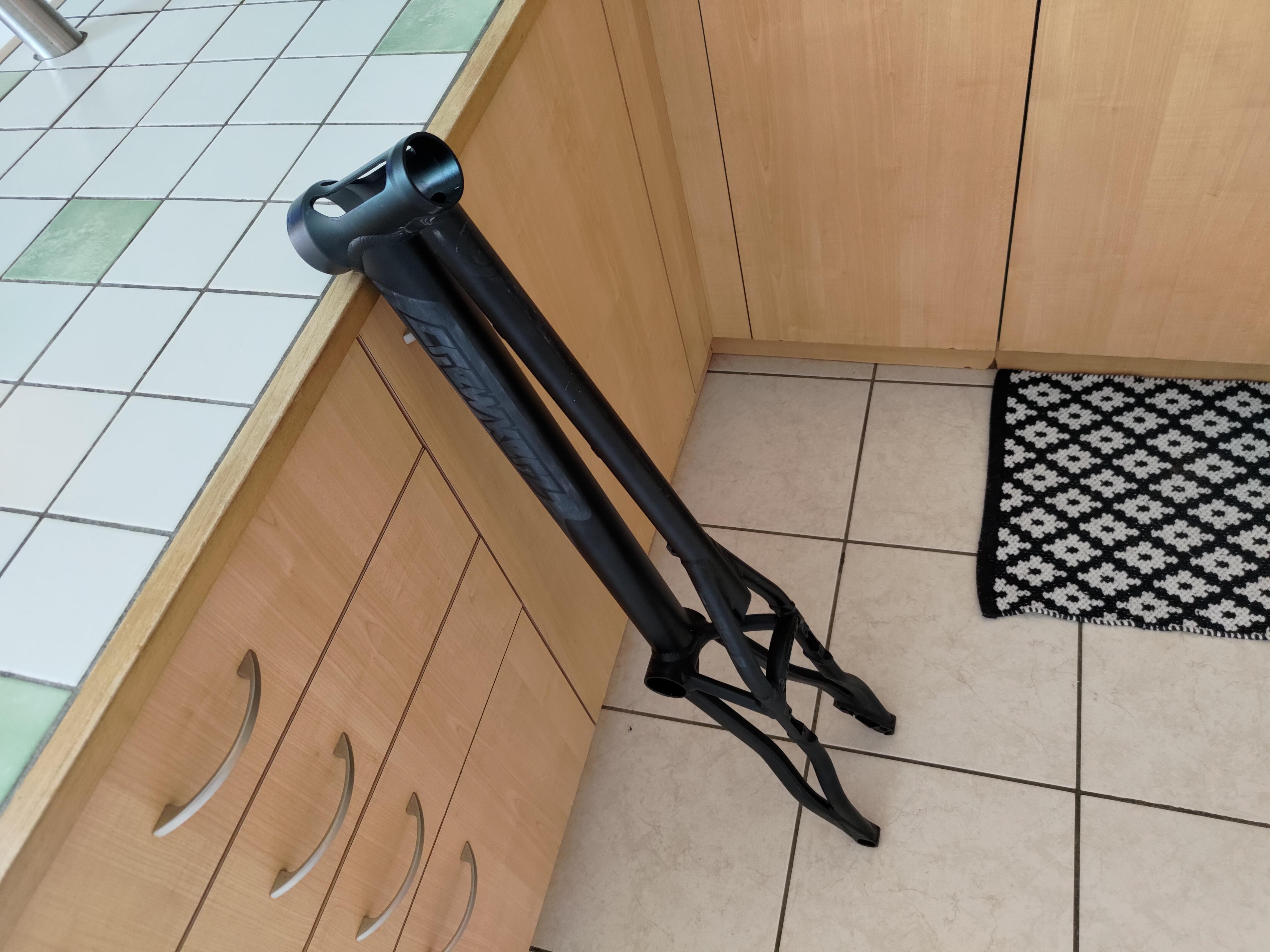

Long time since I last started a topic here. I stopped riding last year and sold all the trials bikes I had with all the parts. But I miss it so I had to build a bike and ride again. This one is a bit special and I have a few projects for it so here is the first picture after driving 3 hours to get it. The thing is basically brand new as it was a spare one for a demo rider here that some kid bought and practically never rode.
I will keep this topic updated on the progress of the build. I don't know if that's of any interest to anyone but I feel sharing about it and just the overall process makes me some good so here I am.

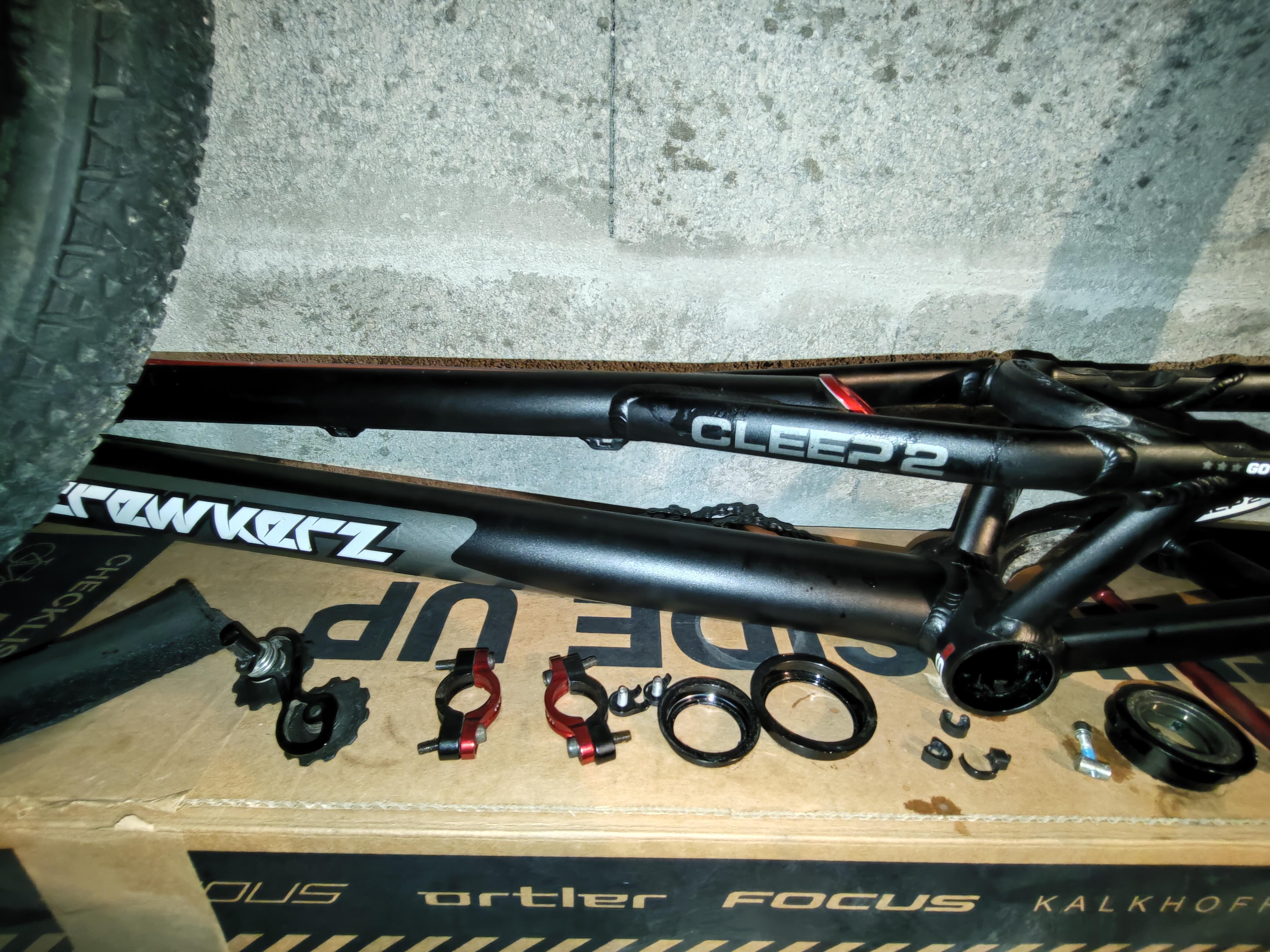

I am almost offended to read that I ride an old school bike! 😂
Was also expecting a +30mm bottom bracket, not +65mm!
The geometry of the Cleep2 (and Cleep) is still on point to me.
What part do you plan to swap?
I noticed a front disc setup and an original Magura HS33 lever...
  • Haha 1
10 hours ago, aener said:
People are getting some pretty worrying definitions of old-school, these days :lol:
Came in here expecting a V-Racing or something!
Yeah I expected that reaction. That's why I added the kind of mention. Sorry if that was misleading. It's just that things go so fast now that I thought this frame was going to be old school for the comp riders. It isn't for me though. I hope you will enjoy the thread still. I have changed the title for something more clear.
Sorry again if you had some better expectations for a real old school frame. That frame is from 2014 and seeing how things move so fast nowadays, I thought it wasn't recent enough to be interesting for most. I have changed the title so people don't get their hopes high.
The BB is +60 on these. I have been riding 20" for the last 8 years. Then stopped riding for a year. So I guess this geo is perfect to get back to 26". I couldn't ride anything else than a Crewkerz also as this is a brand that always helped me and made me change the angry and bad attitude I had years ago when I thought I was someone else.
The parts you see are from the original build. None of them will be used. The plan is a fairly "standard" build but with high end parts. That means HS33 front and rear, Crewkerz parts only except for the rims and levers. I also plan on making to the frame what I have always done to all my bikes...
Started pulling it apart!
Can you guess what I am about to do to the frame?
Edited by Canardweb
  • Canardweb changed the title to Not so recent comp bike

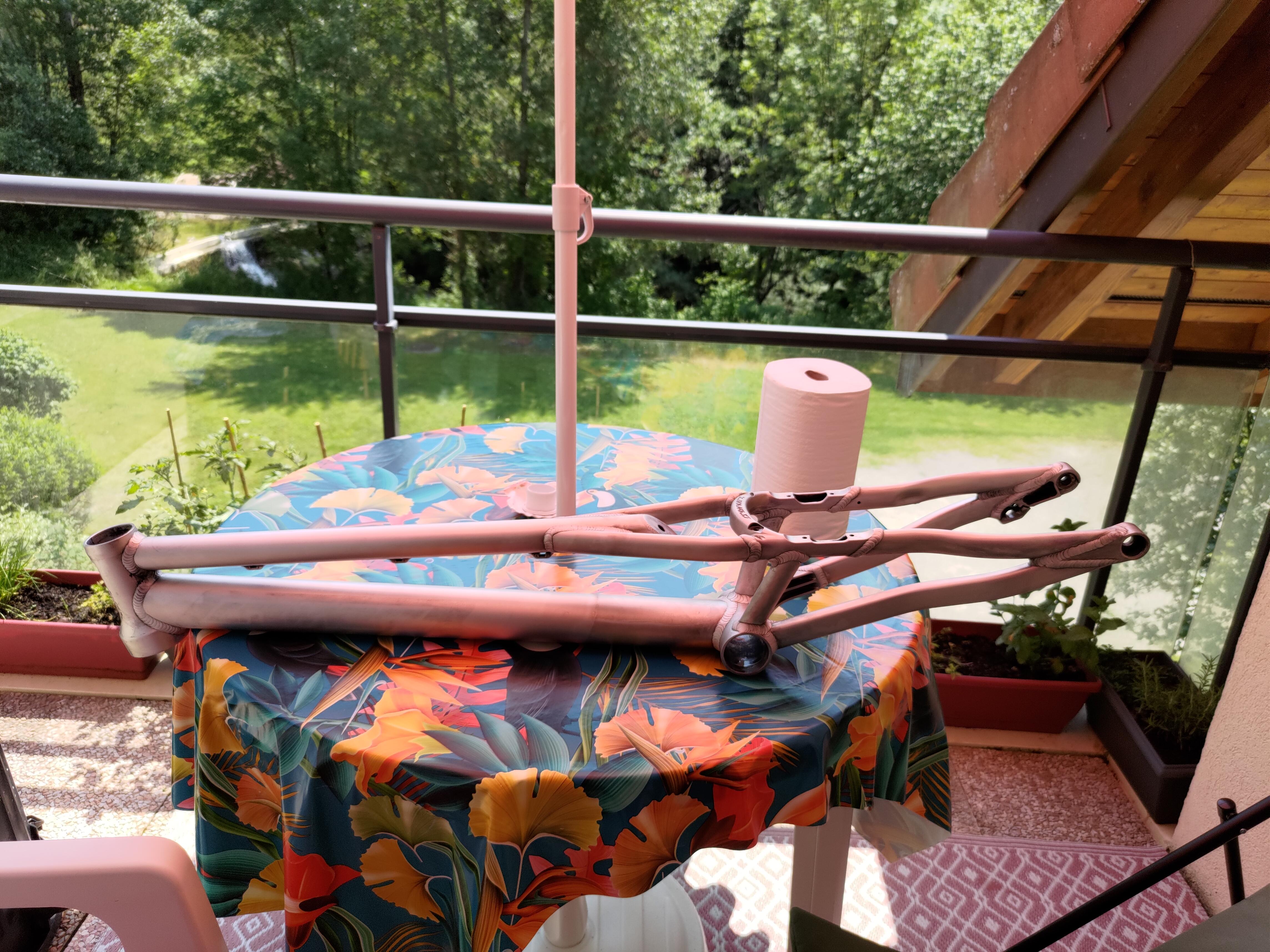

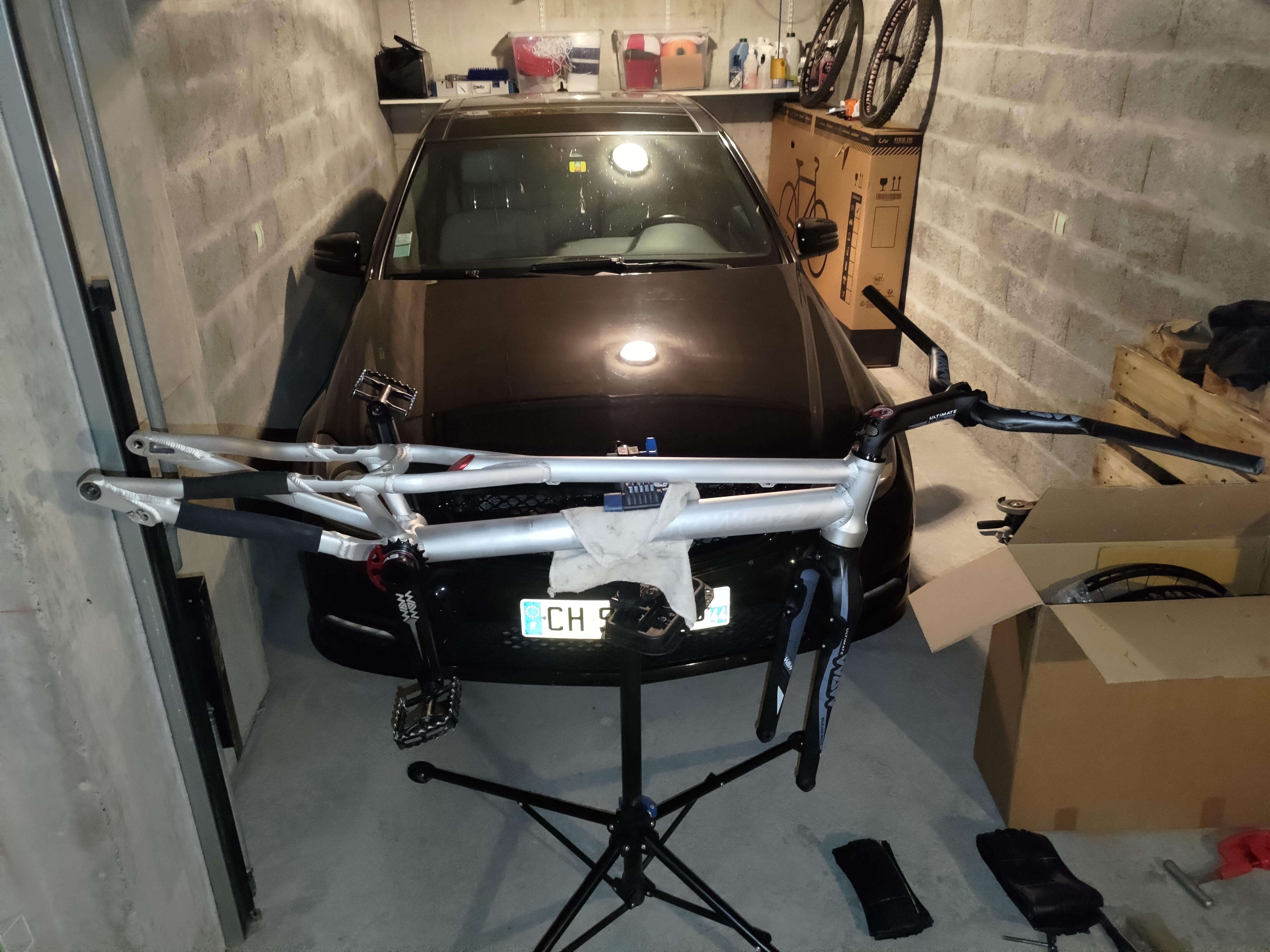

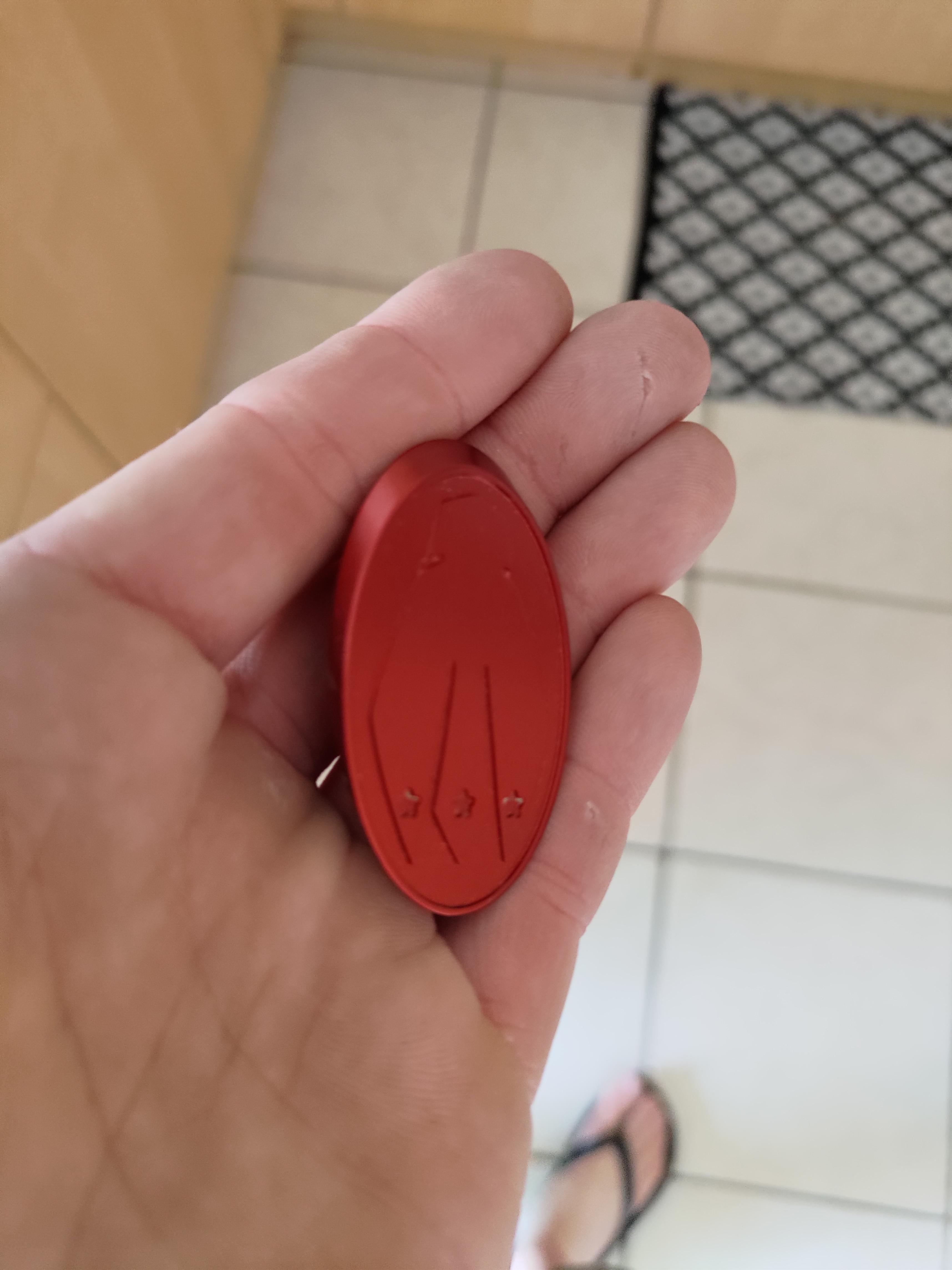

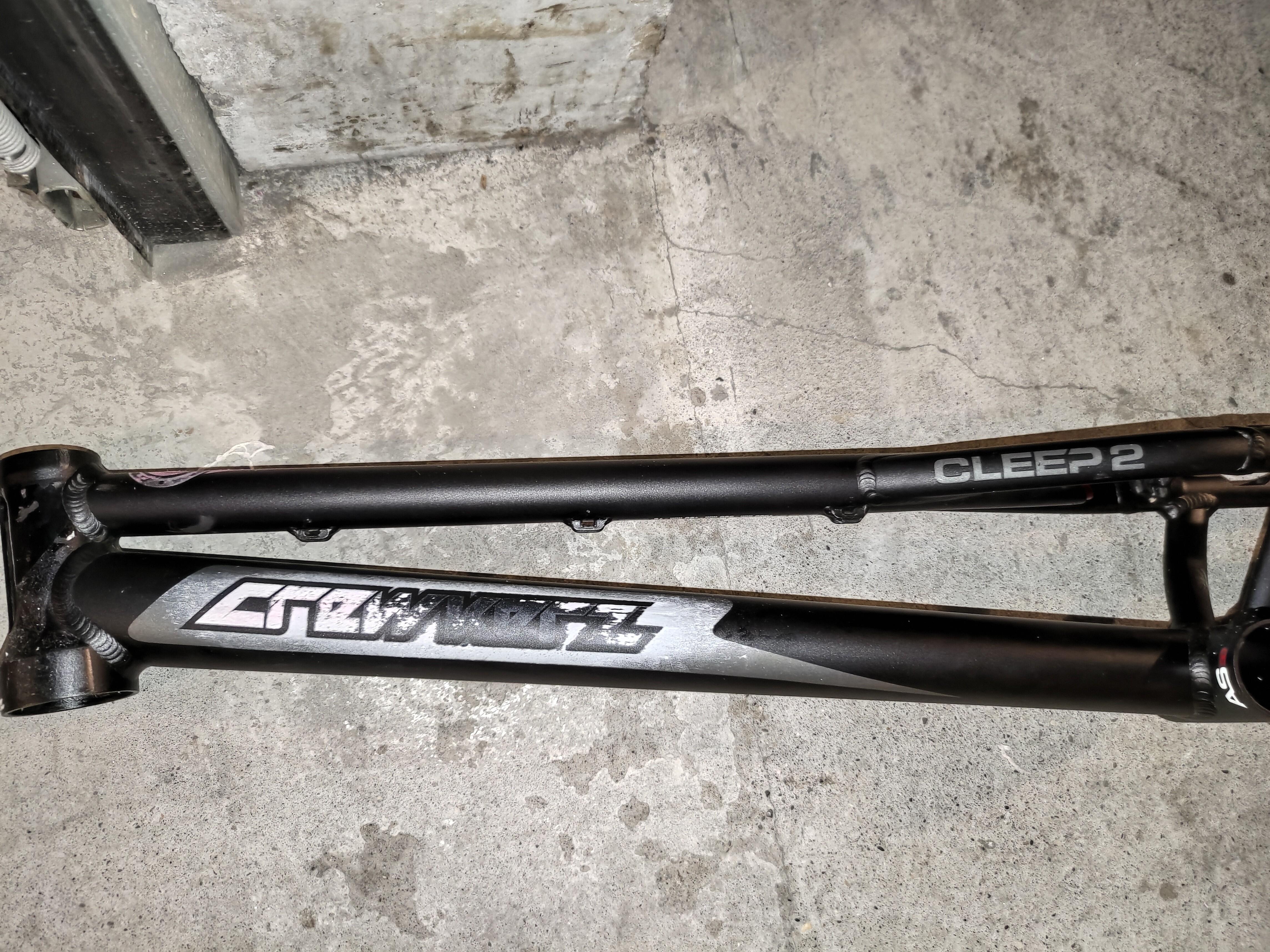

Well some may have guessed it. I am rawing the frame! I removed that little bit that's on the "tail" of the frame as I want to put it back on afterwards.
First, I removed the decals on the frame:

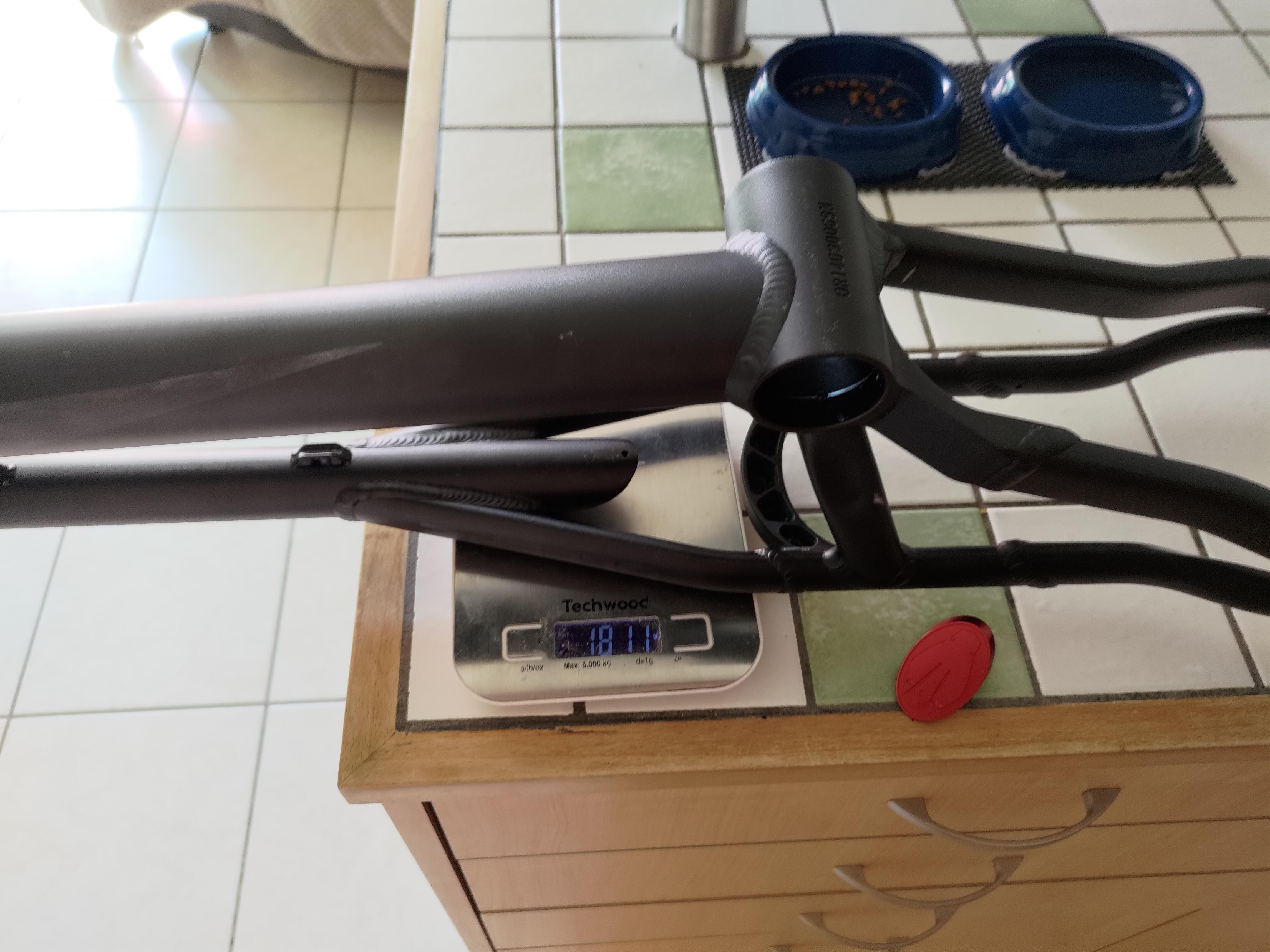

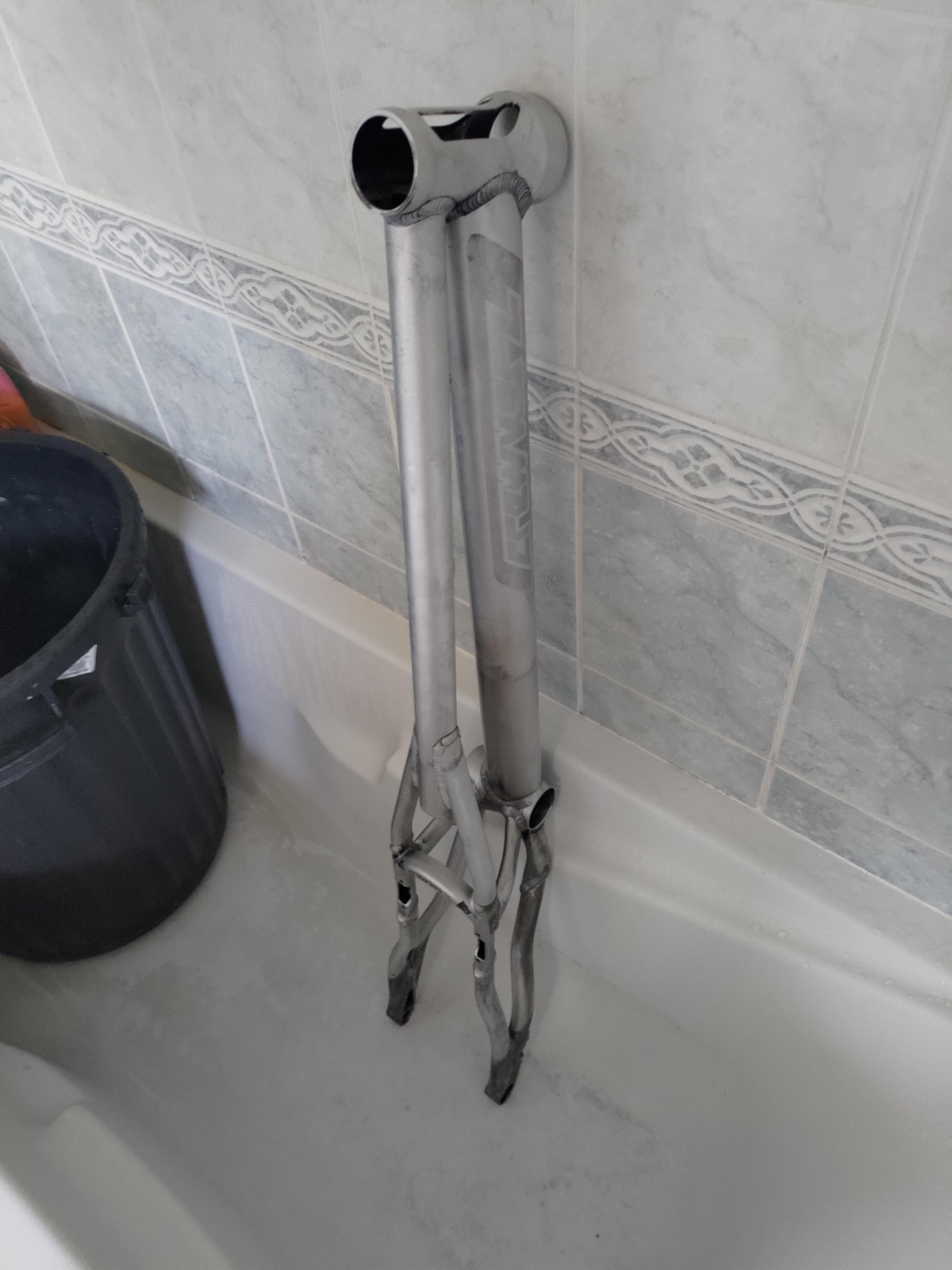

And I thought of weighing it to compare before and after removing the anodizing.

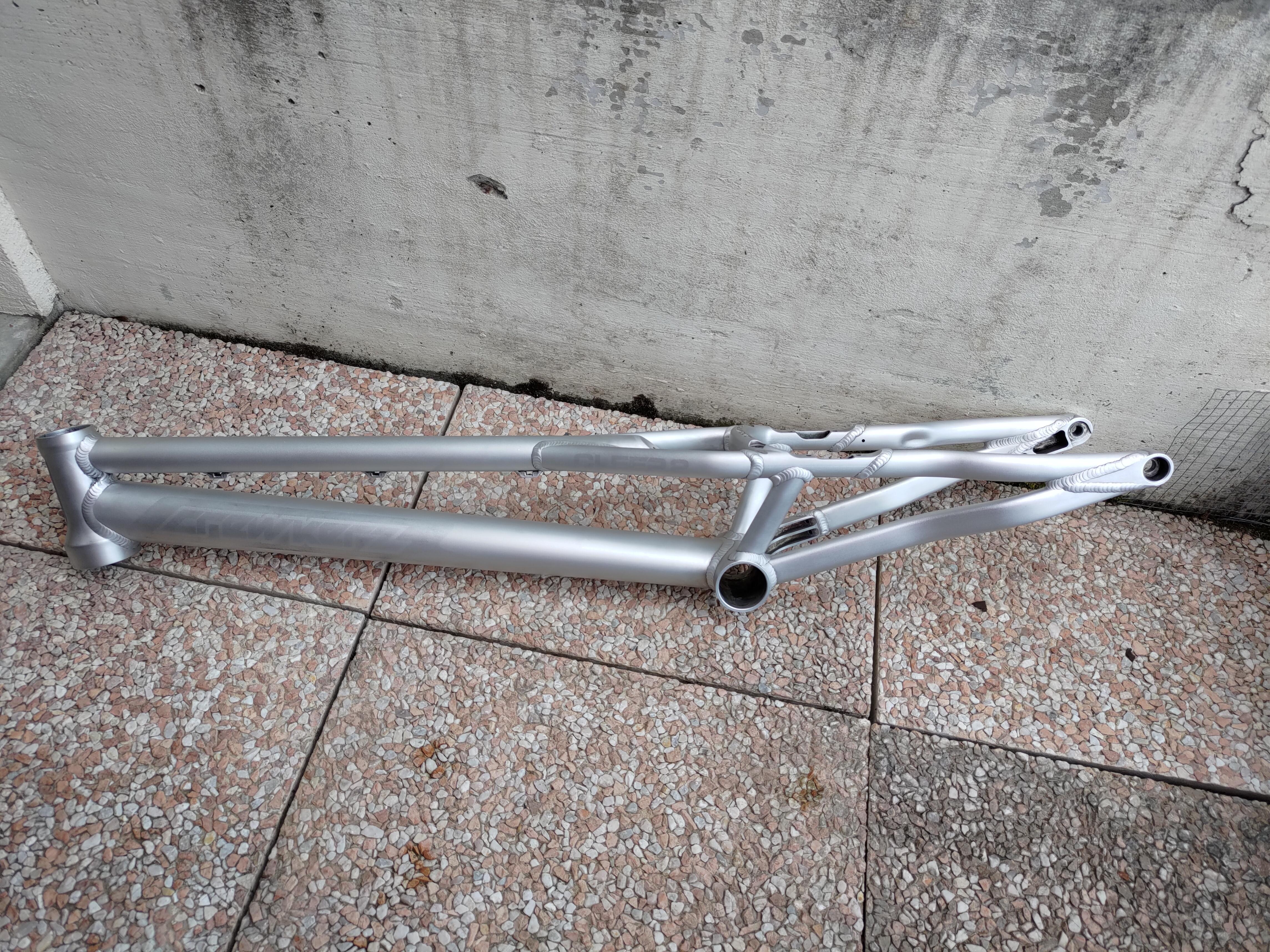

After the first bath:
And after the second:

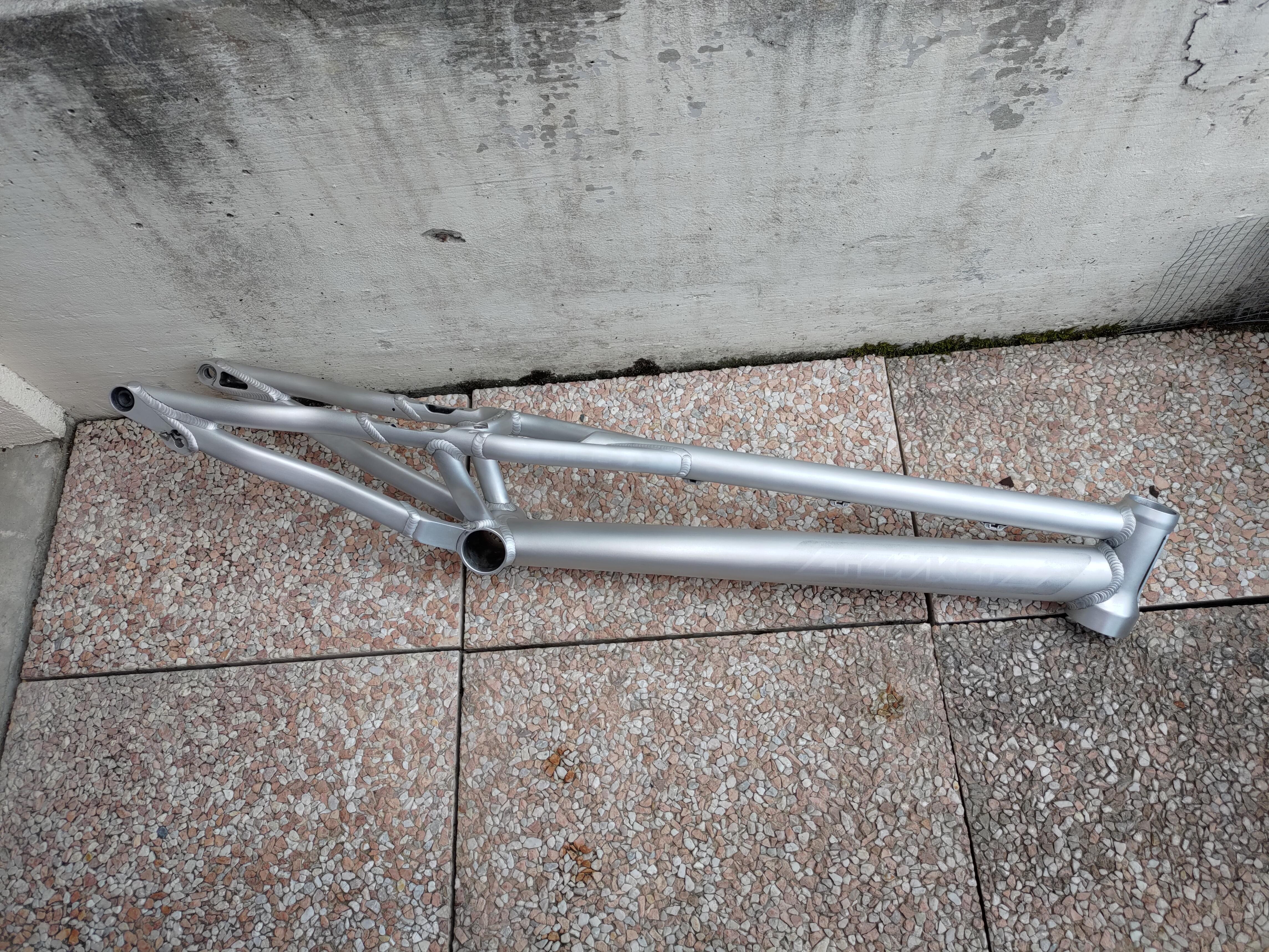

Now I am brushing it by hand by 30 degrees Celsius. Gotta keep going!
There it is once it's completely brushed by hand:
I know we can still see the decals. That might be because of the sun or the decals not completely removed and the caustic soda not reacting with it. I can remove them but after talking about it with my wife I decided to keep it like that because it gives some kind of ghosty look to the logos and we kind of fancy it.

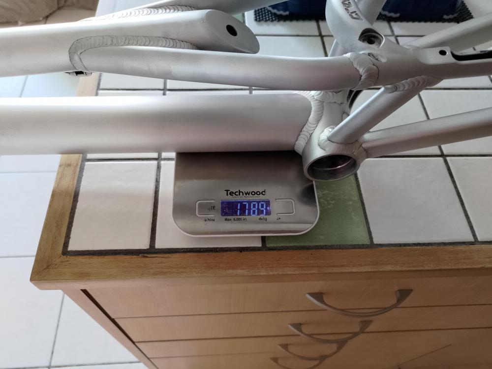

Saved a few grams also:

These are no decals but some kind of anodizing.

They are water transfers. I removed them with acetone. Sun must have affected them and the anodizing hence the remaining graphics. I really like it as it keeps showing it's a Crewkerz but I don't know if I should  leave them like that. What do you think? Is it weird looking? It's not hard work to remove them if I decide to but I need advice.
I removed the anodizing using caustic soda.

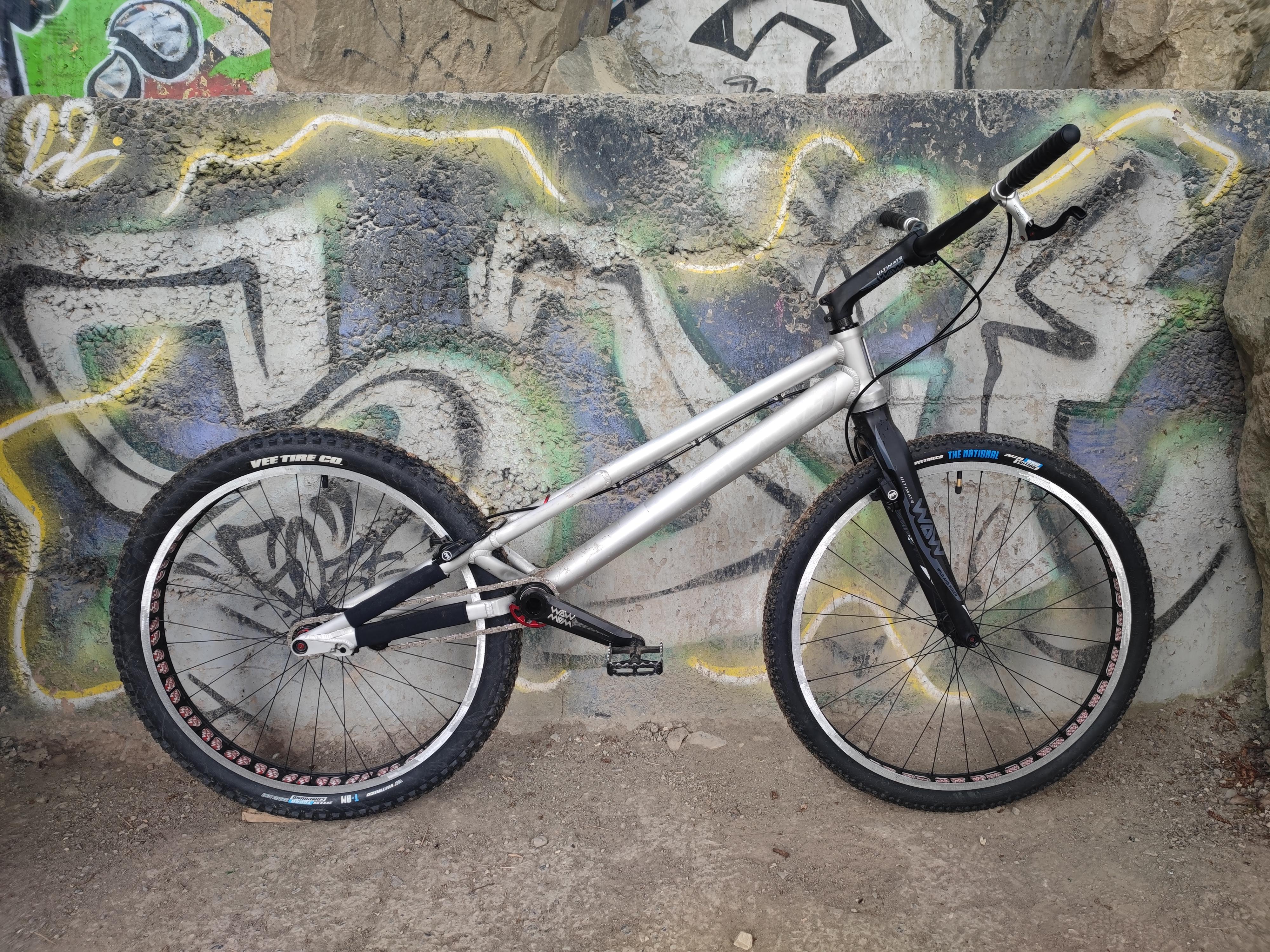

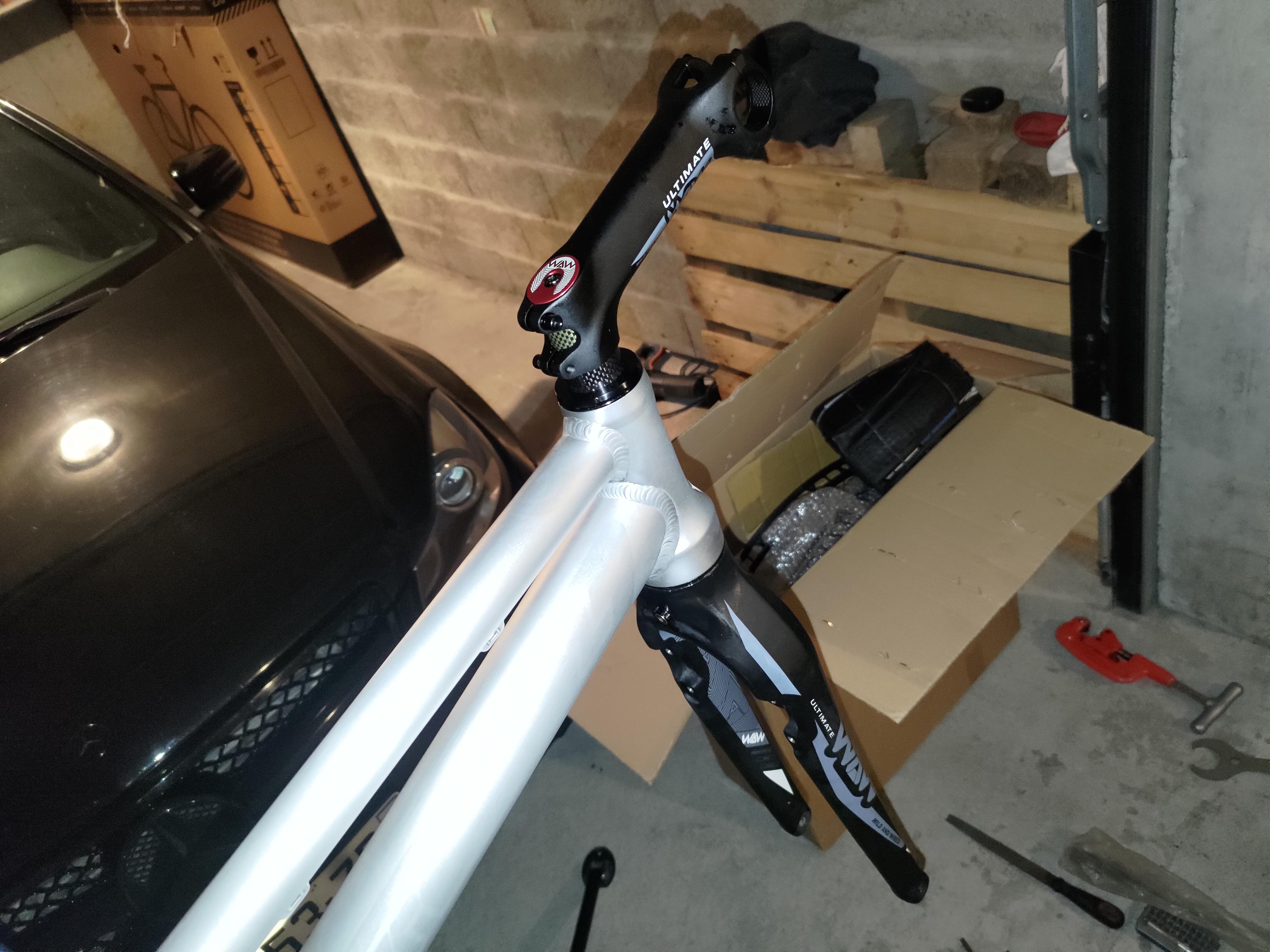

Things are taking shape. I still need to:
-tighten everything to the right torque,
-get a new chain,
-get some 8 mm pads for the rear as these 10 mm ones don't clear,
-set brakes, levers angle, stem angle and bar angle,
-apply some grip tape,
-clean the bike and ride it!
I didn't cut the steerer as I quite like high front ends and as I didn't need a lot of spacers under the stem. I will try that position and see how it suits me.
Edited by Canardweb
  • Like 1
Here is the final build picture. It was raining a lot so excuse the dirty bike. I may take more details of it once I have cleaned it.
Had my first ride on it and I feel terrible. I need to improve my control on the bike. Haven't ridden trials for a year and 26" for 8 years. Guess it's kind of like starting all over again, which I like.
