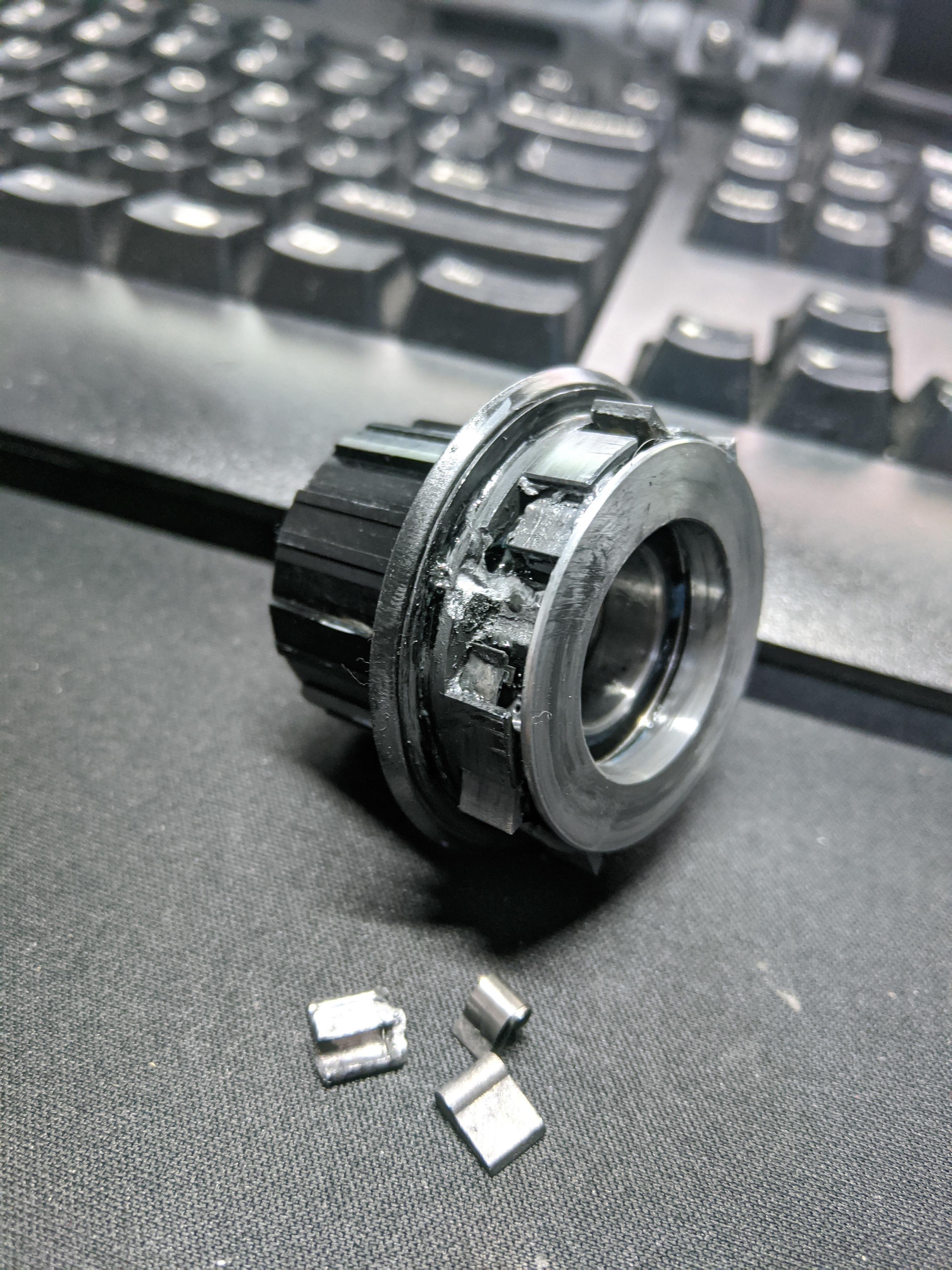

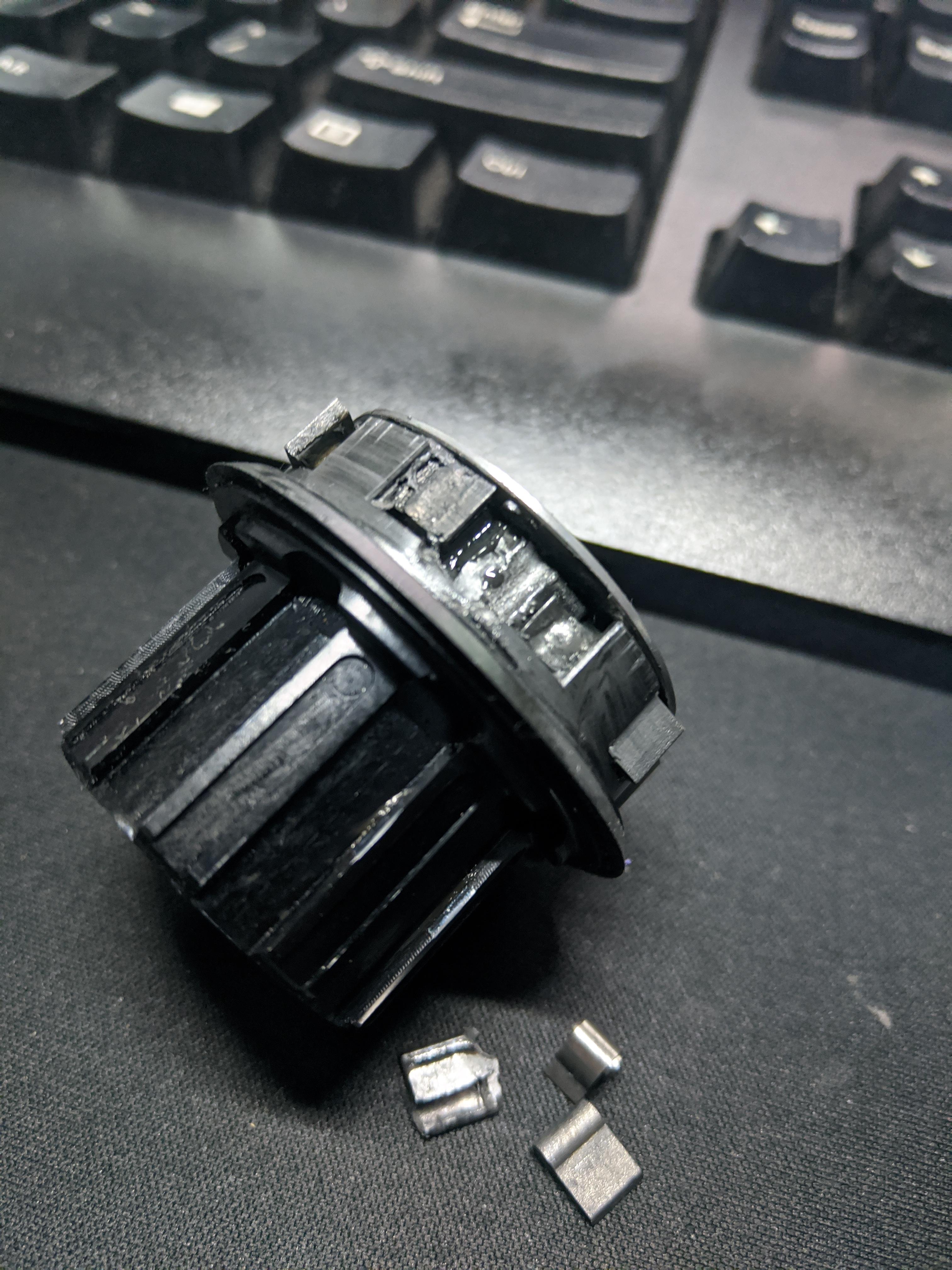

I don't know exactly. I am fat, heavy, noob.... Highest drop honestly is just 4 feet. pedal kick is only a meter, can't sidehop above 3 feet.... I don't know, really....

I went from numerous freewheels to a freehub in order to get rid of skipping issues. Modern freewheels are crap, but so are freehubs, it seems. Currently have i9 Hydra and it skips too..

My pedal kick honestly is somewhat weird to see or maybe. I stopped doing gaps straight front, usually diagonal or sideways since the first time i stripped my hub and landed nuts over the stem. Or maybe I need to imrove my gaps more, it is just heartbreaking to break parts which impacts my pocket and enjoyment....
In the last 20 years, I broke just one freehub on my city bike (bought in 2000, cracked in 2021). I weigh 70ish. There has to be some detail in your gap technique that kills them. Or do you have some special dust or sand that clogs the pawls where you live or something? Like that fine Oz outback sand that gets through seals like it's nothing, I mean.

the hub is I assumed well sealed. Things that I feared on my experience now; freewheels made from steel hub shells stripped (Hope, Novatec, Morality) this one all made from 7075 (shell and freehub). if only both of these worlds come together....

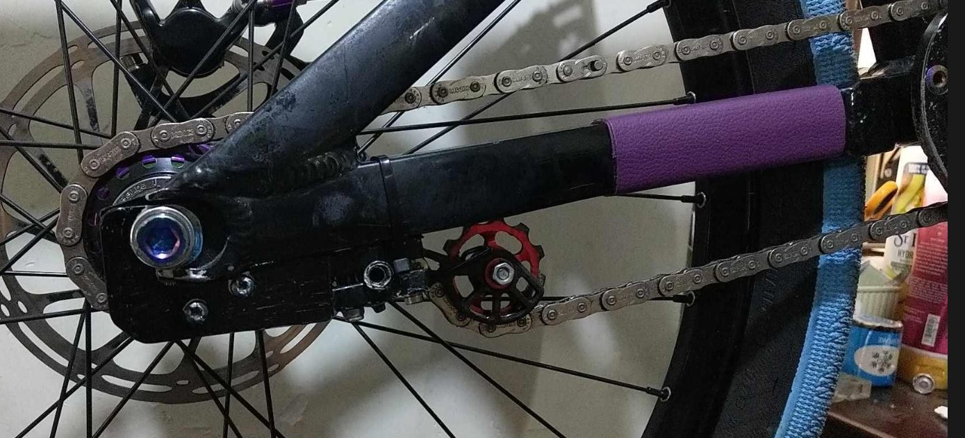

Mind posting a clip of you or at least your cranks when doing a gap?
Must be a "bitch crank" issue. If it's not, then I don't think it can be an user error in any other way.
If you preload a big amount suddenly and kick very aggressively without letting the hub engage first. Sharp impact with momentum is likely the reason, not power. We see hugely powerful riders using these hubs without constant issues, but they are smooth as.
In fact I've been struggling with similar issue for years, since I originally learnt gapping with way too much preload/kicking with the front foot instead of shooting forwards with my body and trying to be more equal with my feet. It's really hard to get rid of that unwanted muscle memory and I still occasionally struggle with that. Often when I try to put all my power on something, the front foot unconsciously lifts way too high. But my hubs have been doing relatively well though, if not counting those faulty products that everyone else is having problems with too.
Edited by Jere_h
Didn't see a massive issue in that particular video, but it came a bit more apparent from the other videos on your channel. There definitely is some "hammering" effect or last minute kicking, if you know what I mean. And you seem like a fairly strong guy so that might be it + bad luck with the parts.
Probably try learning to jump more with the body and less with the pedal kick. If you watch pro competition riders they barely lift the front foot when they gap (some small pedal kicks or preloading for drops are different thing). For gaps, they have already preloaded their cranks a bit before the actual preload for the jump which happens with the body. And their ankles/calves do a lot of job, almost equally on both legs. Much easier said than done, I know.. 😃

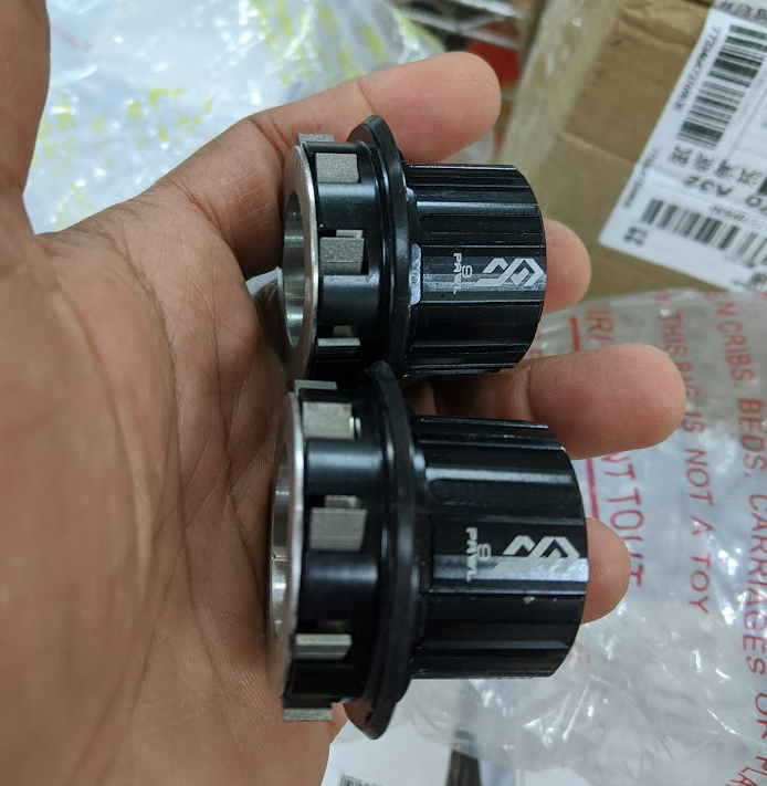

By the way, EXTENTION just sent me 2 pieces of freehub for free.... Seems glorious yet I am curious....
