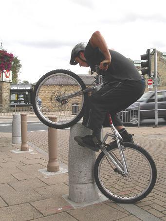

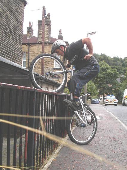

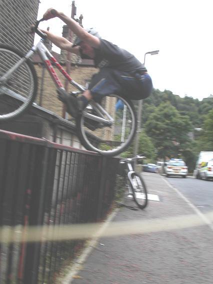

whatever this man says do it - he can pidgeon f**king phone boxes!!!
:unsure: :$
on the bangor ride i discovered that on really steep high stuff, u hav to accept that your front wheel being so far over the rail, means it will slip !
but u can put your weight all on the rear wheel. even though your over your bars.
and then rather than push your front wheel down to jump upward, u can pull it toward you, this is your forward momentum,because your in such a silly position u cant move forward.
it does slip off a bit, but its done what it can by then, haha
just thought that might help more.
the pictures below dont show this but ahh well,
jut thought it might help,,
:) wooo im just enjoying actually knowing how to do a move for once !!, im clueless on tap gap sidehop ect.. ! :blink:
