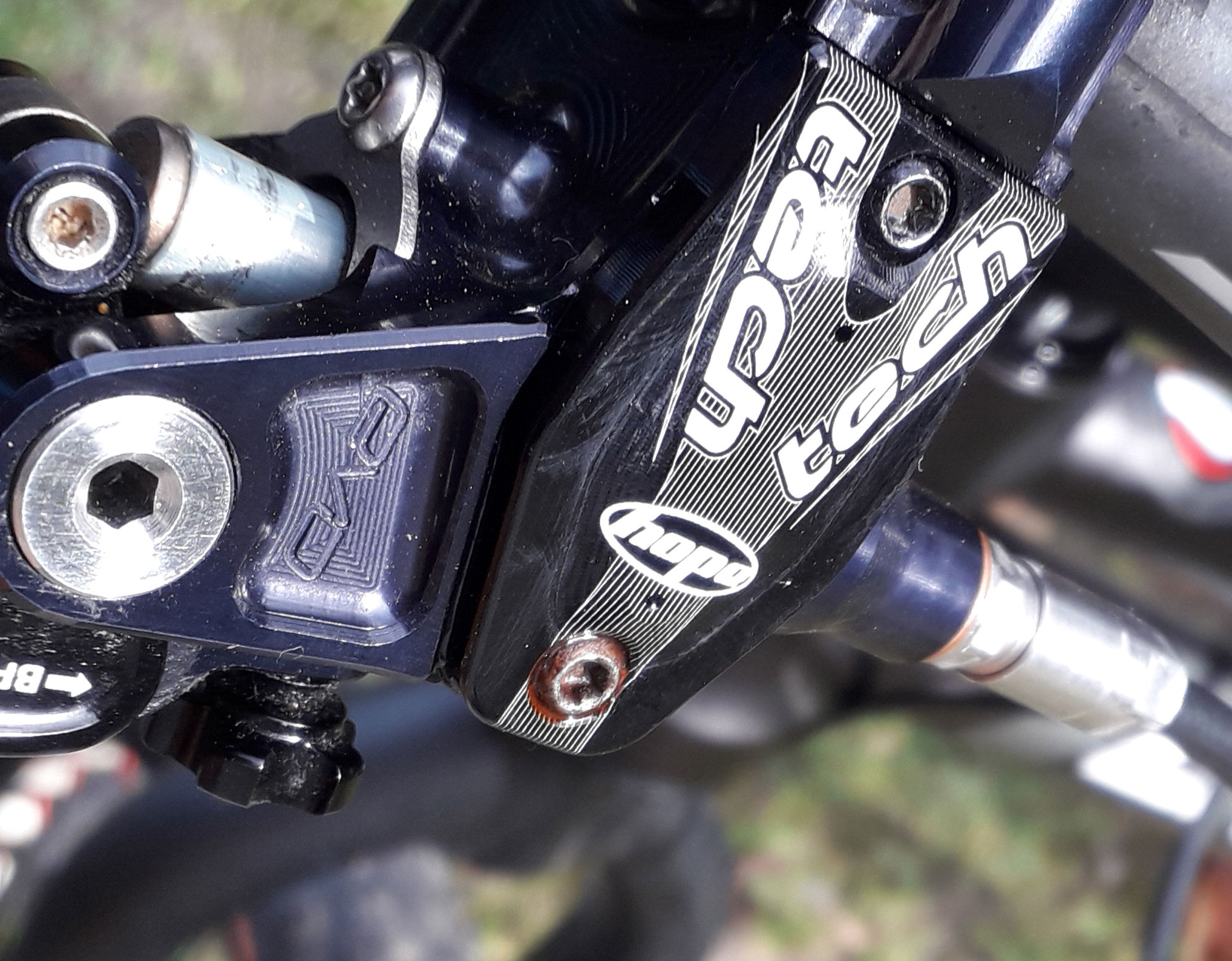

  9. It is a small amount. If i wipe it off before riding, general usually it's not there again after that. But if y let the bike stays stored a few days there is a small amount of fluid again. See on the picture attached, it seems to come from around the screw holding the caps .... hence the rust ... I ride it like that for weeks now, but if there is a problem i'd like to know and fix it. And if there is no problem, i much more happy then ! ;-)
  10. You mean excess of fluid from the bleeding (after changing the diaphragms) ? Or it could be fluid coming from the reservoir (inside) ? I will take some pictures, but the leak is small and "slow".
  11. Hi everyone ! I bought from you a few years ago a "Hope tech evo" lever (https://ep1.pinkbike.org/p4pb9311179/p4pb9311179.jpg). For a few weeks, maybe a month it leaks some break fluid from the two reservoir "caps" . Having some spare diaphragms, i tried to change them. And it still leaks. Not a lot, the break is useable. But it does worry my in term of reliability. Anyway, what do you think of it, it is a known issue ? And what spare part could i swap/change to solve this issue. Thanks a lot !
