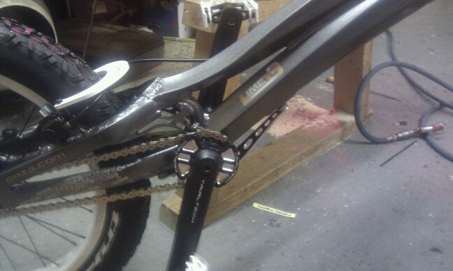

  2. Nice one bud, honestly if you do what i explained it will be perfect, don't be scared to take at least 2.5.to 3mm depth of the outer part of the bash ring, that bit is the cause of the bashring not fitting. Never had a problem with it twisting.
  3. Guys you need to grind or file a nice grove for the cranks other wise you'll end up damaging the threads due to the uneven force the bashring is putting on the freewheel. If you put the bashing on mark each side of the crank onto bashring then remove and file in-between the lines to make a channel for the crank to sit in. This will fix your problem and the ring should fit perfecrly square.

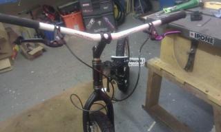

  13. Built this up for my cousin duncan mac for christmas, looks really nice but most of all ride lovely!! he's finding the bike brilliant. SPEC; LIMEY 320 FRAME TRIALTECH FORKS-FORGE STEM-SPORT RISER BARS TRIALTECH 165MM CRANKS TRIALTECH BASH RING TRIALTECH TWIN CAGE PEDALS HOPE HEADSET TRIALTECH SPORT LITE BOTTOM BRACKET HS33 FRONT AND REAR BRAKES - LONG LEVERS TRIALTECH 2BOLT BOOSTER PADS- TNN LGM WHEELS- TRYALL HUBS- TRYALL HOLE RIMS- TRYALL LITE TYRES ECHO SL SUMP VIZ BRAKE CLAMPS KMC 810 CHAIN

  15. yeah true am sure there are alot of people out there who would just use it but for me it aint right and i like things to be the way they are ment to be. lets face it, the hub is faulty, if you guys could see how bad the fit is you would undrstand, apart from moving back and forth it also moves up and down about 2mm there for not catching the teeth alot at all. DODGY.COM.
  16. Well well well thanks to Adam at tartys for emailing echo with my pictures because the hub I have is faulty and no ware near correct so its getting changed through warranty. Pretty happy I started this thread as I would of went ahead and just used it. Down side is my wheel build was pointless as I now have to de-lace and start again with a new hub. So how many more are there out there with the same problem?
