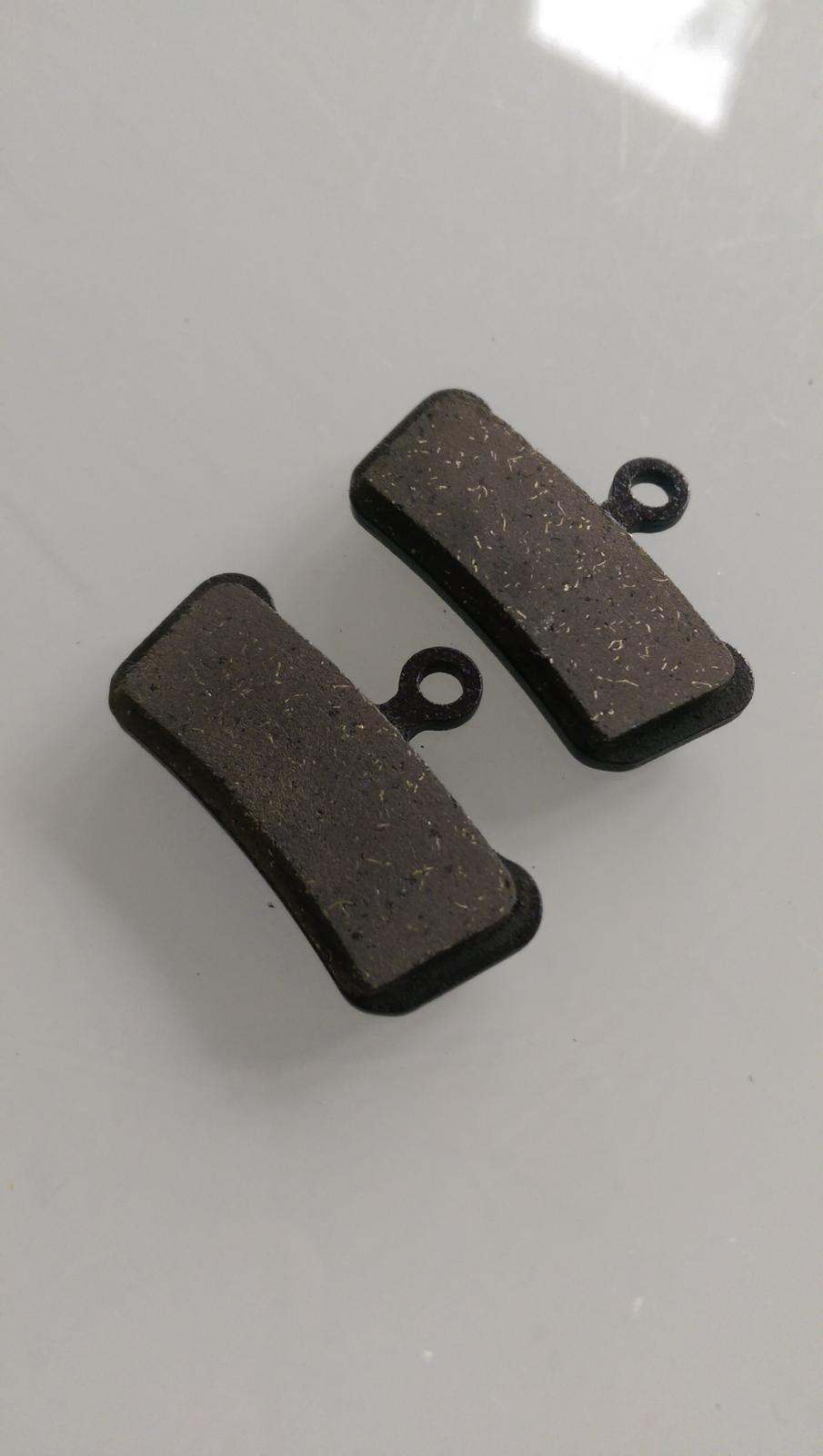

  2. Just spent 30 mins in a multistorey carpark (it's raining) bedding them in. The new sintered pads feel miles better, totally silent (for now) modulation on these is really good. Nothing like any other avid I have tried, pad rock is non existant aswell which is good. Forgot to add dry bedding in, no water.

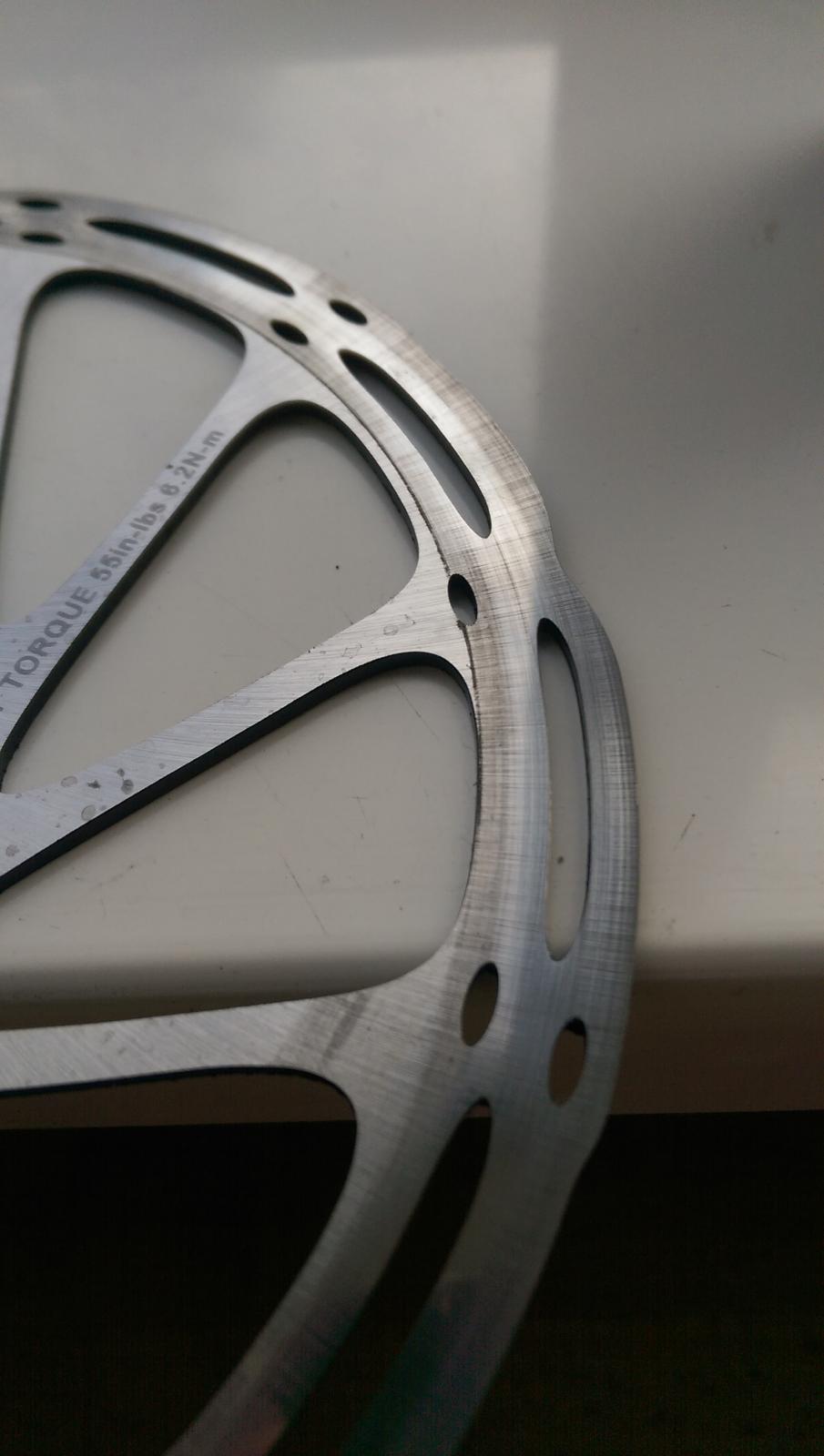

  3. I also got new Rt66 rotors in 203mm, hope mounts, and a few new pairs of pads for the saints.
  4. Ali that was seriously good and Mark amazing work as usual. I'm watching again then off out on bike.
  5. Is that meant to be funny.
  6. I have not ridden the bike yet should I bed in with original pads or these new sintered.

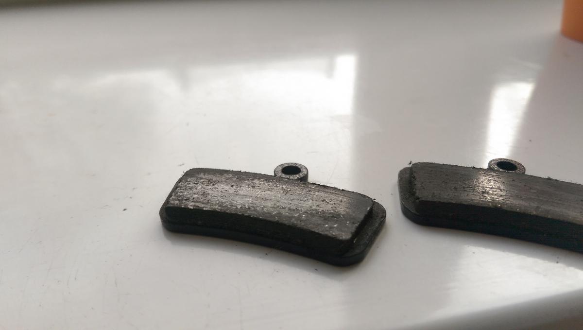

  7. Downhill, that was about an hour's not riding much, indoors aswell. It does look like a shit compound, like you could pick it off round the edges.

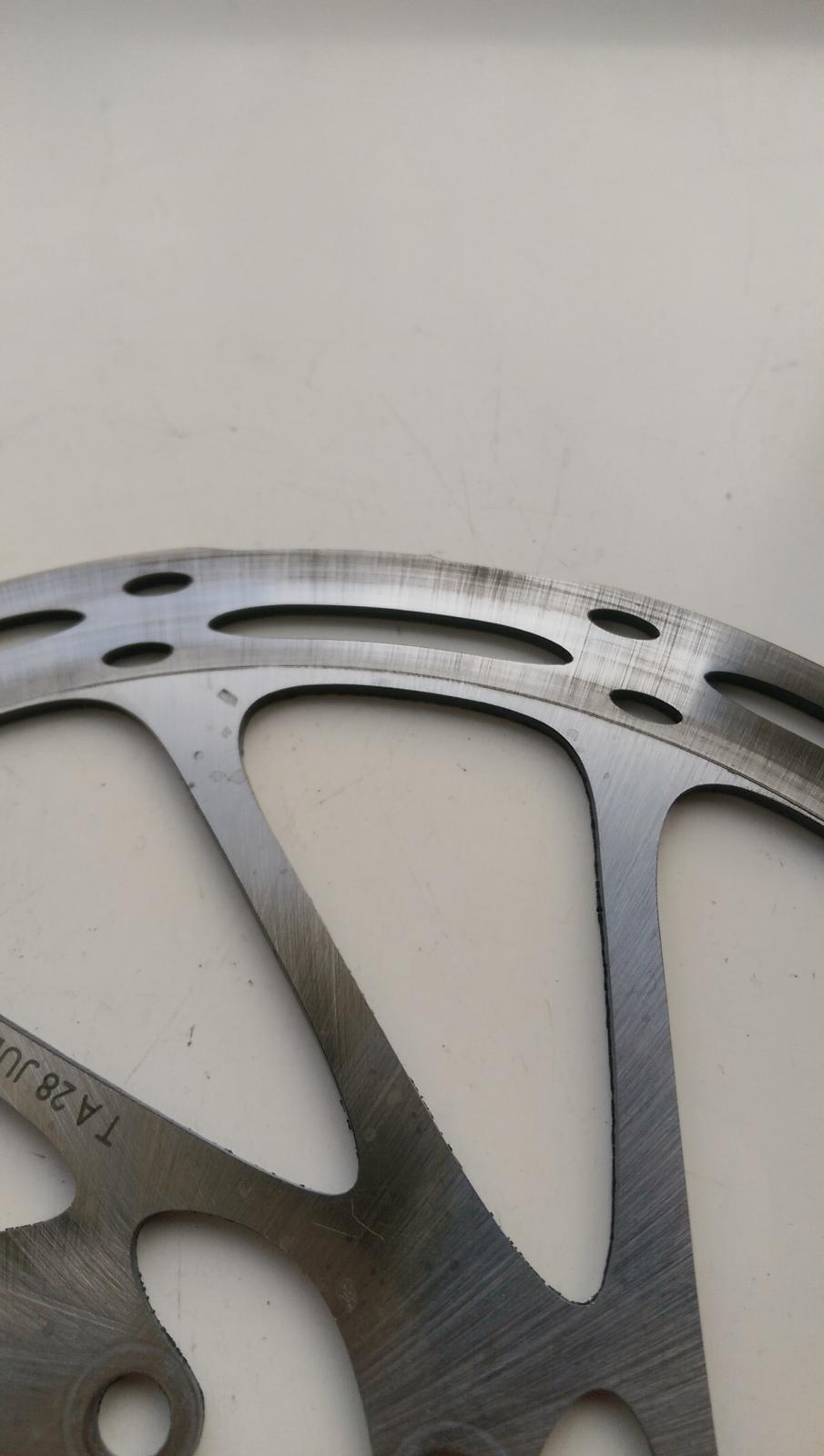

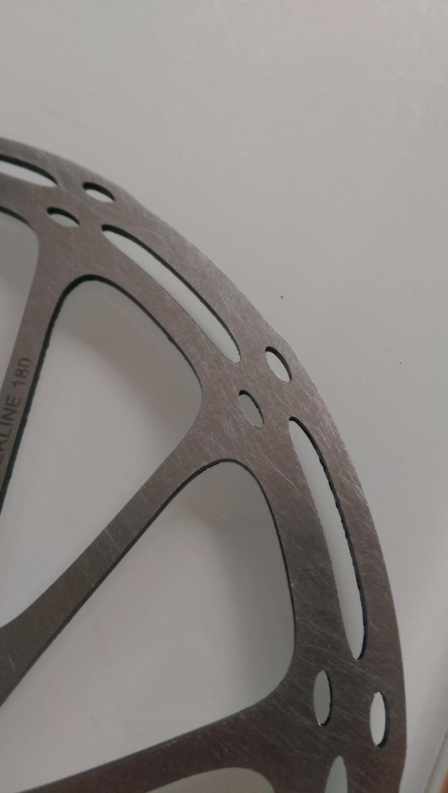

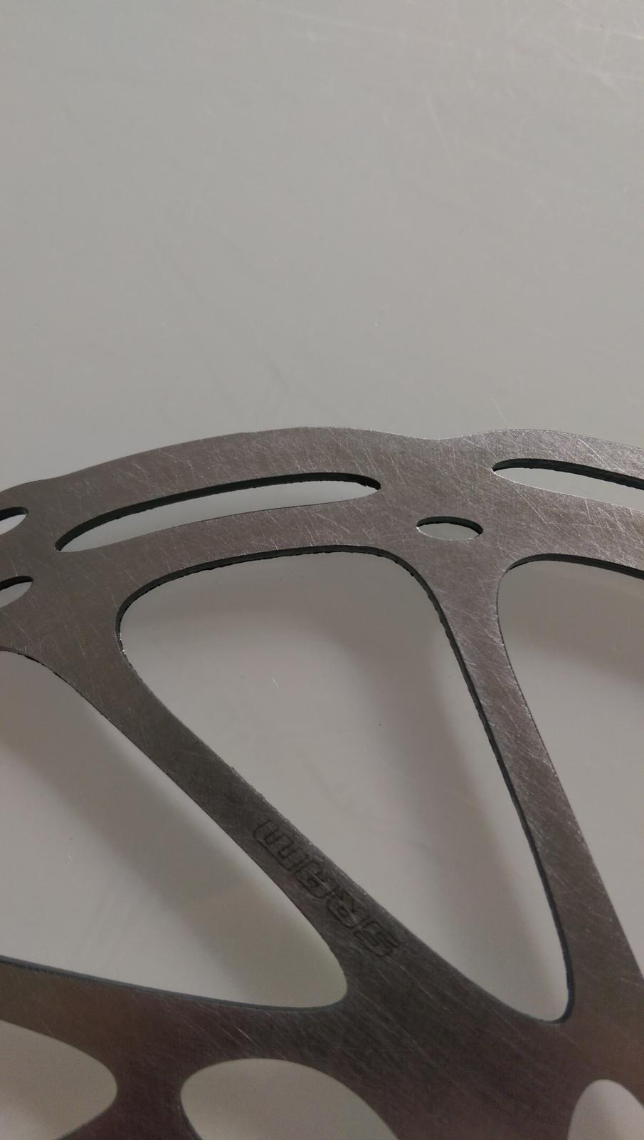

  8. Isopropyl alcohol, to wipe discs, supposedly best stuff evaporates with no residue. Lightly sanded discs on a flat surface, with a sanding block and 200 grit, I think wet and dry. I them washed discs with fairy and hot water, rinsed really well. I also sanded pad surface, until it was like new, then left them all on radiator to dry.
  9. Cleaned Now to try bed in properly, to water or not to water that is the question.
  10. A serious amount of black gunk was on discs, pads and calipers.
  11. Dman

  15. Everything full New brake set, looking online it can be a number of things Contamination of pads/rotor Mounts need facing Caliper not aligned correctly One site said a bad bedding in period can cause squeal, if the pad material is Not laid down evenly on the disc. I'm pissed with brakes. I'm looking at different pads all I can find for them are these from uber bike http://www.uberbikecomponents.com/category/331/View-all-Avid-SRAM-Disc-Brake-Pads-here What compound would you recommend from what they offer? Kevlar Sintered Semi metallic Race Matrix Help!!!!!!!

  19. Ye tried tape on the pin didn't do much, not tried it on the backings, that wasn't the main issue, they started squealing like a pig, New pads, rotors cleaned, filed paint off mounts, still really noisy, been like that for a while, only used to be noisy when wet but now all the time, as if they are contaminated, but can't see any leaks. Sending them back under warranty see what they say, I really liked the saints.
