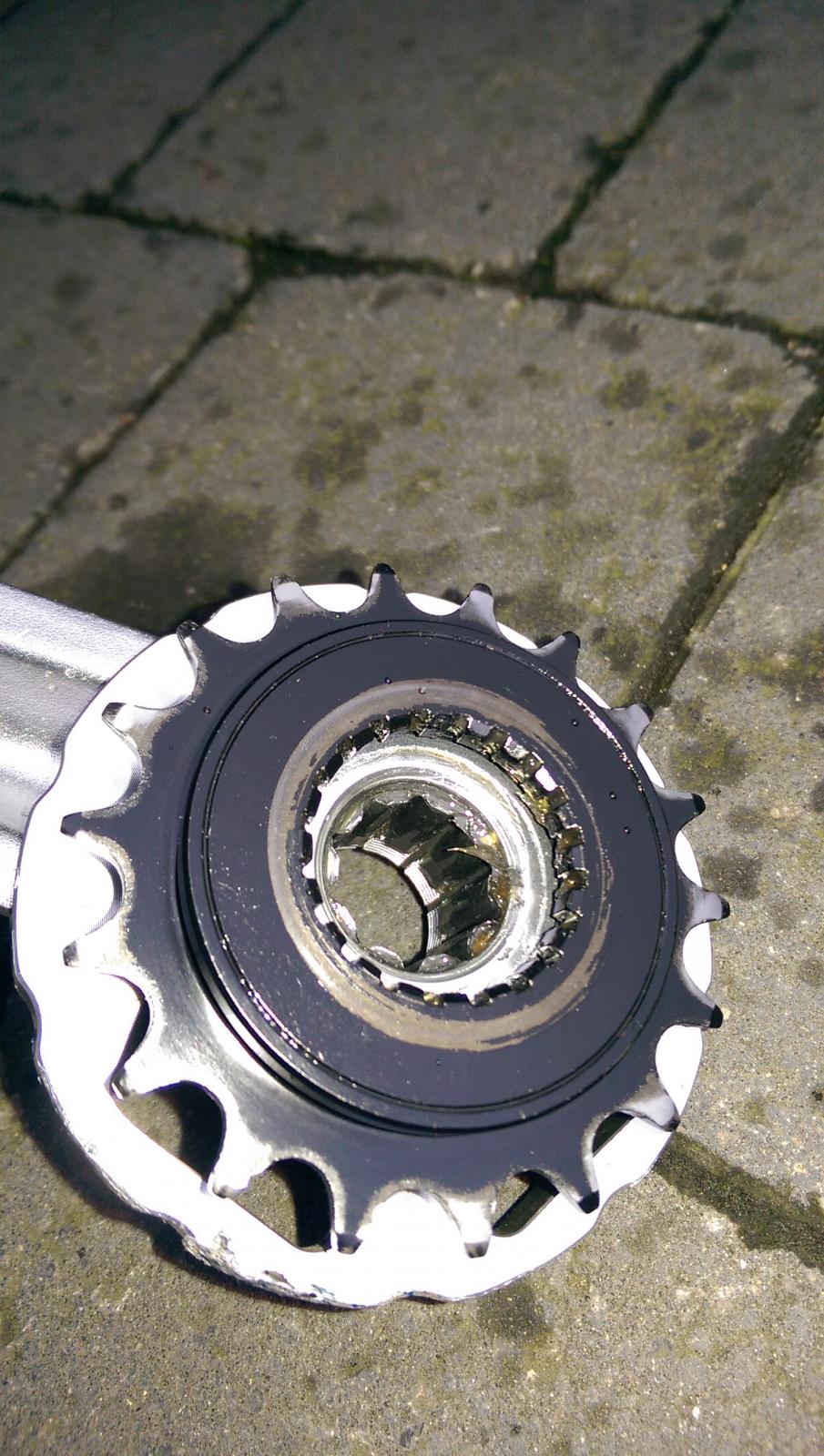

Non drive side I can tighten fully, drive side needs arm pulling off slightly then you can put bolt in, but nowhere near tight enough for it to be safe to ride. I know onzas aren't great quality wise, but I had a zoot, my mates got a zoot and another's got a blade and another a bird no problems with them like this. It really seems as if a spacer is missing, but I don't think it is, can you put a washer on end of bb axel? What's the best fix then? Thanks
Anyone? How is this fixed?
Don't see how it's standard and nothings been changed from New. Although what your saying seems correct
Posting for a friend but I am trying to fix the problem. I just had a go on my friends onza vox, I noticed chain was really slack so I tightened it up at same time I checked crank bolts as they always used to come undone on my zoot and they were really loose, so I tightened everything up but when I spun the cranks it had a tight spot and a loose spot. I stripped everything down took bb out all seemed fine regressed and refitted, put non drive side arm on spins perfectly but as soon as you put drive side on it starts to bind, crank arm looks fine, freewheel looks fine no play seems to be on straight, but I did notice a semi circle mark on the freewheel where it's been rubbing, when you tightened it up it is rubbing on the bb. Is there a spacer missing or something I'm not seeing? Any help appreciated.
