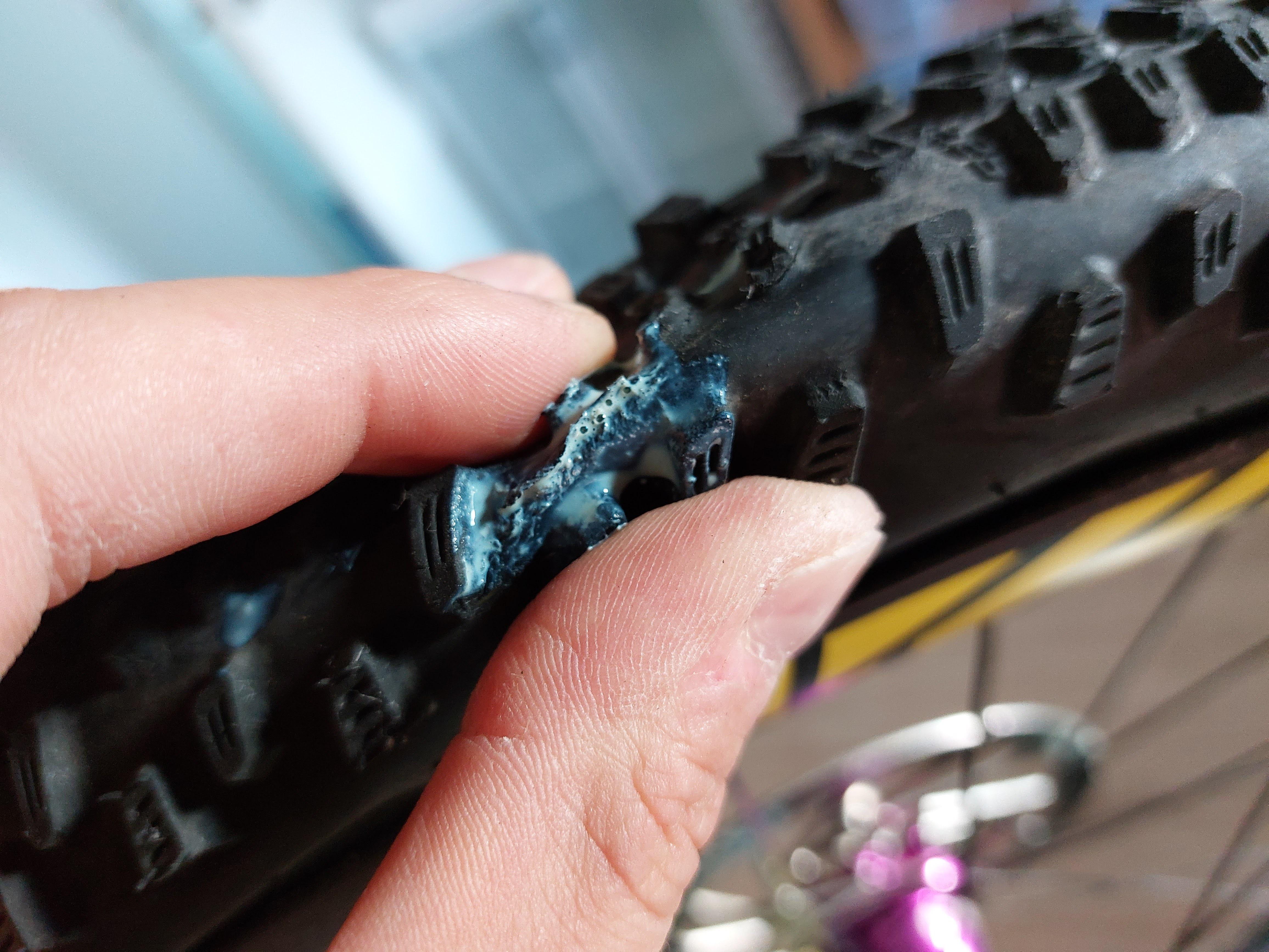

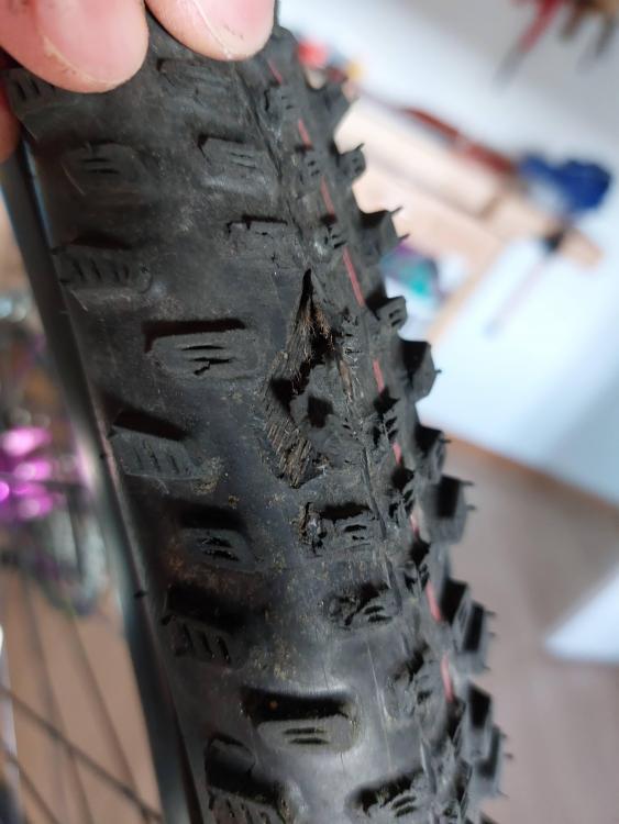

  9. Besides that huge tear, it was tearing off knobs left and right, not really worn out, so probably just absolutely not suited to trials abuse. Haven't had that with other tyres, so must be something Schwalbe, or at least this tyre. Trying the race king protection now.
  10. Hm, I might try something else than Racing Ralphs again, damn, two big ass tears. And on closer inspection, many side and middle knobbies coming loose/half torn off. Meh.
