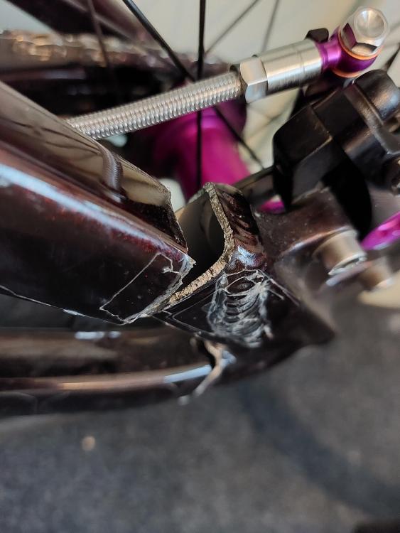

Inspired indeed, one too many bunny ups, and maybe a bad weld. Still, held up for three years. But I'd even get an Alibabba Extention before that abomination of a Clean.
Case in point 🤪 Anything can break, but better have something that at least looks good while breaking it.
