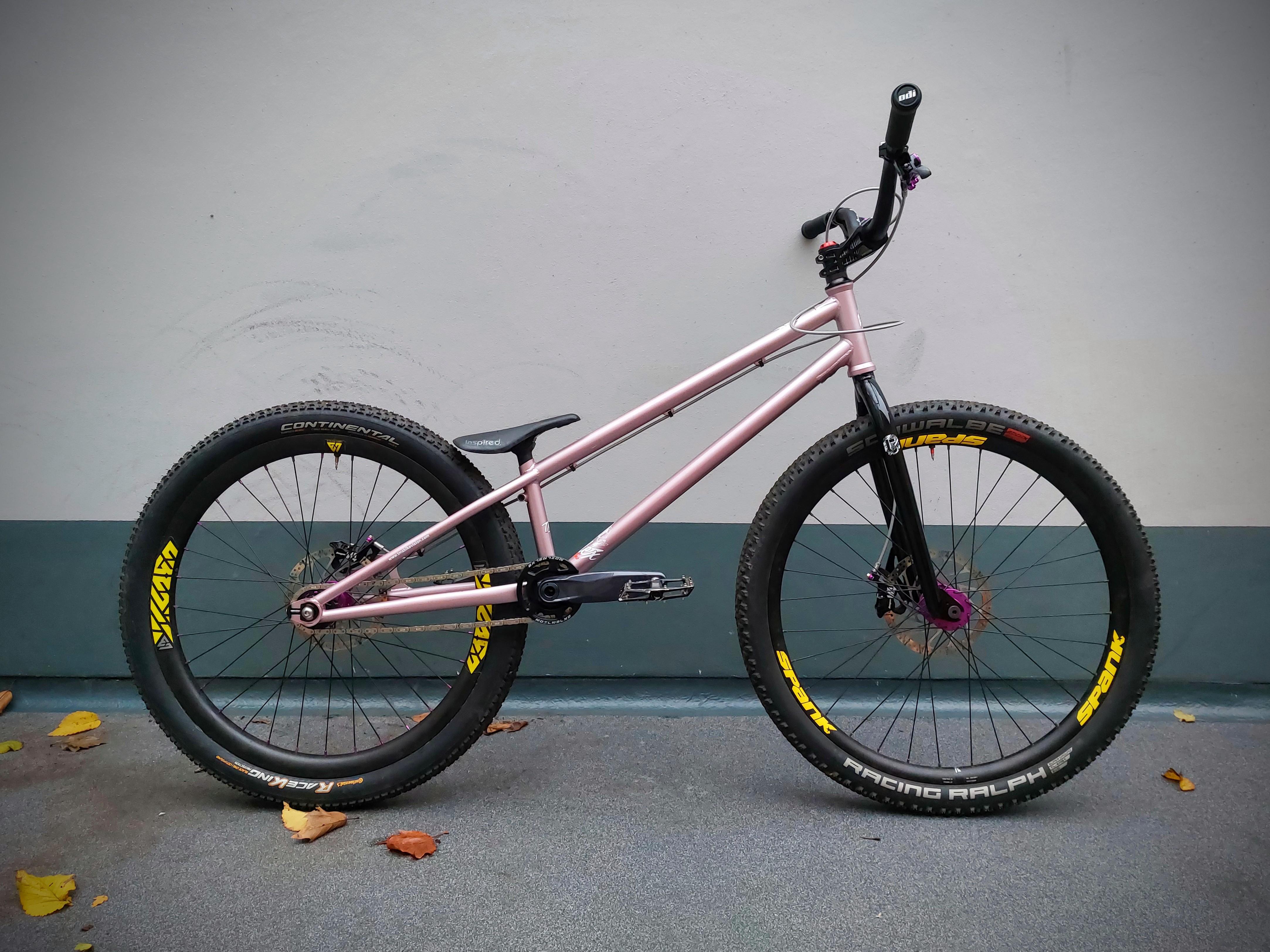

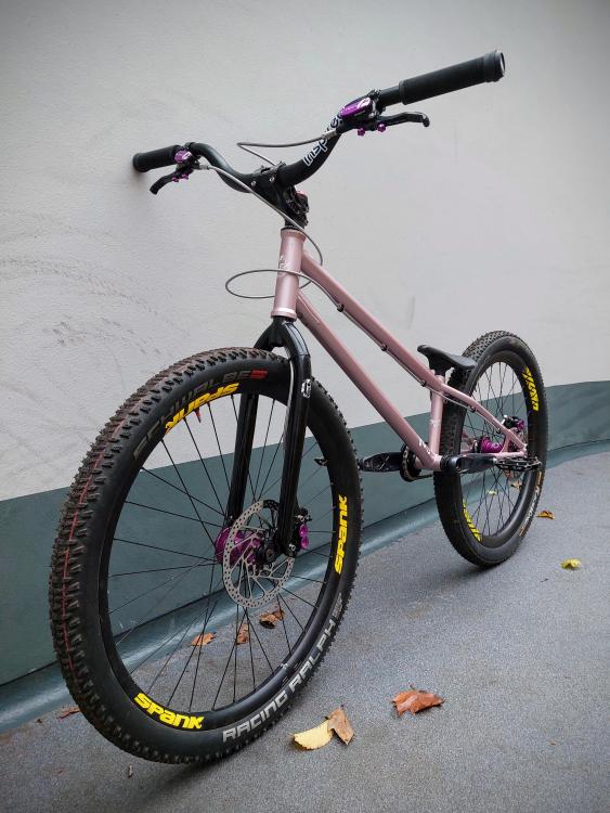

Unfortunately broke my Hex last week, so was on the lookout for a new frame to swap my parts to. Not that much choice, especially not on short notice: Inspired came through with an offer for another Hex frameset, but decided to go for the TMS. Shipping was fast from France, so here it is already! One short and wet ride in, rear end feels surprisingly solid. Front is a bit flexier than the Hex. Feels really good on the rear wheel, also seems slightly easier to turn/spin on the rear than the Hex. Bunny hop needs slightly different timing/input. Need to give it some proper time and tuning, but so far I like it. Hope it lasts as long as my old Ozonys, as in, unbreakable, even by me
