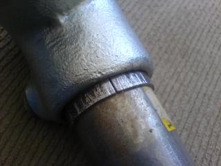

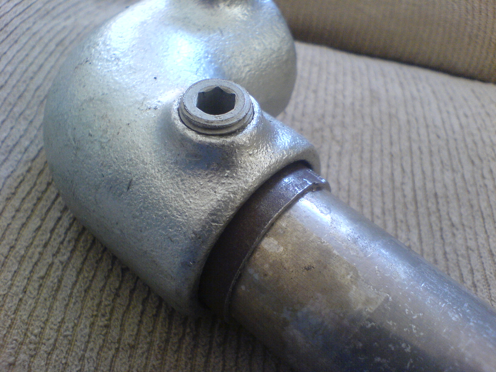

  3. Mini bump, got the kee clamp tests today. Found a perfect shimming tube too... The shimming tube slotted over the structure tube pretty easily, so obviously when I clamped the kee clamp up it didn't grip at all and just slid out. So I cut a slot (on my couch I might add...) into it so when the clamp compresses against the tube, the shim shrinks in ID until it grips the tube. So I'll order the remaining clamps and get building. I am still going to remove the lug screws and drill right through although I need to resist temptation to leave it.... Got to source plywood for the back now and eventually some holds!

  11. Awesome thanks, Ill let it run a bit longer. My only other worry with that is slip between the shim + the tube. I know araldite is bloody strong but still I may have to try and find a welder...

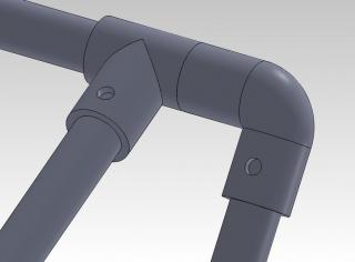

  12. So to get back into shape quicker, I've been looking into building a small packable bouldering overhanging wall for internal use (IE when its raining). Packable so that it's not permanent and I can use it in a student house next year without damaging the house itself. Initially I thought of something like this because it has the massive benefit of not having vertical supports infront of the wall that you might fall off into. However after a while I realised I couldn't get hold of the massive 2 long members (which scale wise would be about 12ft long) and also they would render the whole packable thing useless (it doesn't fit in my car, its too big by estate standards). Also you'd need a lot of counterbalance at the back to counter-act moments produced at the top AND its a bloody massive thing and would take up an entire room. So I've bit the bullet and gone for a standard right angle triangle with the hypotenuse being the wall itself. Ive managed to get hold of 10off 2m lengths aluminium tube so I'd like to use this for the frame. Its 32mm OD and a whopping 3mm wall thickness! If you're thinking its not strong enough - on its own it supports me standing on it in the middle (albeit it does deflect, but meh in a frame structure it would be better). Size wise Im a little undecided, but the height (or hypotenuse) will need two tubes joining together, not necessarily 4m high because I doubt Ill have room for that! The width will probably be 4m wide so again, I need to join two tubes together (in a temporary fixture btw, again, my car isn't 4m long) Now comes the problem because thats all I've got. Obviously I need some bits to join it altogether which Im going to have to pay for, but I've come up with a couple of ideas I need the engineers out there to play devils advocate with. Option 1: Kee klamps Kee make kee klamps in size 6 which accepts tubes of 33.7mm OD. The benefit is that due to their small nature, I could permanently fix the fittings onto 1 pipe, meaning that assembly only needs one grub screw tightening per join. Its also tidy, easy and simple. Cons: 33.7mm > 32mm => Fixed by adding a permanent shim (araldite) to the ends on the pipe increasing the tube OD at the ends to 33.7mm. Grub screw slip forces => Maybe Im just paranoid about this, but Kee suggest that for a 2m span I shouldn't exert more than 268kg of weight on the span. I assume thats a UDL and not a point load but as Im way under this I think I'll be fine... £££ => Little bit more expensive but I can live with that Option 2: Custom 'cut and file' notching Notching is basically milling the ends in the centre with a 32mm end mill to create the the OD profile into the tube. This creates a lovely fit and supports the tube from twisting a little. Once an end is notched, I could use a hollow starnut (because its a bigger bolt size) inside the notched tube, drill a 10mm/8mm hole into the un-notched tube (eeeek), add a distance tube to the inside (which would need to match the ID profile of the tube and probably be loose) and then bolt the two together. Whilst Im getting the standard 90 degree fittings notched, I could also make up some shorter braces across the corners to help strengthen the frame too (Notching) Cons: I don't possess a milling machine => Find a machinist and see if the tubes will actually fit. Might bump the price up a bit. Or mark out and use a half round file... Accuracy => If its not right, it definitly wont work... Hole weakness => Depending on what size bolt is used in the hollow star nut systems, drilling that sort of sized hole into the tube could weaken it a great deal. Once I've got the frame work, Ive then got to think of a way to get plywood onto it securely and then source holds. If I get it done quick enough, I might be able to get some free boards from work from used router boards, but for now I've got to get this done... Any ideas and CONSTRUCTIVE critism is welcomed. Solutions, things I havent thought about or even other ideas welcome too Thanks
