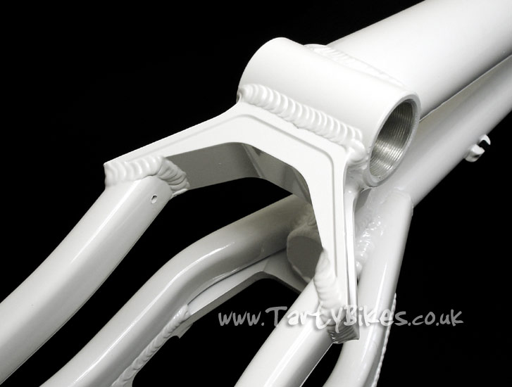

Basically I absolutly love the way the Czar rides but its a bit heavy compared to most "competition" orientated frames. I am planning on shaving some weight off by running different rims etc but the frame itself I would like to get down to 1.8kg instead of being nearer 2.1kg.
That hole will be fine, but it'll only save you about 5g.
Paint = approx 50-60g.
Head tube hole.
Hole in the end of the top tube.
Larger breathe holes between head tube and top/down tubes.
Larger holes in dropouts.
That will save about... 25g. If you want to make it light you'll need to make your tubes thinner...
Paint = approx 50-60g. Soon
Head tube hole. Done
Hole in the end of the top tube. Done
Larger breathe holes between head tube and top/down tubes. Semi Done
Larger holes in dropouts. Semi Done
They are the things that i have done to my Czar currently, along with internal cable routing.
Adam
Hmm, making tubes lighter eh?
Must be a way :P
But adding up a few holes here and there along with paint etc will save about 150g or so,half way there :P What about skillfully dremeling the built in booster off, just above the top mount holes. That should take a bit off???
