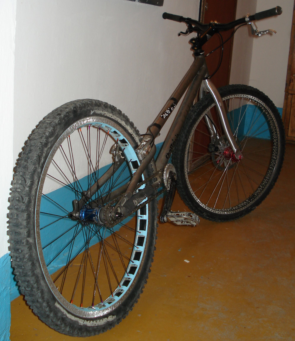

Hi!
Here You are, please check up:
Frame - Triton by mr. Gazza!
Fork - Echo Pure disc
Headset - Toxsin
Stem - Viz 120x20 with ti bolts
Bar - Onza riser carbon 760
Barends - Triton ti
Grips - Echo
BB - Echo with ti bolts
Bash - Zoo! old style
Cranks - Zoo! cnc old style with steel inserts
Spocket - Mixmaker style 17t
Pedals - Wellgo MG-1
Chain - Kmc Kool
Front hub - Chris King disc
QR - Hope Ti
Front rim - Alex DX-32
Spokes/nipples - NoName
Rim tape - no
Tube - 26x1.9
Front tire - Maxxis Highroller exception 26x2.1
Rear hub - Chris King iso disc
Spocket - BT 15T
QR - Shimano
Rear rim - Dob
Spokes/nipples - DT Revolution, Champion/alum
Rim tape - 26x34
Tube - 26x2.1
Rear tire - Schwalbe BigBetty orc 26x2.4
Rotor/pads - Plazmatic 180
Caliper/hose - Magura Louise 05
Lever - RB Design 07
Rear brake - Echo czar
Pads - Rock Blue
Booster - Echo ONLYstyle
Clamps - Magura
Hi!
Rear DOB rim is very flexy in this modification for rear wheel use, so Ill put it on front wheel soon. My lovely drilled and ages lasting DX will have a little rest. DOB weights just nothin, too light rear wheel seems for me more important then light front wheel, so why I use DX on the front.
Plazm rotor works great when its clean, but when it have any dirt it loose the power, but again its very light, about 90gramms. Small amount of water increases the power of brake too much, modulation is lost at this time.
Didn weigh my bike, but seems around 10kgs - there are still many ways to light my bike - front wheel, bb, bashring etc..
Grind on DOBs lasts not so long as an ECHO rim for ex, but its quite normal.
