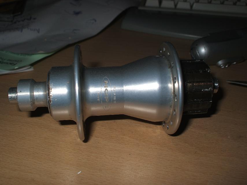

looking good there dude! another great thing you have there is an infinitely adjustable chainline! awesome

random question bro, how you mounting this? modded qr or tapping threads into the axel?

I doubt it, because in a MTB, you need to dish the wheel to the drive side, so they should balance each other out pretty much, it might be about 5mm out or so.
nope, a hope xc is pretty symetrical (bigger spacer on non0-drive side) with same sized flanges so you build it pretty much central for 135mm spacing
I'm thinking of putting a rod in the axel to stiffen it up then tap the inside to M6 or whatever diameter it is to run with bolts. I might juat run it with a qr skewer to start with until i can be arsed.
could you not have lost at least half of the 19mm on the non drive side? all that bit is is axle and spacer/sleeve to turn down on a lathe surely?
and instead of losing a bearing, you could trim the freehub up to the bearing, die the freehub and have a lockring that runs on a thread on the outer of the body rather than inside?

i thought about doing it the easy way...but my original idea was to use a hope xc as opposed to a mono to create a decent casette hub with a disc mount for use on a mod (inspired by JT's topic) I guess i can always change the hub shell to a hope xc version at a later date, and in theory (because the non drive side spacing is unchanged) it should have perfect disc alignment!

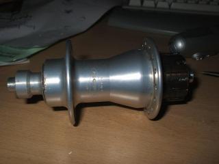

below is a picture of it today, just got to neaten the end of the freehub body up on the lathe now and take aprox another 1mm off (roughly cut currently), then get the thread cut on the inside of the frrhub body for the lock ring.
The spacer edd potts made from bronze i remade from aluminium...i think it's going too wear quickly but its all i could find!

That hub looks mint! Hope should actually make a 20" version!

That hub should be mint. Id love one in a pro2 :-
Also, i saw that lad say hope should actually make one, which i agree with 100%. Thats why i gave hope a ring, and had a nice lengthy chat with one of the very helpful guys that works there! He says he has had a couple of people say the same to him, but he still thinks there isnt a bit enough market for 116mm spacing hope freehubs. They make the pro2 trials as it is only a small veriation from the standard pro2 that is mainly used for xc and freeride. However a 116mm spaced hub would only really have the market for bmx and a few trials bikes.
Oh yeah, i work in a bike shop, thats why i was on the phone to hope, i didnt just randomly ring them :giggle:

start a petition...show hope how big the potential market is for a decent mod freehub with a disc mount!
..and If someone supplies me with a pro2 i'll modify it for them to fit a mod!
