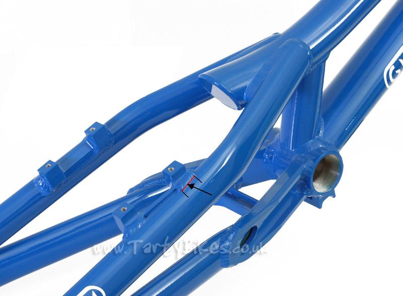

Ok so yesterday my friend noticed my frame was cracked on the outside of the brake mount, but then because of where it is I thought the pressure isn't going there much so if I got it welded would it be fine ?
I have added a picture to show where the crack is with the red line. (not my frame though)
Surely if there wasn't much pressure going there, it wouldn't have cracked?
I'd have though a lot of pressure would be going there, from the vibration and flexion(sp?) of the brake.
As has been said, warranty is your best bet.
Alex.
Aluminium can be welded without heat treating it afterwards, but it's a strange technique and I'm not familiar with the details. I know someone who got a set of forks welded like that at the disc mount and they last at least 6 months, I don't actually know if they resnapped or not.
In theory if it cracked once, it'll crack again eventually unless you put less stress on that area than before.
