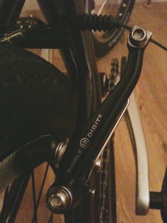

Mt frame (Marino Inspired geo 24") is quite skinny at the lugs and I have Onza Ronnie rims. My Avid SD5 is wide as balls as a result and I just can't get the pad angle right for hitting flat on the rim. I've attached a pic to help you get the jist.

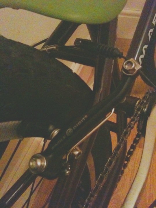

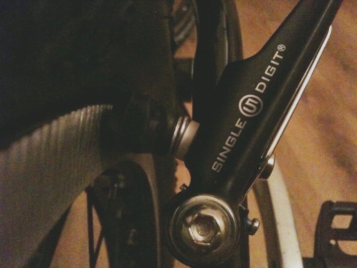

As promised.. side on(ish) pics of the problem. I have absolutely no decent light in my house past sundown so excuse if you can't quite see what you were looking for.
And Adam, mount spacing looks to be 80mm +/- across centres.

Short of a new rim I can't think of anything :/ imeen ronnies arnt even THAT wide to be honest, what's the angle if the pad like when you just run it flat to the arm no spacers ?? If it's anything close to right maybe just drag the brake round heavily till it beds in square, not exactly ideal but it may work

If that's with the fewest/smallest spacers in place on the pads then there's not a huge amount you can do really. A thinner rim would help, or if it reeeeelly comes to it then you could move the mounts on the frame but that's just effort!
What's the spacing of the brake mounts on the frame?
Well so far that's 'set up as it should be'. If I run it flat to the arm (non of the pivoting cup and ball spacers just a washer to deal with vibration) it's perfect on the pads vertical angle but then hits on a slant lengthways. I'm thinking there might be a way to solve that and hopefully without risking bending pad mounts or brake arms etc.

Mike's right, you could get some thinner pads like TNN LGVs, they have thin backings with a built in conical washer so the whole system can be a few mil less wide. You could also try some thinner arms like Shimano LX or XT arms.

unfortunately there isn't a lot I can think of doing without spending money. I am confident some thinner arms and pads would solve it and work very well.

to me it looks like the mounts are just too high ? almost like its a 26" mounted frame with 24" wheels in ?
The mounts are bang on it's literally the width of the rim coupled with the skinny frame that's busting the brake arms out like that.
I got frustrated with it, wrenched the arms out to force the slack end of the pad against the frame. It seems to have bent something to exactly the right angle. Still a bit spongy but nothing unbearable, and really flippin' powerful. It'll do for now even though it makes me feel dirty.

80mm brake spacing is probably what's causing the main problems - may require a thinner rim if playing with pads and spacers doesn't give results.
Ideally you'd want to move them at least 10mm or so further out which would give room for pads and a wider rim, though then you start to edge towards crank/brake arm issues too :P
