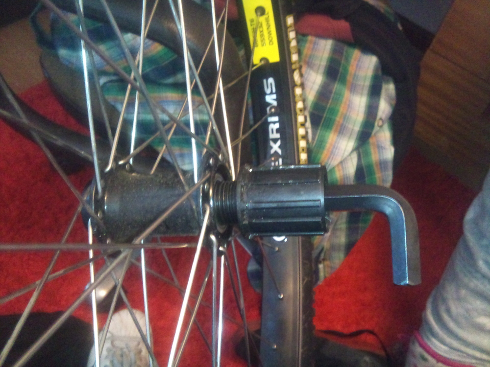

Follow these instructions to remove your freehub body.
I needed a 12mm allen key, which was extended using a massive pole. This took a lot of force, one person to hold the wheel, one person on the end of the pole. Could probably do it on your own with a vice.
post-23871-0-99740000-1323512322_thumb.j

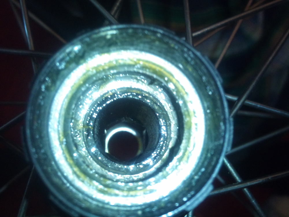

Almost there, you can see the washer which needs removing.
post-23871-0-87140200-1323512510_thumb.j

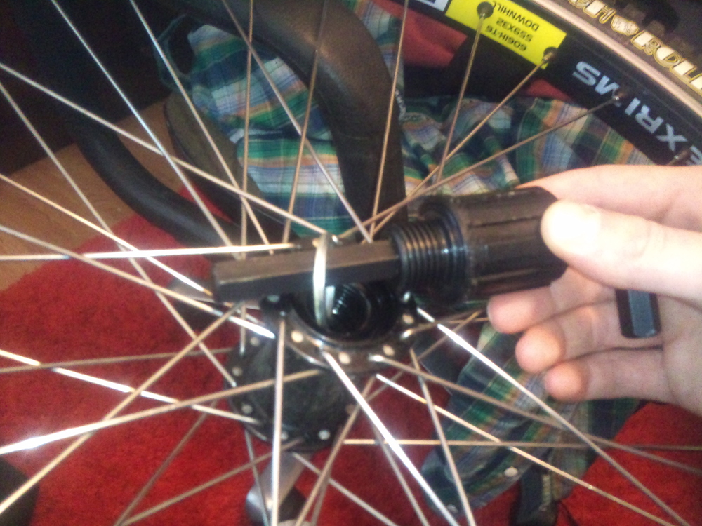

Remove the silver washer, and re-tighten the freehub body into the hub.
post-23871-0-37988700-1323512632_thumb.j
This thing is solid now and will do me fine until I can afford a fixed hub. The freehub is pretty much trash, it only has 15 engagement points, so I was not worried about damage.
