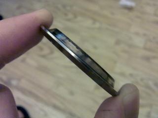

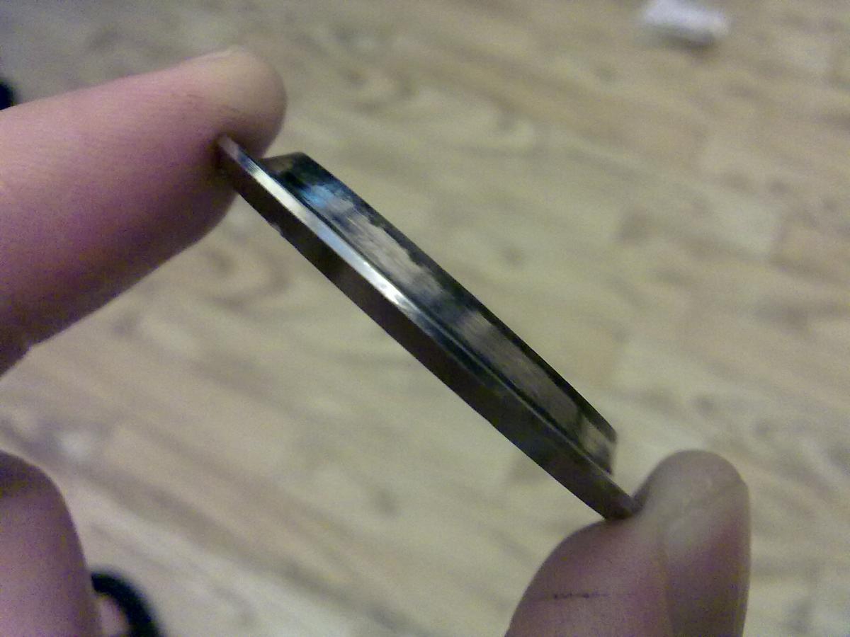

New Echo Urban 2012 Destroyed In Less Than 2 Months!

In all seriousness, its hard to tell, but in the 3rd picture it doesn't look like its got thr 45 degree angle for the race.
i cant see the angle of the headset effecting it, as long as the bearing is seated tight against the forks.
yeah I mentioned earlier it looks like theres no race integrated on the fork. Had a look on tarty, Ill be fine using a neon headset and 2012 forks, so alls good for me.
Its the shop you should be talking to really then if they advised you to not use a crown race with that headset.

Everything is fine, I will get the same new fork for free. But, one more time about crown race.
My headset is FSA 36 degrees, I have some crown race that was fitted on my broken Because fork. So I just put it on new fork and all fine?
And one more question - my friend use same fork with ECHO TR headset PLUS CROWN RACE. He must take crown race off, right? He already have a little dent on his fork in that place.

- Extra thick steerer now features an integrated crown race (45 degree - perfect for Echo SL headsets), reducing the stress riser at the bottom of the steerer tube. You must run a sealed bearing headset with 45 degree lower bearing with these forks and no crown race, or the warranty will be void.
