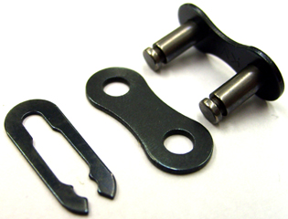

Hi there,
in the past two days i've snapped 3 completely different joining links and by different i mean by setup so different thickness design etc.
My chain and original joining link had'nt snapped for around 3 months and now it wont stop snapping them links. The last one took roughly five miuntes to break :o
has anyone got any idea's of how to solve this and why its happening?

Are you using a split link?
If so, just join your chain using a good quality chain tool. Far more robust.
Yeah thats what has been snaping every time, I may have to try that.

Yeah thats what im running but the problem is its the joining links snapping not the chain, thats what i dont understand.
Always a good idea to join it without one.
Theyre substantially weaker than a normal chain link. Dead easy to do with a good chain tool.
Fat Spanner do a great tool, and Ice Toolz
yeah im going to give it a go, but is the any downside's of doing this?
Apologies mis read the post haha.. I use a split link on mine. The traditional style one below. Not to keen on these pull n snap style links lol
No worries haha, yeah i snapped 2 of these one's. one was the original and one was almost new and then i tried the snap style link shortly after and it literally snapped within like 5 minutes. (pretty annoying)
No downsides, only upsides.
Better, stronger join in the chain. More hassle to join up, but thats minor.
Oh sounds like a win win kind of thing then, thanks alot :).
DONT use split links :), just get new chain and push link out so that its still in a little bit then link together and push in from other side with chain tool (hard to explain sorry)
Yeah i think after what ive now been told this is the best thing to do i just hope it does work.
Cheers for helping ;).
