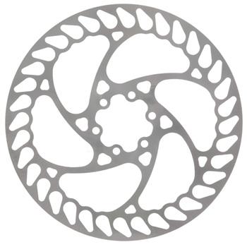

Rotors comparable with that brake and frame Hope mono trial, hope trialzone, monty, jaf, echo, there are a few more. All it needs to be is 160mm and be the same depth for the brake surface to fit the brake pads.
I wouldn't get an echo rotor, they are notoriously difficult to bed in and get a good feel/bite from, speaking from experience Edited by bing

You can use any rotor with the same diameter, it really doesn't matter! My vote goes with the Shimano RT76.... 65570-SM-RT76.jpg
I use these, very good disks, although the track maybe a little narrow for mono trials
It depends how much money you want to spend dude, a trial zone rotor is the best part of 30 quid, you'd be better off looking on crc and trying to find a match

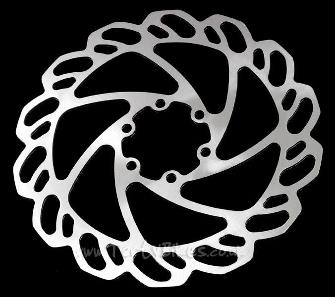

The one he broke appears to be an early version, hence it having a thinner lower part and the little notched cut-outs. If you look at the photo from our website, the design has changed to stop that happening. Same way the original Mono Trial rotor design changed...
Could be, the rest of cons stay though ;)
There aren't really any "cons" in a performance sense though. I mean, I'm not suggesting to go for it as there are better rotors out there, but if he particularly wanted to have it 'matching' or whatever then the updated ones can and do work OK.

You won't get a direct replacement unfortunately - they were rare back in '06/07, now they're impossible to get (believe me, I've been looking for about 3 years!).
The Mono Trial is virtually identical, but may have slightly more hold.
