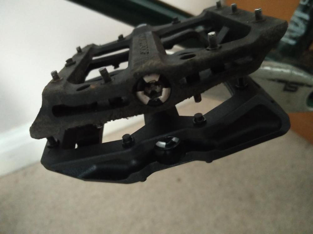

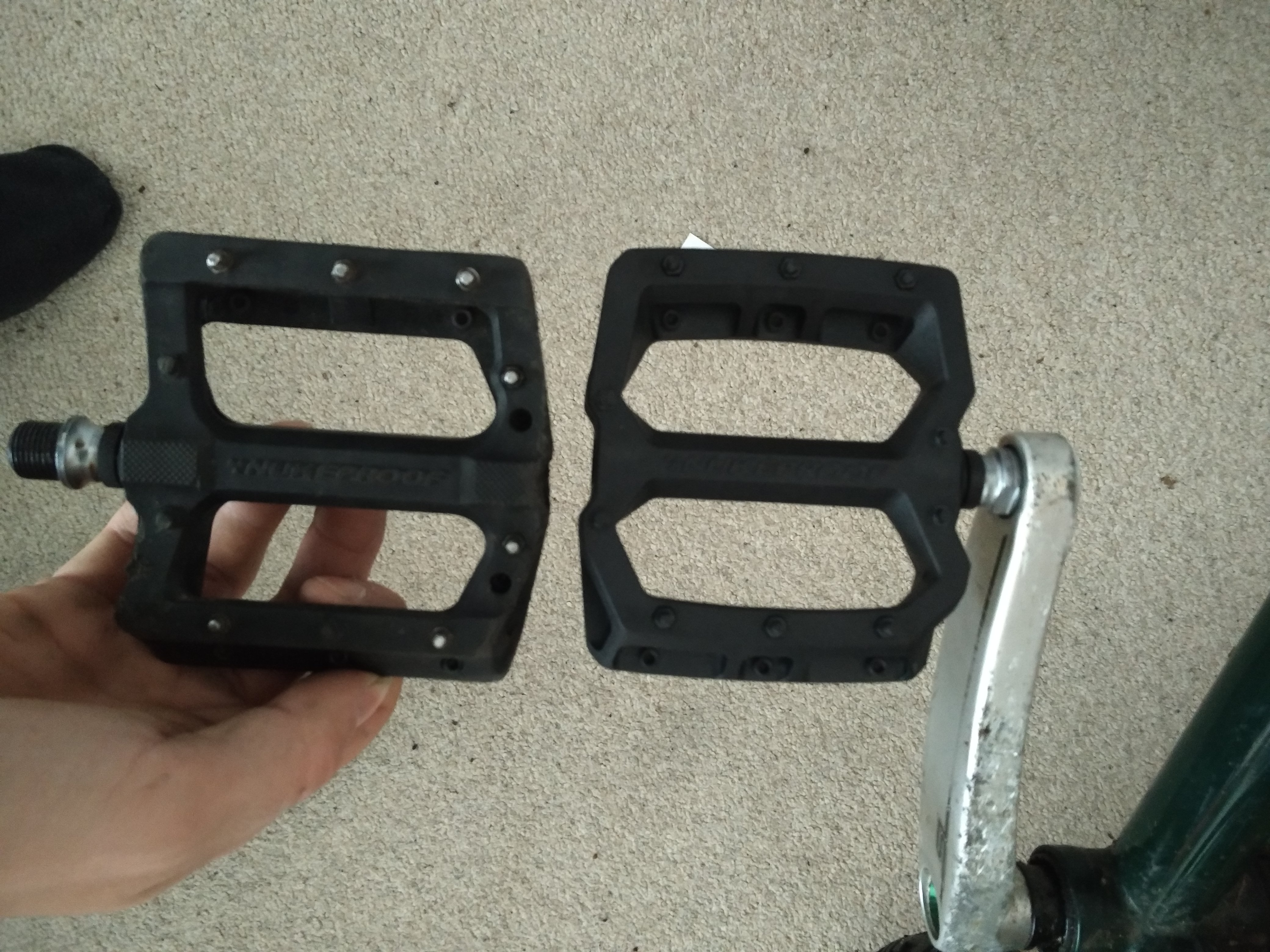

I've just upgraded from my plastic electrons to the new plastic horizons- it's rare that every fault with a pedal has been fixed with its successor, but nukeproof have done it.

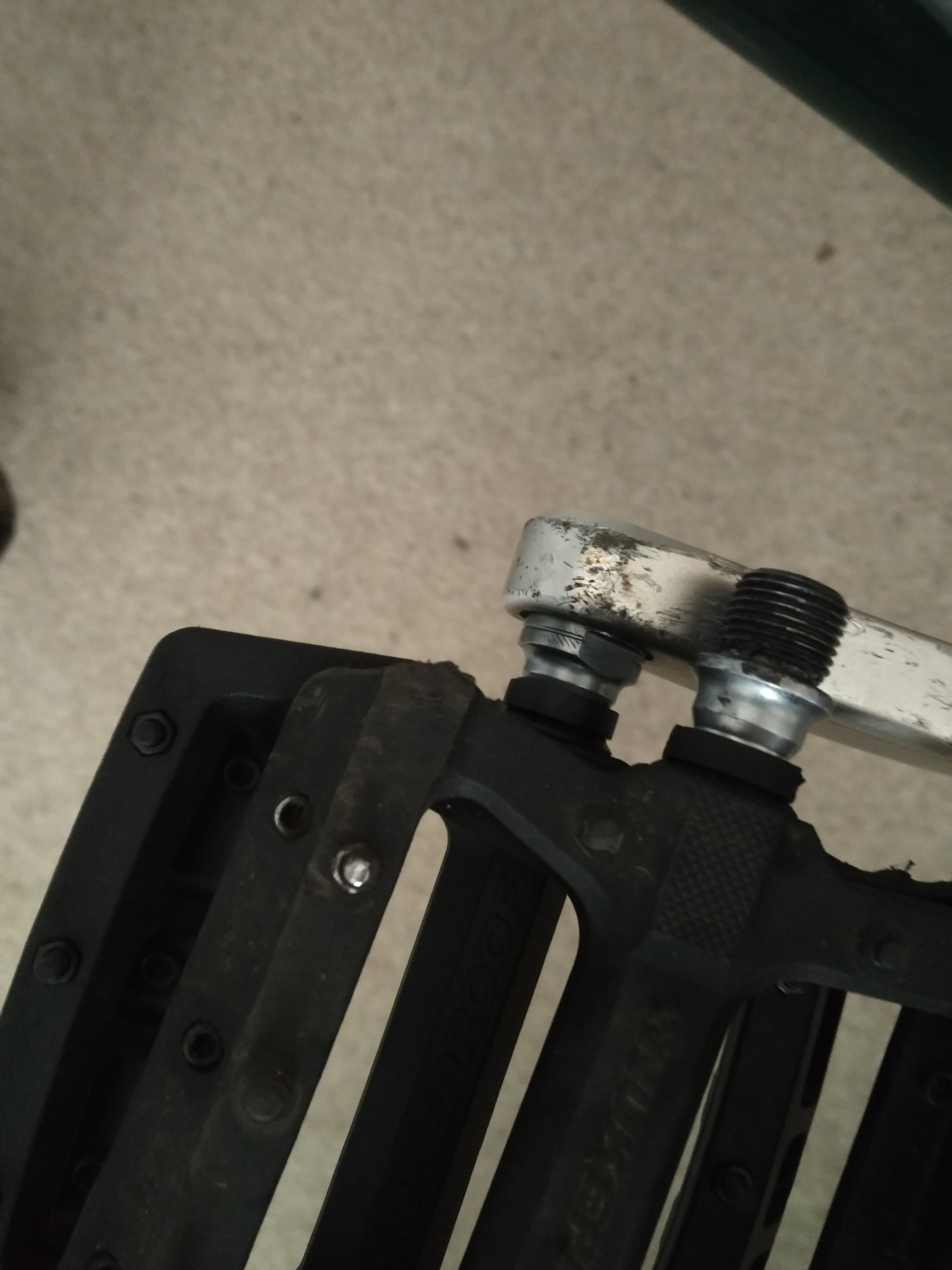

For starters: the plastic pins on the main platform have been replaced with metal, whilst the metal ones on the outer edge have been replaced with plastic. I broke the electrons outer metal ones on failed sidehops, and nukeproof have fixed that with the horizon and provided more central grip as a result.

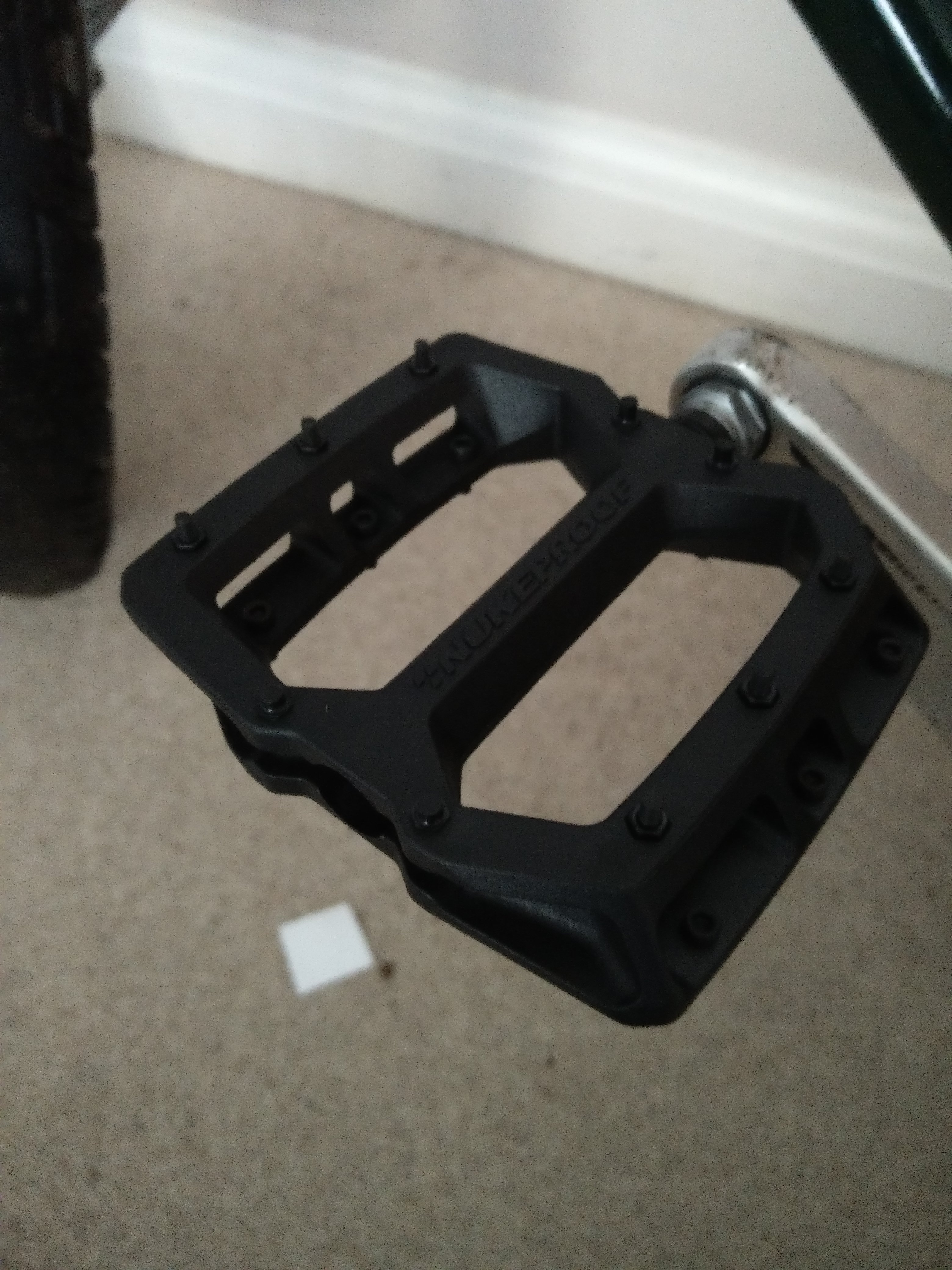

Secondly- the outer bolt with the nukeproof logo has been moved inboard on the horizon. (see pictures) I stripped the electrons as a result of failed sidehops and/ or the bike falling over (only my sidehops side pedal, though.) And nukeproof have fixed this issue too with a recessed bolt and a different pedal profile so the pedal body takes the brunt, not the bolt/ thread channel.
The super tough plastic body makes a return, as tough as metal pedals, and quieter when you crash and the pedals hit the ground.
And also a lighter pedal than metal equivalents.
They've added a spanner fitting as well as a Allen fitting on the horizon, which is handy as I struggled to get my electrons off via just a big Allen key, they'd been on there a while.
Fixings: 8mm Allen, 15mm pedal spanner, 6mm Allen.
Ill be stocking up on these.
Downsides: the pins on both are unforgiving and will ruin your shins.
Possibly more dirt build up in the horizons new recessed bolt channel.
