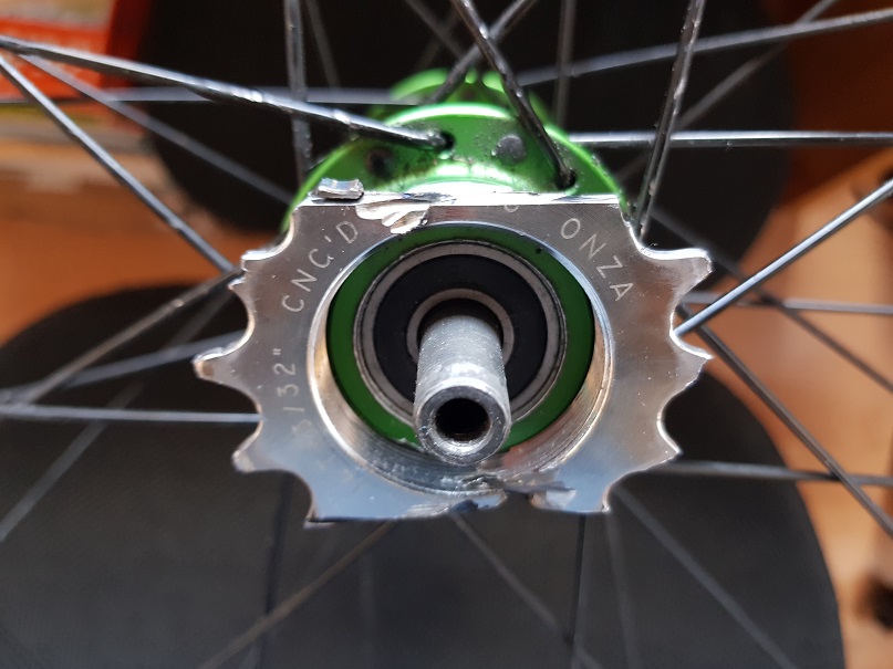

Managed to get the rear wheel off today and this is what I found:
As you suggested Mark the contact points of the hub spacers are pretty clogged up which can't help much with them gripping the frame. However whats more worrying is I seem to be missing 3 teeth from the sprocket! Don't know why I didn't check that before.
So looks like I need to get a new rear sprocket. Any ideas how I get this one off and any suggestions on a good replacement?
Nick
Thanks for linking the vid! Problem is i'm living in a flat at the moment and don't have access to a workbench or vice. Is there any other ghetto method to get the sprocket off? Tried with a chain whip but think that's a lost cause with it screwed on so tight. If all else fails i'll have to get the local bike shop to do it but i'd rather manage it myself if I can.
I think you'll struggle without a vice I'm afraid! Not unless you get adventurous with a dremel/angle grinder and sacrifice the sprocket (which is dead anyway) to get it off. You'd be risking damaging the hub though so probably asking nicely in Halfords if you can borrow their vice I'd say!!

So just thought I would post a quick update on my rear sprocket troubles. Tried a number of things to try and get it of but it was so tightly jammed on there it just wouldn't budge. With no access to a bench vice, in the end I went with the suggestion from monkeyseemonkeydo and got someone handy with an angle grinder to go at it.
Worked away at the metal on both sides a bit at a time until almost through to the thread. This freed it up enough to get it moving with a hammer. Was a bit worried about damaging the threads on the hub so I wouldn't recommend doing it this way but it came off pretty unscathed.

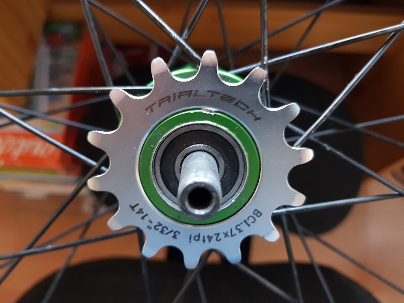

Took delivery of my new Trialtech sprocket today which is a direct replacement and went on without any trouble. Haven't had a chance to get out for a ride yet but i'm pretty confident this should solve the problems I was having.
Just wanted to say thanks for all the help getting this problem sorted!

Soooooo another update. Went out for a ride the other day and the problem remains :'( In fact it seems to have gotten worse!
The chain coming slack doesn't seem to be happenning anymore but the loud bang when doing pedal kicks and the skipping seems to be happenning more frequently now. I actually think it may have been 2 separate problems, the chain coming loose was down to the rear wheel and the sprocket which seems to have been rectified, but I think the skipping and noise it makes is a problem with the FFW. I've been reading more about the stock Zoot freewheels and this also seems to be quite a common problem. When I rotate the crank backwards it also feels like something is grinding as I can feel some resistance.
Any ideas what I can try next? Should I remove and strip down the freewheel and see what it looks like? Any guides anywhere on how to do this for an FFW?
