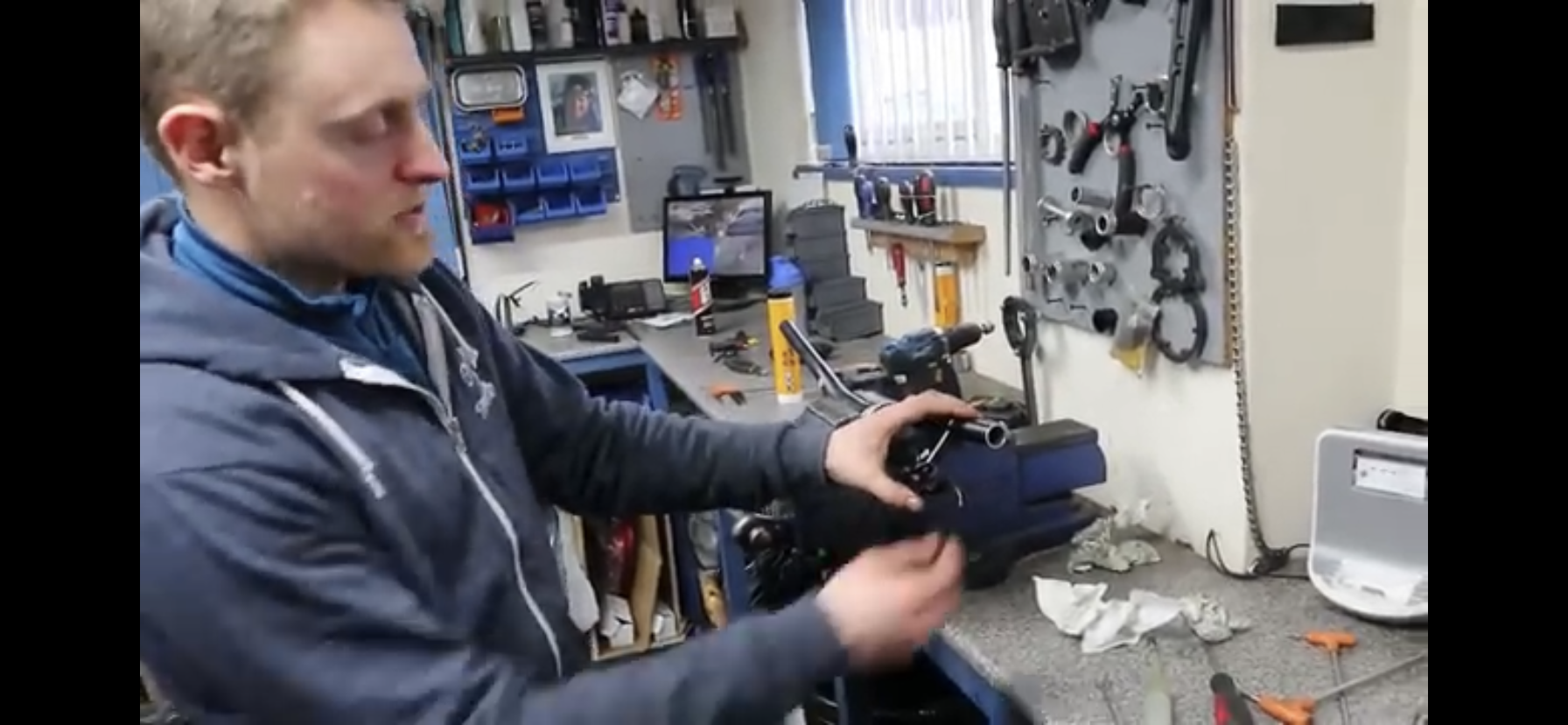

AndyT Posted February 9, 2023 Author Report Share Posted February 9, 2023 thanks for the replies. Someone found a deep ali c video with the real tart showing what I was hoping to find... I swear this was a normal huge thing when it came out but no where to be found anymore... Ancient lost technology Basically after you bleed- theres always air still somehow in system. I bleed on bike, with lever in top position- slaves lower on a stand. After normal bleed - close everything, open the lever port. Put a syringe in that side- add some liquid, pull the lever blade gently and air will come out. you will see it.. Ali C says " doing this for years" and they agree it is the greatest thing to do for hs33... but as we see in this thread, loooooost technology!! ahahah... Quote Link to comment Share on other sites More sharing options...
Mark W Posted February 9, 2023 Report Share Posted February 9, 2023 1 hour ago, AndyT said: After normal bleed - close everything, open the lever port. Put a syringe in that side- add some liquid, pull the lever blade gently and air will come out. you will see it.. Ali C says " doing this for years" and they agree it is the greatest thing to do for hs33... but as we see in this thread, loooooost technology!! ahahah... On 2/8/2023 at 11:44 AM, Mark W said: Doing a proper bleed will give the best chance of removing any air from the system, and if you think there might be any left in there doing a quick top-up bleed at the lever should resolve that. That's what I mean by doing a top-up bleed. Also works really well on Magura disc brakes too thanks to the EBT bleeding setup on their levers. 1 Quote Link to comment Share on other sites More sharing options...

Canardweb Posted June 21, 2023 Report Share Posted June 21, 2023 (edited) Ok so I tried bleeding my brakes thanks to this video: My brakes are brand new and just had their levers swapped to some Carthy Trialtech ones so there were still some magura oil with the cooling liquid used by Crewkerz. I used cooling liquid and did the pump trick to evacuate as much old liquid as I could. I did the normal bleed and the top trick and my levers are still not engaging instantly. Tried the top trick again and it's better but not quite there yet. I will leave it tonight and hope for the air bubbles to come up but I just keep getting some coming up the hose no matter how long I try... Will leaving it overnight help? Anyone has a clue on what could be wrong? Thanks Edit: just tried the top trick again and it's definitely better but not 100% there. I am kind of anal with brakes as I want it to be perfect and there is clearly a part of the lever strike that is compressing some air before liquid. I will try again tomorrow after leaving the brake rest overnight and I hope for the best. I still take any adviced that could be given anyway. Edited June 22, 2023 by Canardweb Quote Link to comment Share on other sites More sharing options...
AndyT Posted June 23, 2023 Author Report Share Posted June 23, 2023 (edited) On 6/21/2023 at 10:21 AM, Canardweb said: Ok so I tried bleeding my brakes thanks to this video: My brakes are brand new and just had their levers swapped to some Carthy Trialtech ones so there were still some magura oil with the cooling liquid used by Crewkerz. I used cooling liquid and did the pump trick to evacuate as much old liquid as I could. I did the normal bleed and the top trick and my levers are still not engaging instantly. Tried the top trick again and it's better but not quite there yet. I will leave it tonight and hope for the air bubbles to come up but I just keep getting some coming up the hose no matter how long I try... Will leaving it overnight help? Anyone has a clue on what could be wrong? Thanks Edit: just tried the top trick again and it's definitely better but not 100% there. I am kind of anal with brakes as I want it to be perfect and there is clearly a part of the lever strike that is compressing some air before liquid. I will try again tomorrow after leaving the brake rest overnight and I hope for the best. I still take any adviced that could be given anyway. I'm months and months later, Just get used to it having zero feeling just pull it into mush and it is on, it never slips- it feels like absolute trash but i think thats all it is now... solid hand to bar like ur holding a bar, no extra effort for your finger to oull thr brake... mush. Made for women n childrens hands Edited June 23, 2023 by AndyT Quote Link to comment Share on other sites More sharing options...
Canardweb Posted June 23, 2023 Report Share Posted June 23, 2023 Hey, I finally managed to get a perfect bleed out of both my front and rear levers. They feel nice but HS33 is not my cup of tea. They are noisy, ever so slightly slippy if you hop backwards, and require too much maintenance to stay at their highest standard. I just want V-brake but it seems difficult as I can't find adapters anywhere. Quote Link to comment Share on other sites More sharing options...
