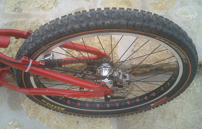

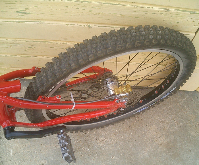

Ok first off if I were to run a 24x65mm rim on my Koxx Levelboss 1100 frame then there would be no problem in fitting it in the chainstays. Cause remember the chainstays get WIDER the FURTHER away from BB you get not NARROWER (BB is 68mm and rear hub is 135mm).
Now would running a heavier tyre solve my problem? Yes but no but yes but no...
Err I am using a Kenda 2.5 Nevegal which is 1150g it is already beefy not as stiff as say those silly mod tyres (19"x2.6 1100g) but as stiff as say a highroller 26x2.5. With this tyre on my 38mm rim i still feel some tyre flex which is why i want a wider rim. Perhaps all I really need is a 24x47mm rim (Kris holms) but I find the ideia of going 65mm very appealing (-the cost).
As for going stiffer than the normal DH tyre well I don't think you have much choice say apart from Intense but they only make a 24x3.0 which i find TOO heavy. Nokian Gazzaloddi though taller and slighly heavier (the 2.6) are don't have a stiffer casing than the kenda. I have had one and I find the rubber durometer to be too hard. The Nokian 3.0 is better (super cushy like a mod rear tyre) but too heavy.
Then there also the fact that I think a 1100g tyre is too heavy for natural anyways (what I mainly do)! So for natural i run a 600g tyre which of course flexs even more than the Kenda! So its either cough up the money and go 65mm and after drilling still add a few hundread grams to the bike or go 47mm save some dough and forget that i could have gone 65mm :P
I think the money is what is going to decide this in the end or my lack of it! haha

And I have got a Maxxis Highroller 24x2.5 and on my 38mm I still feel flex on it! post-1103-1168346330_thumb.jpg
But yeah 47mm maybe sufficient...
