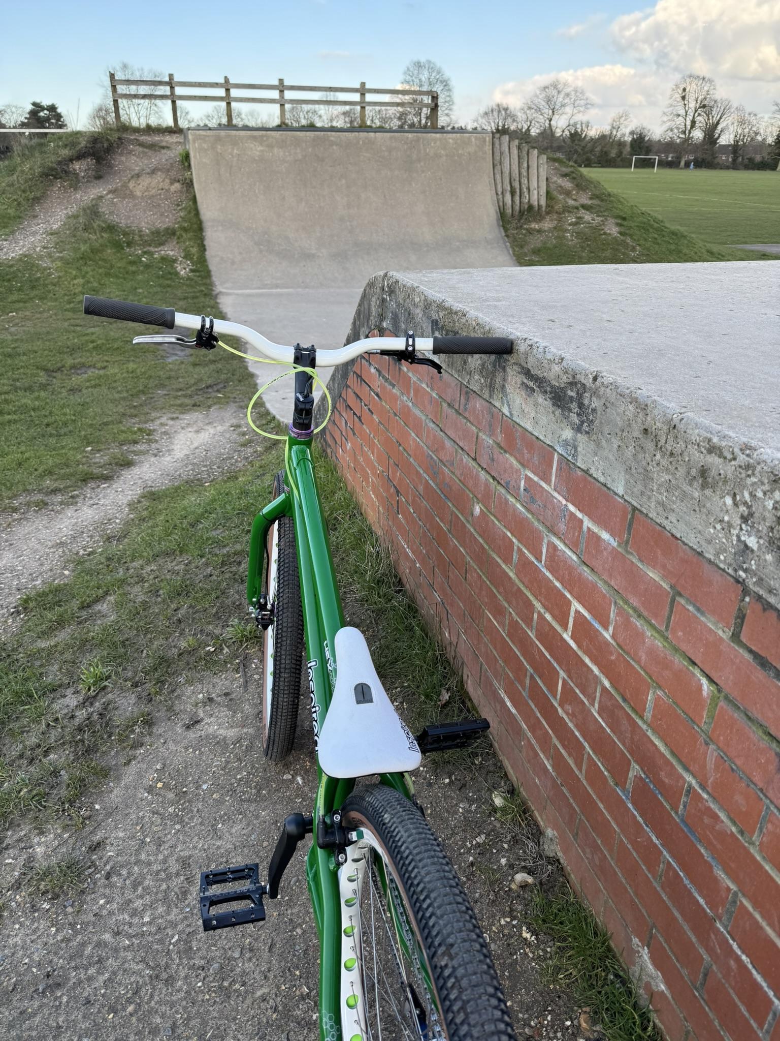

Bit of sunshine tinkering on the Mk 1 Hex.. even got it out to a skatepark for an hour in the sunshine!

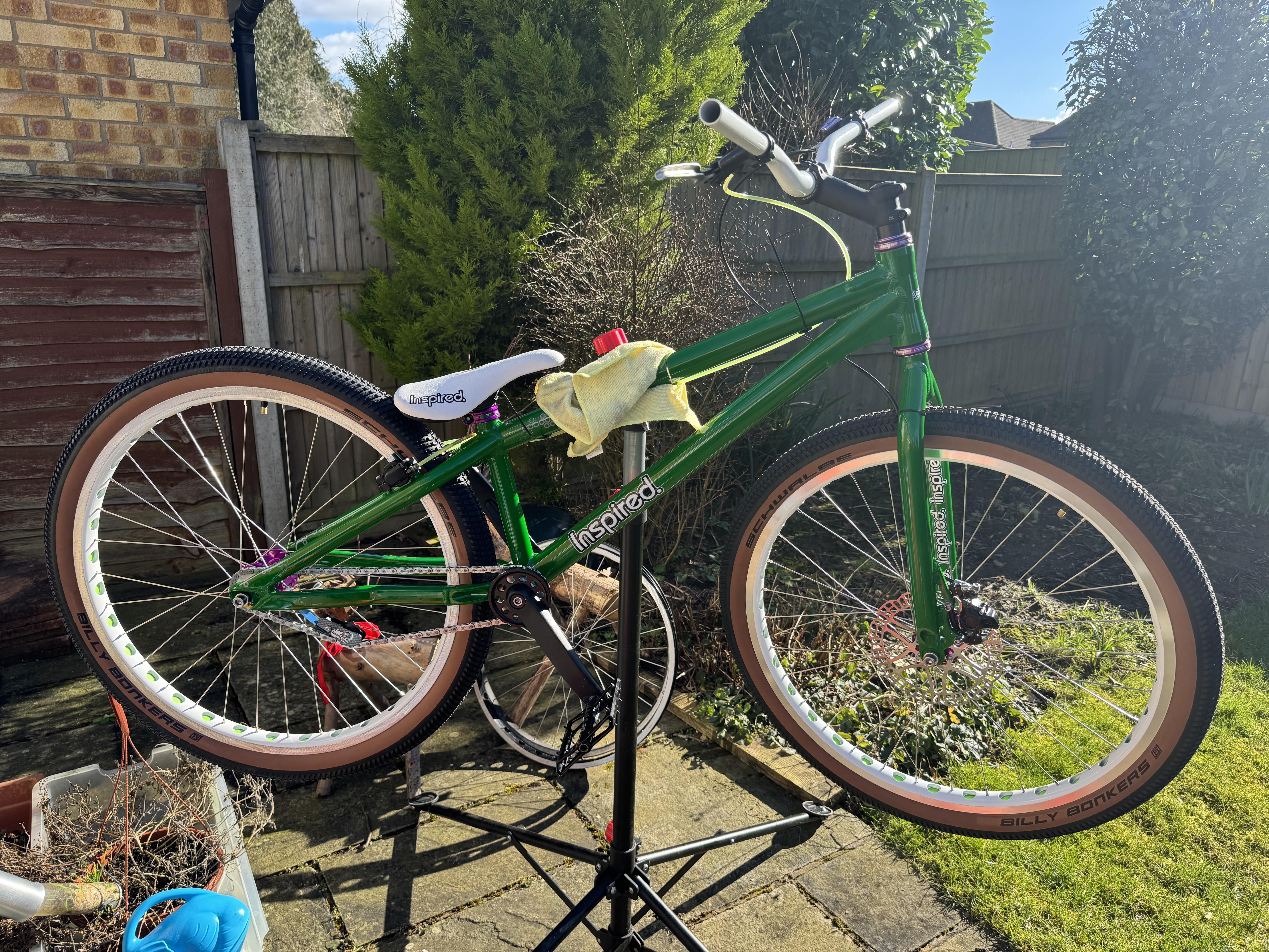

Finished!! Took a little longer than it should have - ended up swapping out the Zee for MT7s as the rear brake wasn't holding a bleed and needs some investigation!
