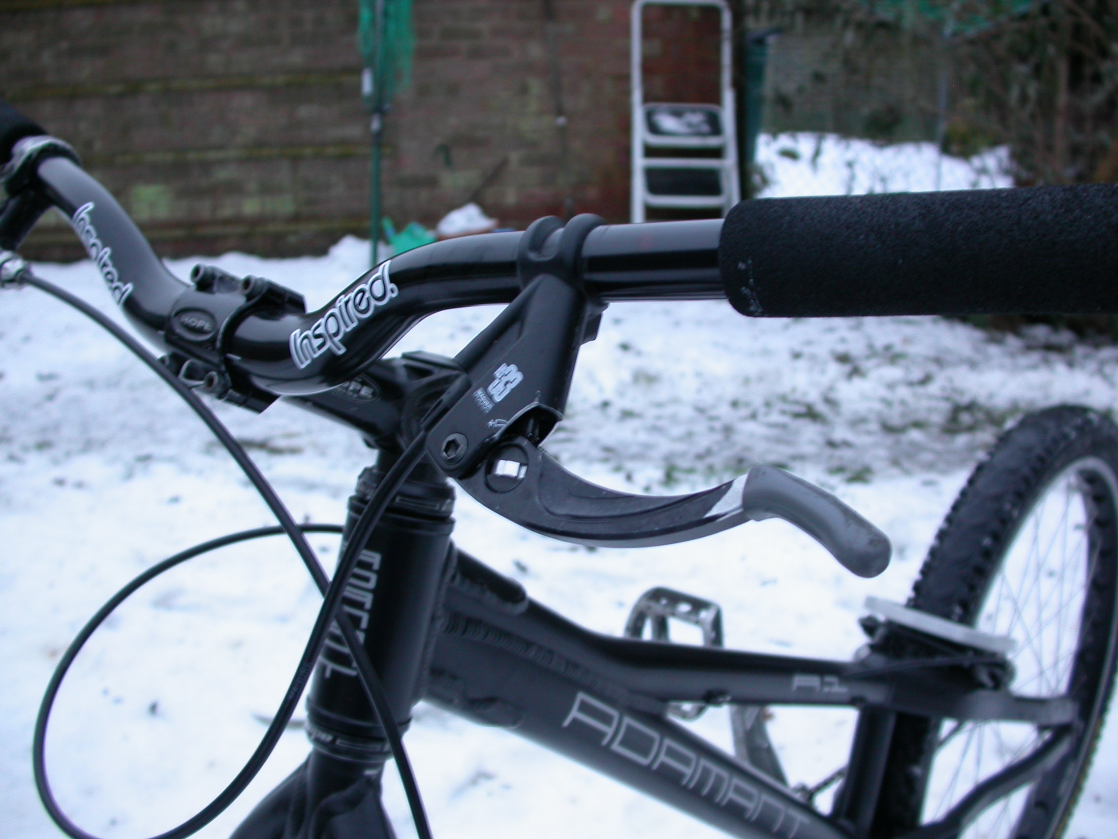

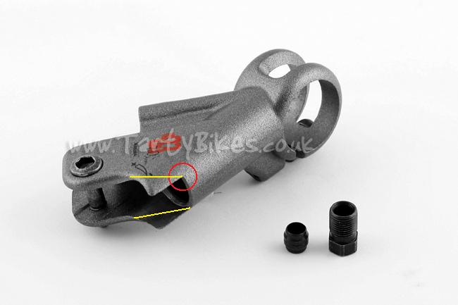

The reason they crack is the sharp 90° bend (red circle in the photo below) concentrates any stress going through the lever to that one point (a stress riser). Anything from a crash or knock to the lever, or even just pulling the brake hard will create a lot of stress at that point, this is why they crack so easily. This is also why they are so much stronger once they have been modified. Cut the lever (yellow lines in the photo below) and file the metal so it is smooth, removing the sharp edge/corner. This removes the stress riser so any force going through the lever is spread evenly across its edge, no more cracks! The second photo shows my lever.
It still makes me laugh when people complain about magura levers cracking. My current lever has lasted nearly 5 years, I cut it with a hacksaw on day 1 which took about 5 mins max!
