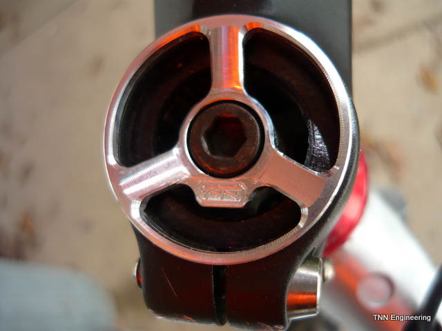

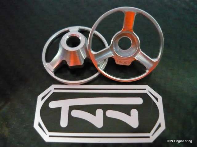

Hi all, I just like to show off the new TNN Engineering ultra light stem cap. Proudly CNC machine in Australia from 6061 Aluminum. Made with just as much care and expertise as all of the TNN products. Tested to triple the max recommended headset torque settings. It a easy way to add bling and save some grams. Competition rules are as follows. Guess the Stem cap weight to 2 decimal places. E.G 2.58 grams 3 Stem caps to give away closest 3 guesses win. One guess per person and no editing of guesses allowed. The competition will end on Monday morning 6th of July. Here's a clue the stem cap weights between 2 and 4 grams. Good luck! They'll be in store the same time the competition ends.
