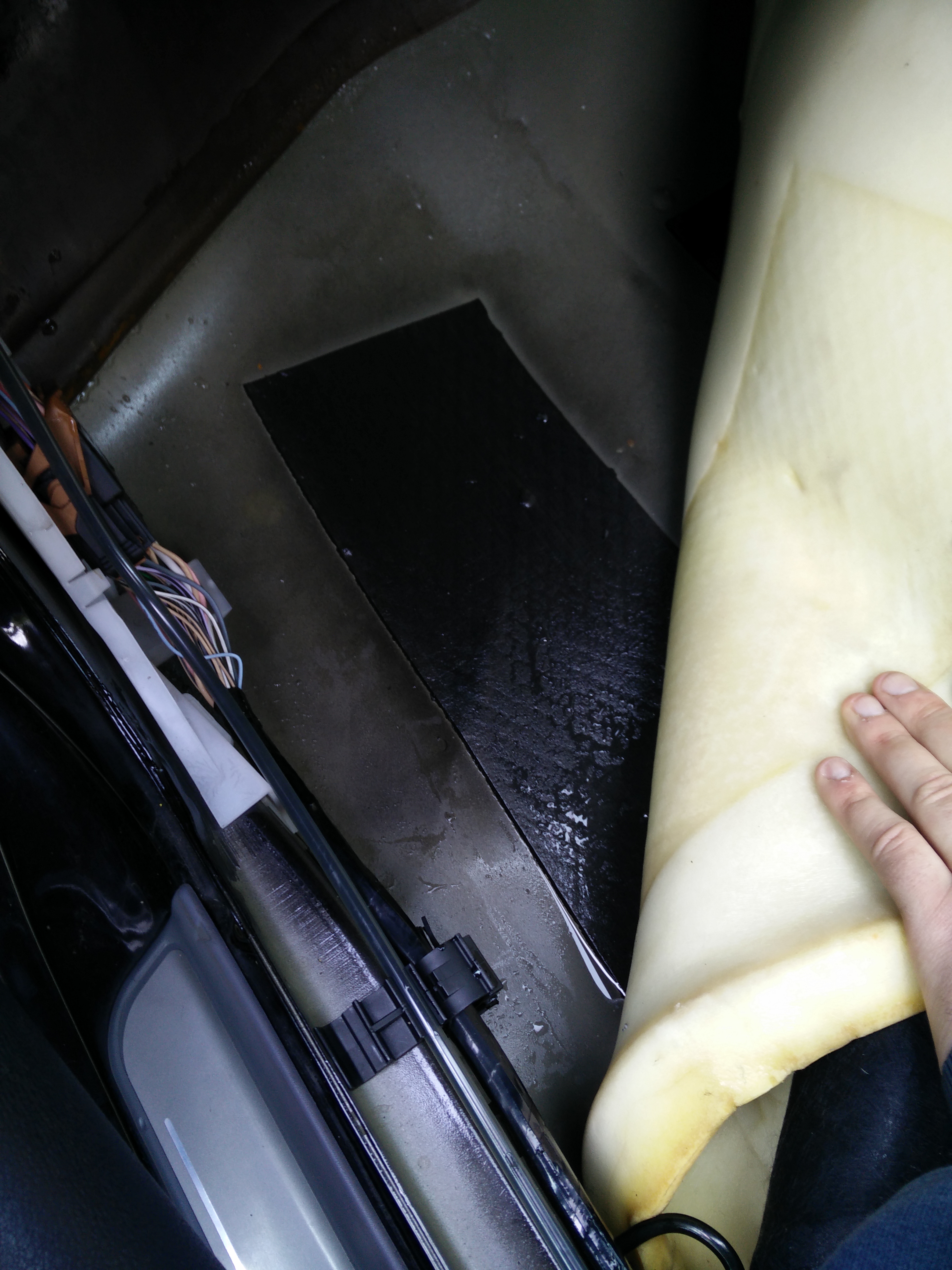

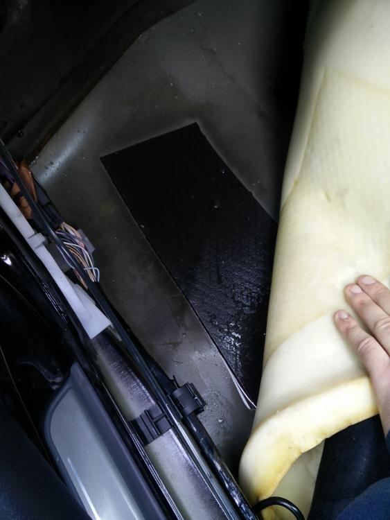

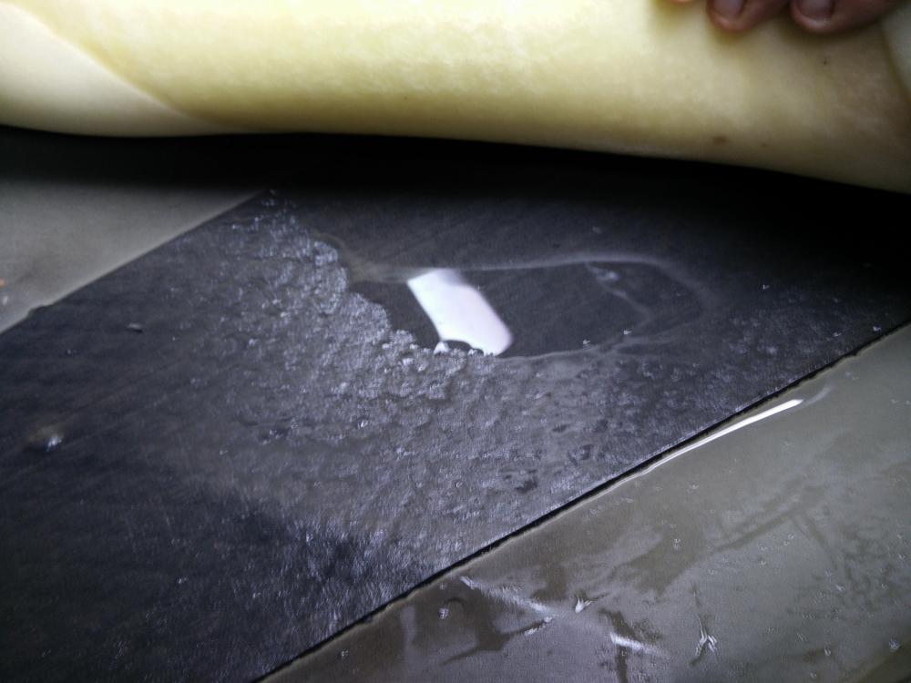

Day two stalemate. Car still lets water in Shitty wiper puller f**ked the threads on the passanger side of the wiper assembly The washer bottle now pisses all fluids out of itself within a minute or two from full. Despite pushing the pumps all the way in. I f**king hate this French sack of shit. Should I just go down the route of drilling a hole in the floor?
I did but was curious to what people had to say on here, I believe I've tracked it down the the rubber grommet that goes In to the firewall for the rear washer tube. Cut the fanny out and sealanted over the hole. It's drying, will know for sure tomorrow! Good excuse to get the carpets out I suppose and get it stripped! Got anything left for sale Dan?
So water is getting under my passanger seat, so have done the normal by checking the little plastic gromits near the rear lights, and clearing out the scuttle panel and all the crud that was in the arch liners. To no avail. Also it's not the heater matrix. And its only on the passanger side. I've checked the rear washer line, and it's bone dry so water can't be running down that. All the water is sitting under the passanger seat and foot well. The sound deadening sponge is sodden.
