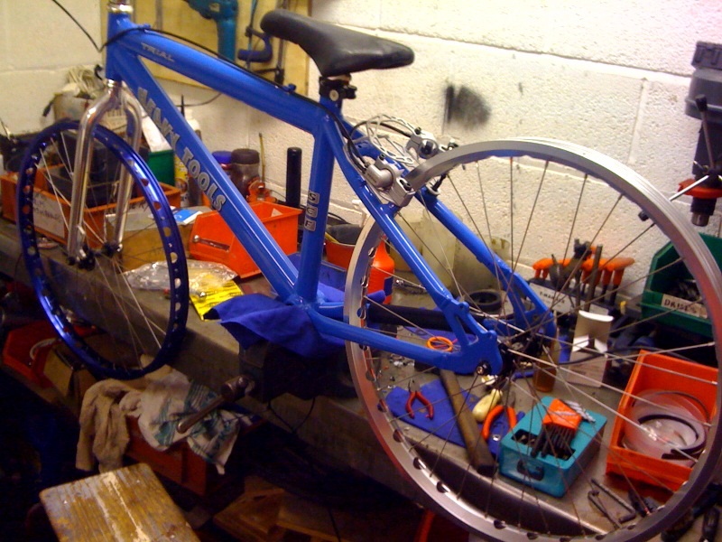

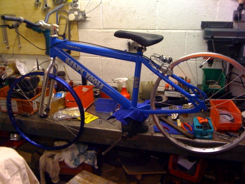

  1. Nah I know the difference between chain skipping and not. Gonna get the freewheel de-greased this weekend as per the info from the other replies and will see how it goes then!

  4. Finally finished! Full spec is: Heavy Tools Trials Frame Unbranded forks Echo TR hubs and rims Specialized stem Azonic World Force riser bars FSA headset Hope mono mini front disc HS33 rear rim brake Tensile offset magura mounts Magura Evo2 mount kit Inspired grips Try All ISIS B/B Trialtech Sport Forged cranks Trialtech Race Platform pedals Echo SL 108 freewheel Trialtech Lite Z610 chain Try All single speed tensioner Because CNC bashring IRC Kujo on back and El Gato on front Think thats it, pics! Think I may soon go for some different bars and a higher longer stem!

  7. After months of waiting for the funds to arrive I've finally managed to get my heavy tools built up this afternoon with all my lovely new kit from tartys. The only problem I've got however is the freewheel I got, Echo SL108, is absolute shite! I don't if its just me or the fact its new but it skips like mad! Not even putting much power down like when I rode the bike down the road it still skipped, now is this cause its new, cause I've not fitted it tight enough or simply that it may be faulty? Need help guys as it may have to go back! PS. Will get pics up shortly in pics section!
