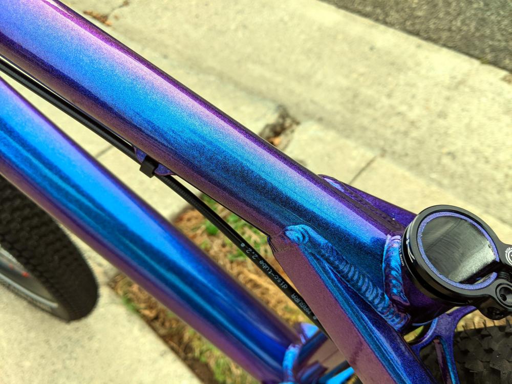

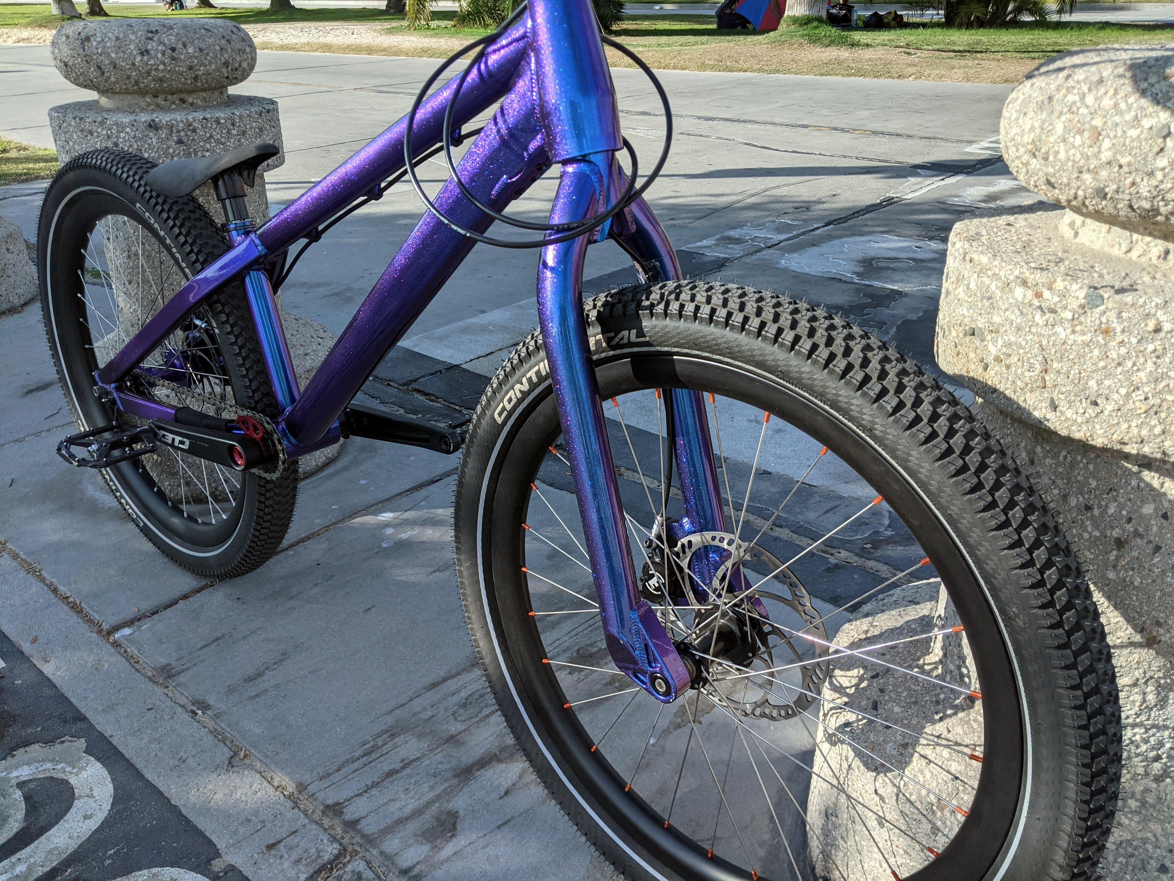

  18. The story I was told was that when Echo closed recently, all the remaining stock, whatever state it was in, was sold off. This particular frame set had been painted, but had not yet received decals and was sold as is. It came to my attention in a Japanese shop labelled as just a Czar Neuron Pro, but this color was only used on the limited edition version with the BB30 bottom bracket. Since my first trials bike back in 2009 was a Czar, I though it would be fitting that I should get my hands on possibly one of the last Czars. Now with the first build out, I'm struggling with the best accent color to finish it just so. The absence of decals also makes the 'bass boat purple' really dominate. I had hoped that tiny orange accents would work, mostly because I already had a spare wheel with orange nipples, but orange isn't quite right. The Clean cranks have the heavily overused red accents, but I have to say the red is actually growing on me. The rear hub is my trusty Profile Elite from my Ozonys Iron build back in 2015 and it's purple so it will have to do for now even though that makes for a lot of purple. I tried gold and silver bolts all around, but they weren't the right colors either. Might need some stickers to break up all that galaxy purple. Had my first real ride on it today; so much fun. I'm gonna miss Echo.
  19. I've got something pretty special in the workshop right now. I'm still in the process of figuring out the accent colors and awaiting parts to complete it. Full story when I have the first rough draft to show.
