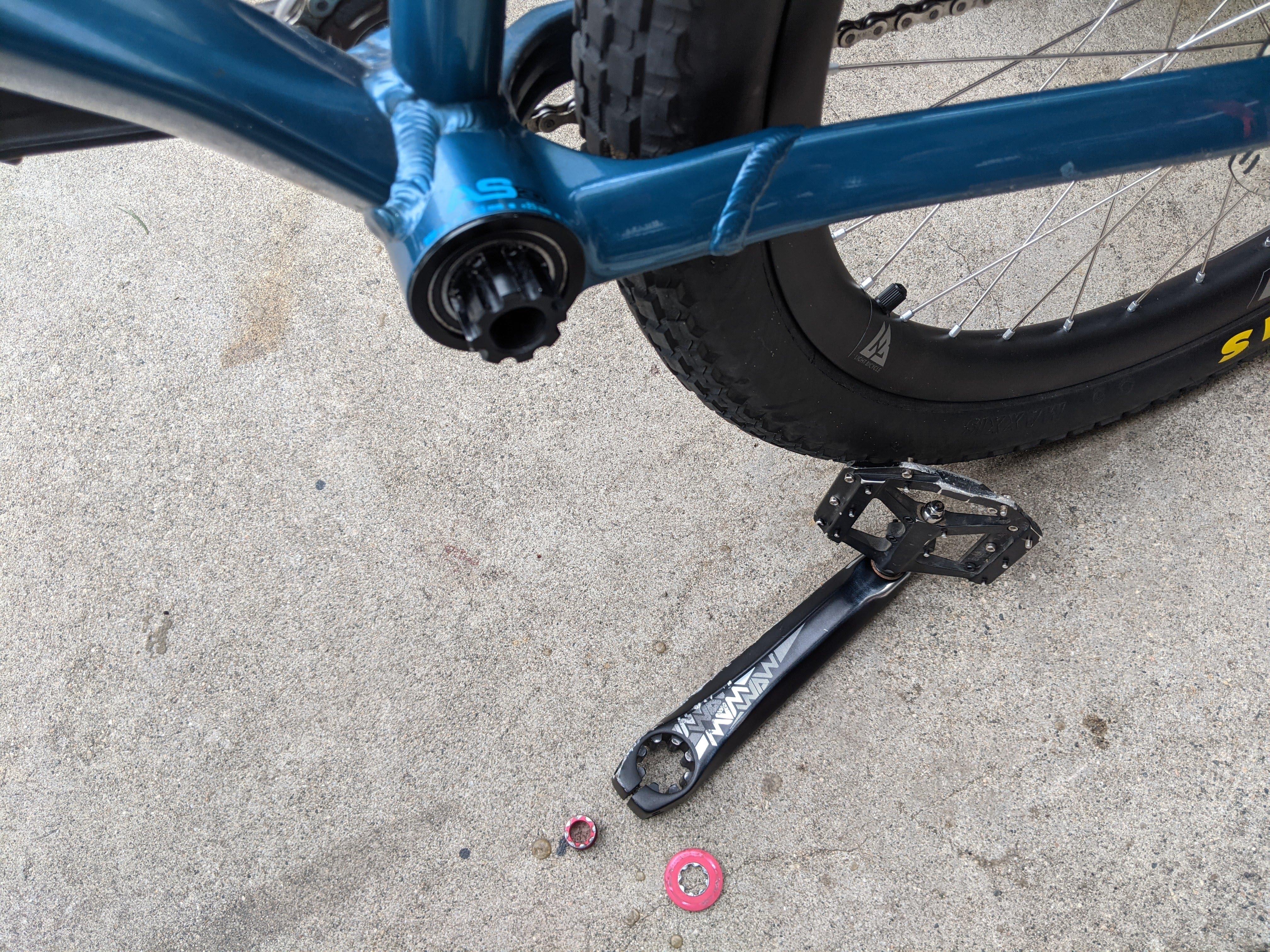

Apparently I've been living under a rock. A simple google search revealed that there are tons of M18 crank bolts out there; in every material imaginable. I guess it was figuring out that it was an M18 was the real trick. Thanks again guys!
Thanks guys! After seeing how thin the connection is now that it's broken, I think I might upgrade to the TT. It lasted a year at least.
Has anyone else broken one of these while riding? It wasn't over-tightened when installed and it must have snapped recently as it was barely holding on when I noticed it was askew in the crank today. I've ordered a replacement, but I wonder if it will just happen again. My screw finder doesn't go up to M18 (i think it's an M18 anyway). Does anybody know what size bolt and thread pitch would make a steel/ti replacement for it?

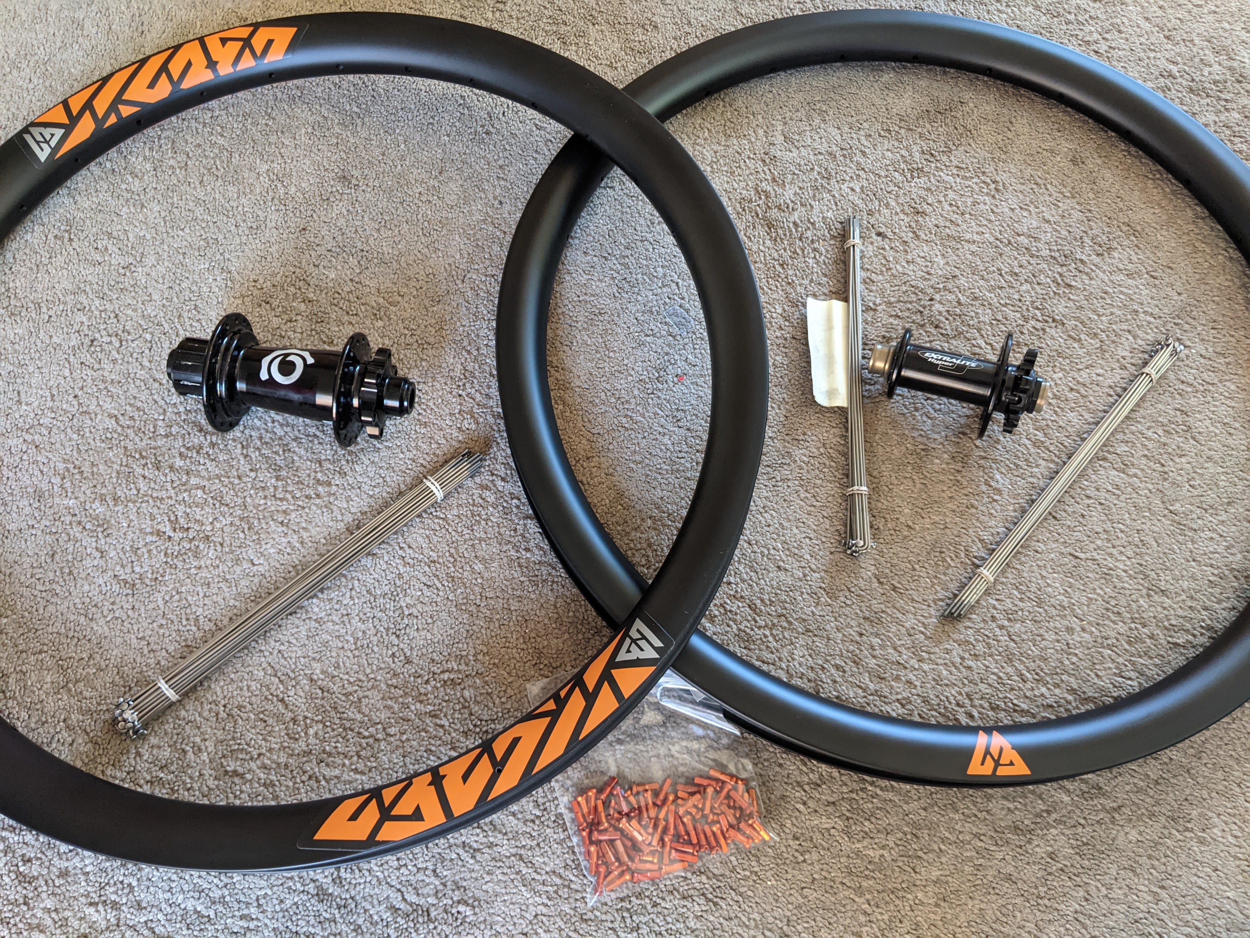

Time for new wheels already! The ebay gods were particularly nice to me so i rolled that windfall into some carbon wheels for the Marino/Silex. I looked into BERD spokes after reading Adam's thread about them, but the pre-made spokes only go as short as 240mm and I didn't want to go 4x fo make up the extra length and NO WAY am I gonna splice and solder my own. Who's go that kind of free time these days?!? Anyway, new wheels. Industry Nine Hydra to Lightbicycle Recon 24 and Extralite Hyper JF to Lightbicycle Moto Cruiser 24 with Sapim spokes and nips.

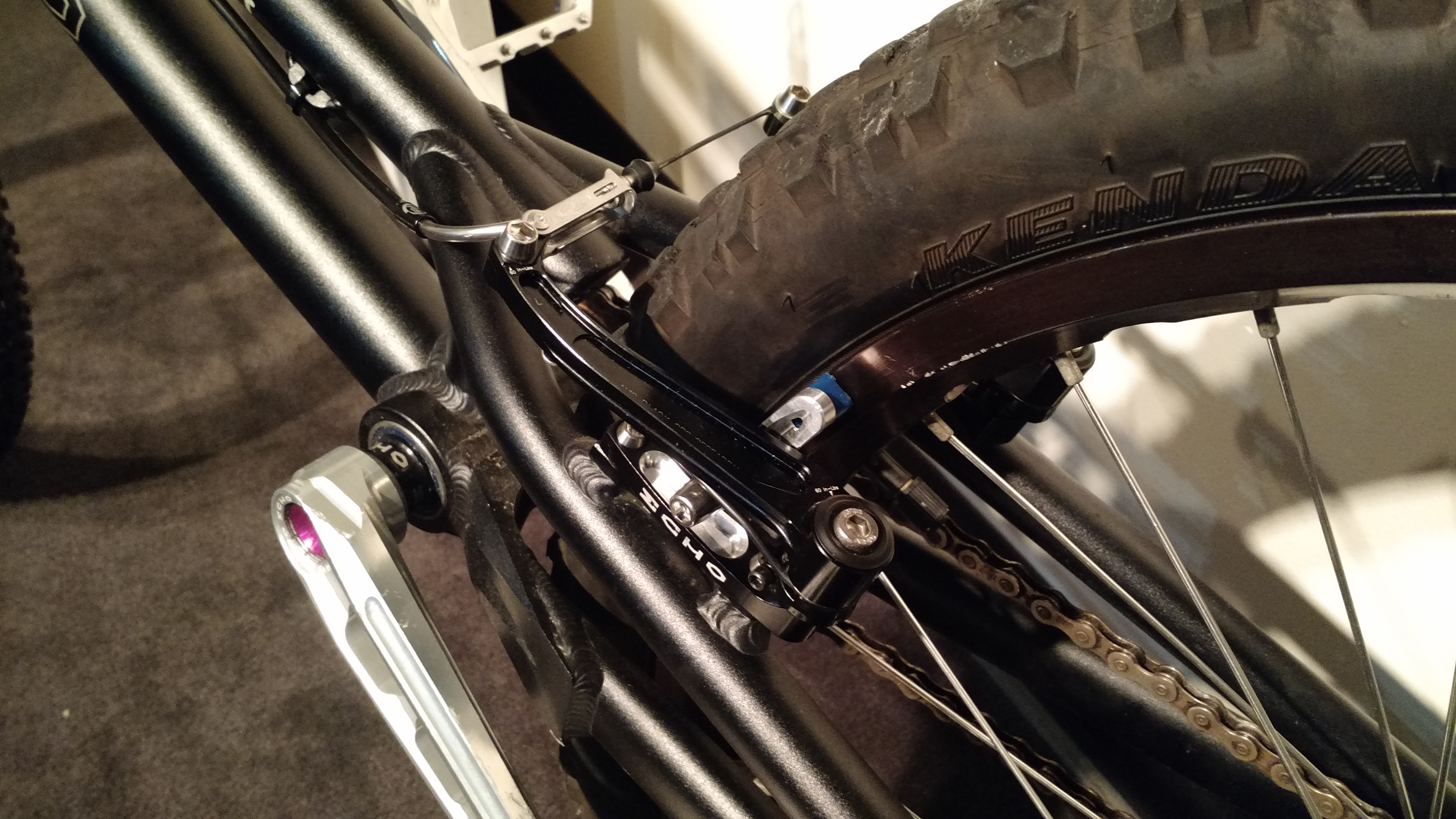

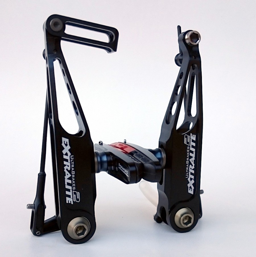

Avid ultimates were once the gold standard in V brakes and they're still top notch if you can find any. Extralite makes some CNC box section Vs that are probably ridiculously stiff, but the price is pretty stiff too. If you can minimize/eliminate the slop at the pivot and you're using really good cable and housing (housing cut with perfectly square ends!!) most V arms will be plenty. On my last pure trials V brake setup, (Avid ultimate arms & levers, Odyssey linear cable) the only 'squish' was in the Heatsink blue pads I was using (I didn't want to grind the rim).

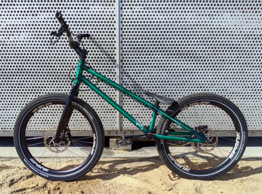

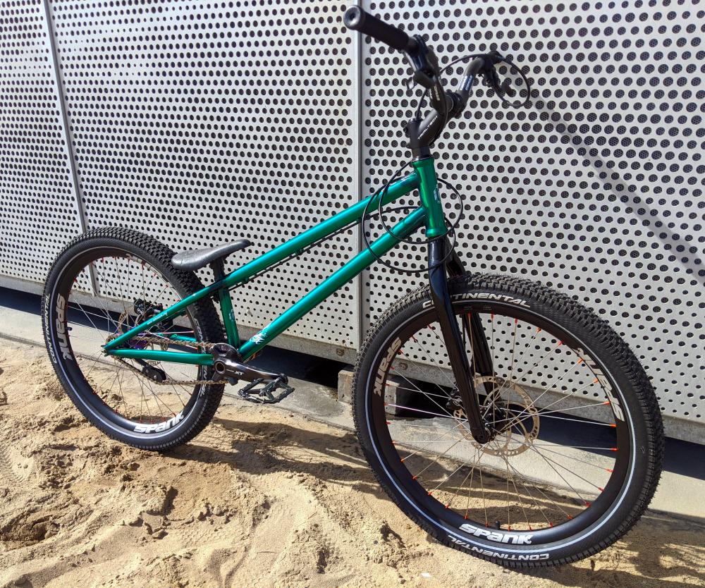

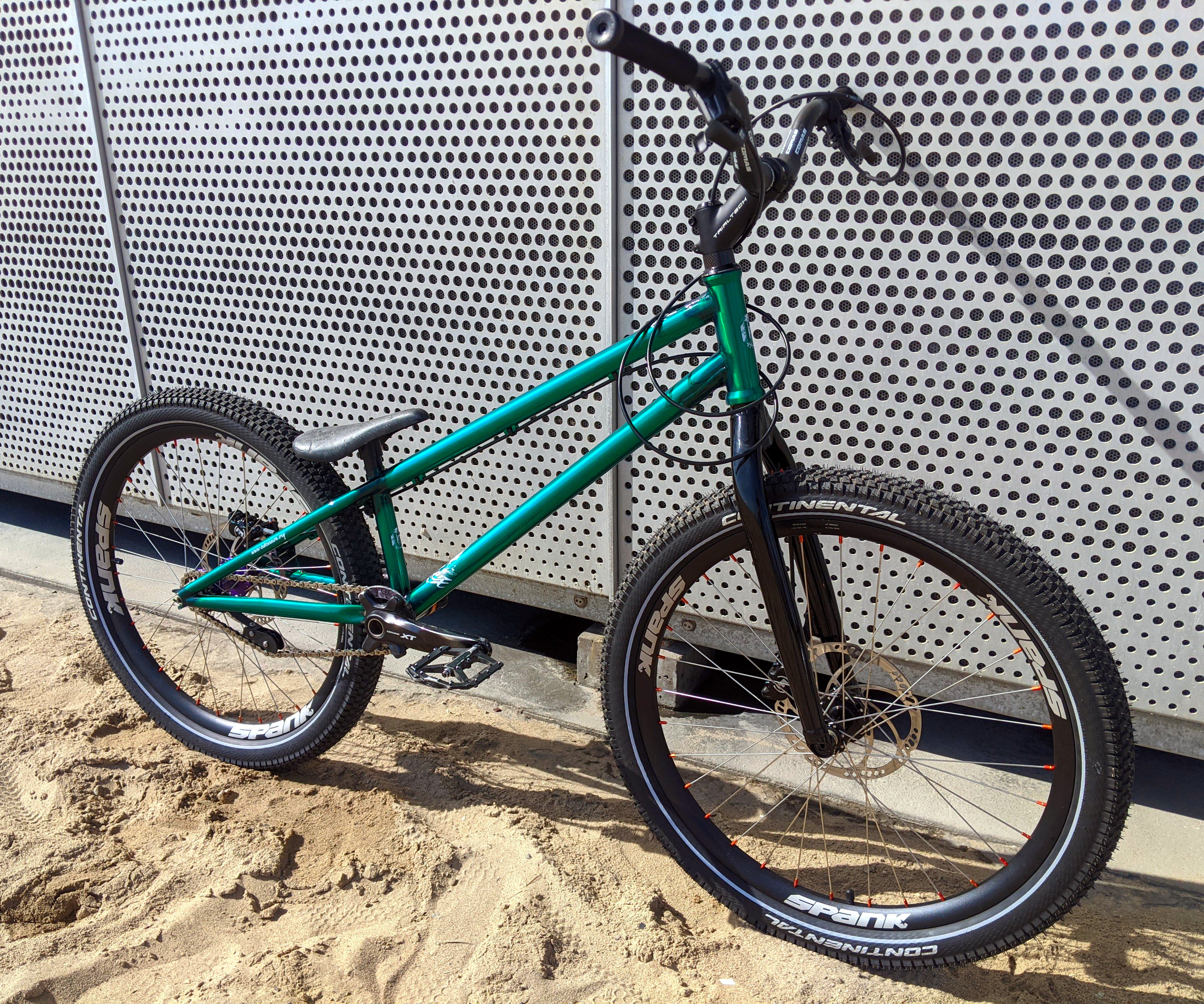

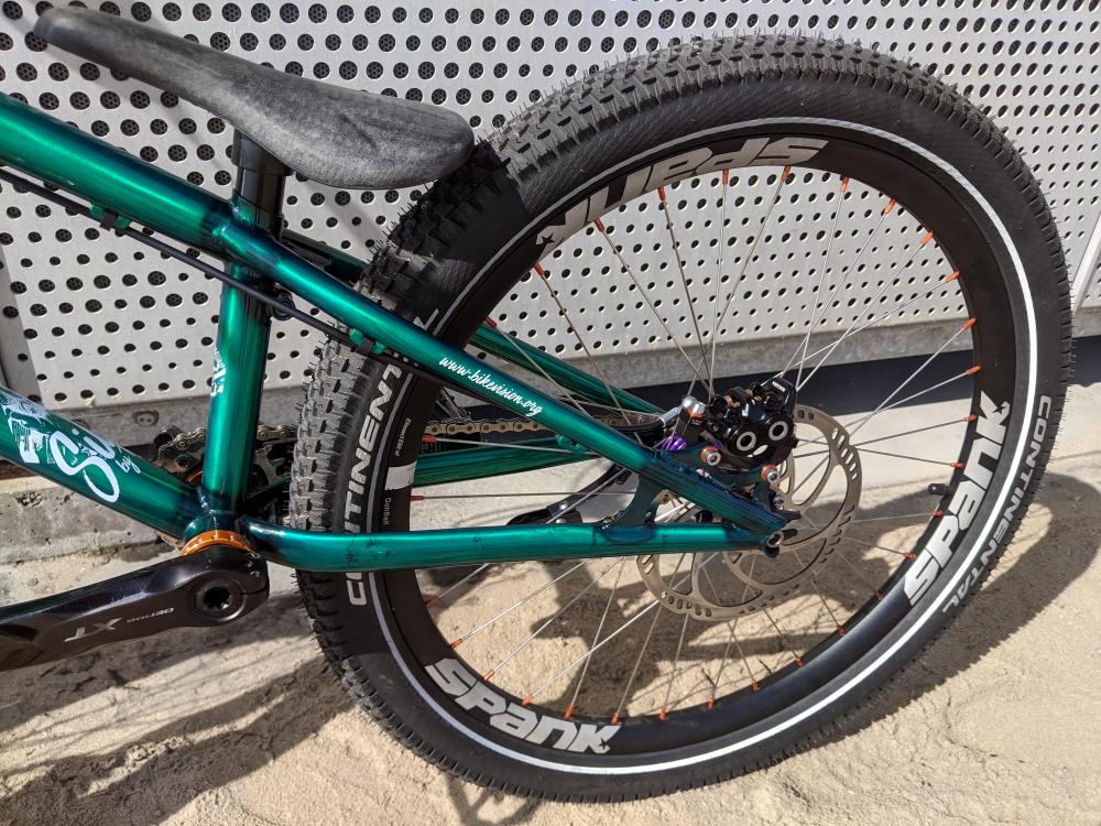

So apparently I'm not a very patient person. I'd wanted one of these Silex frames so I took the opportunity to use all those 'Marino' spare parts and build one. I've been riding the skatepark more lately so I wanted to spare my Guilty from the abuses that brings. That's how I billed it to my wife anyway. First impressions are pretty good, but I'm glad I got the Guilty and not one of these. Guilty wins hands down.

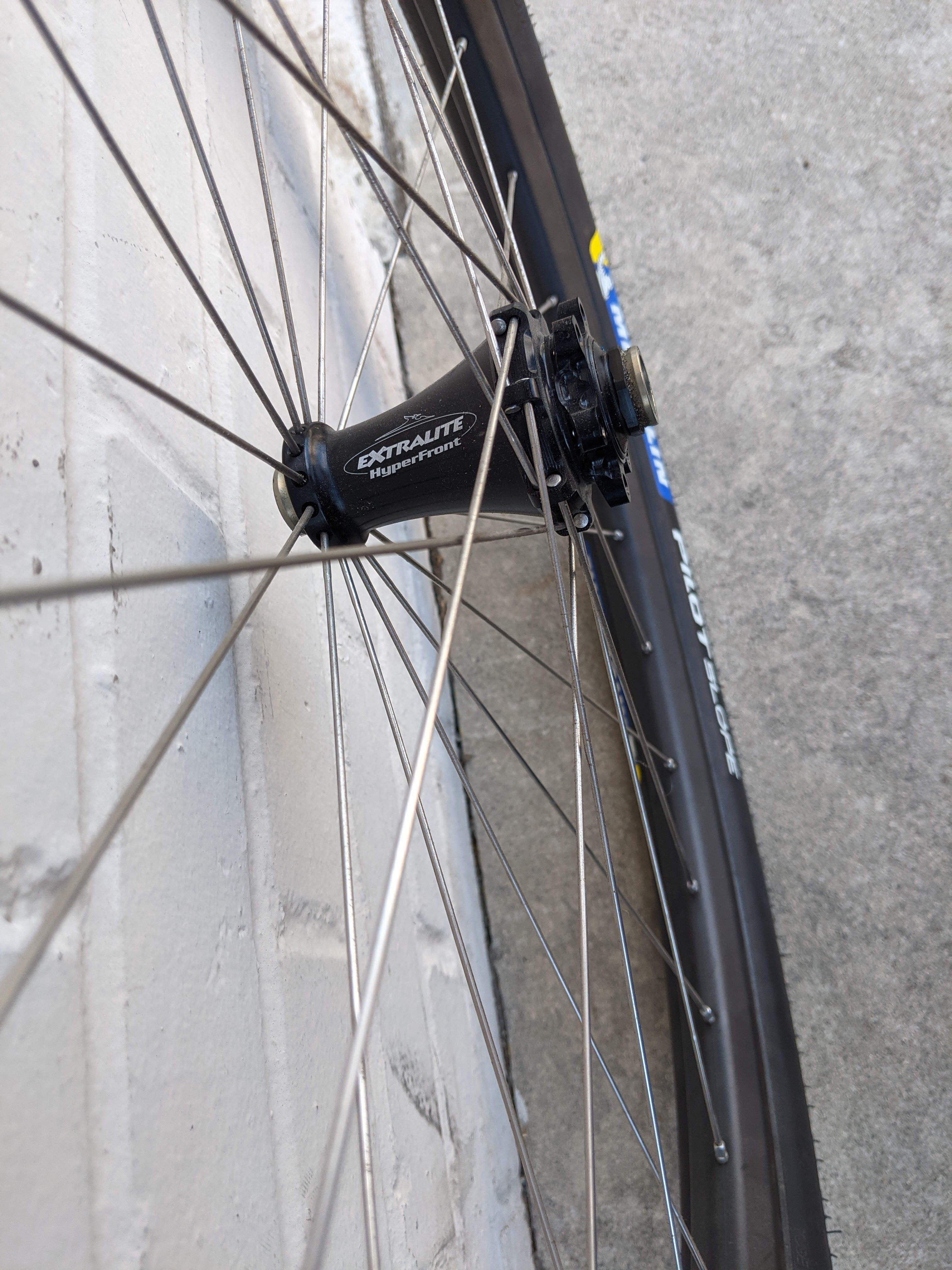

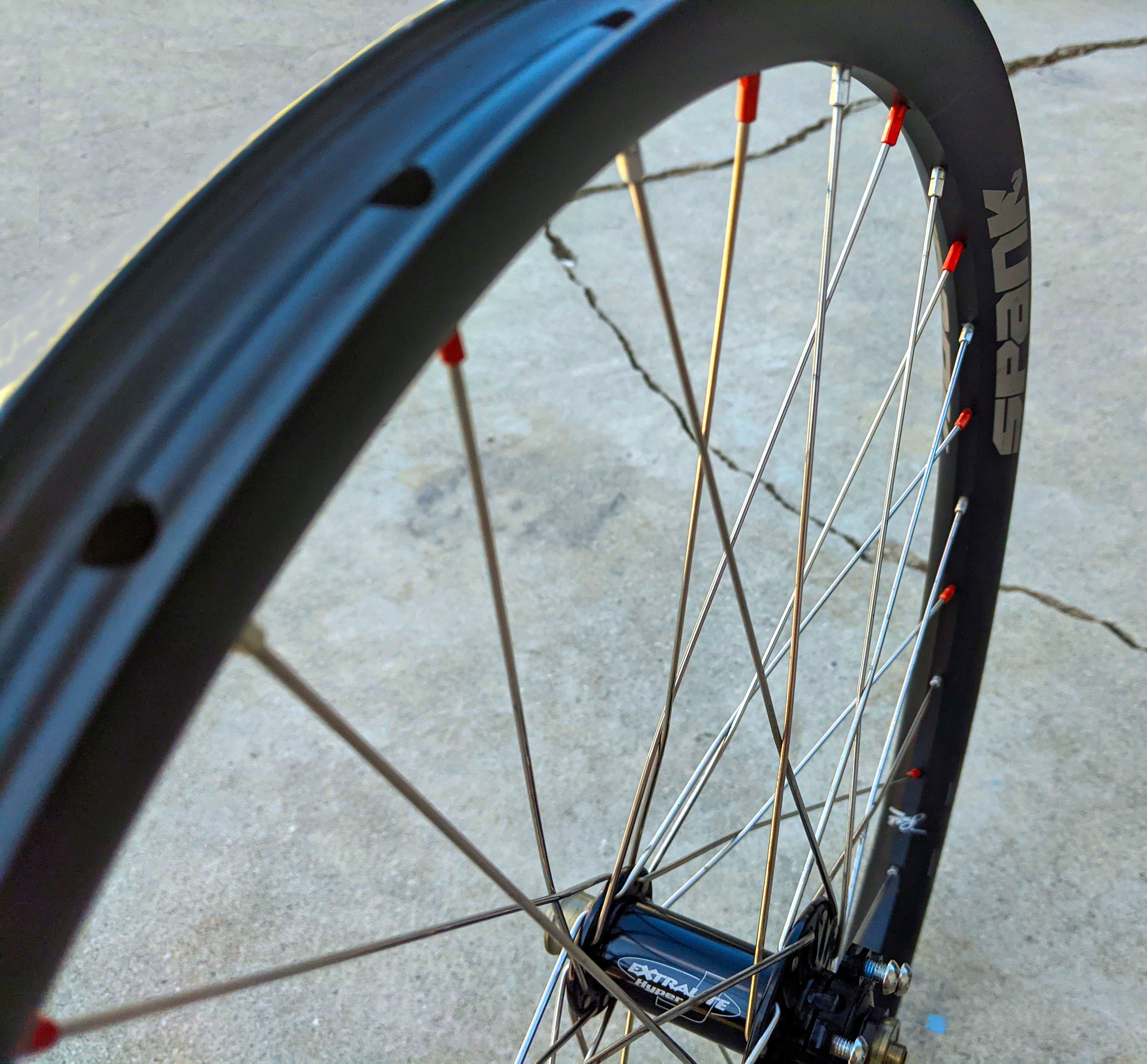

Adam I am completely sold on these hubs. I have 3 of them and the oldest is going on 2 years now and has seen the most use and it is still perfect. The one below is the real gold standard, Hyper Front. It's 76 grams and straight pull 3x disc side and straight pull radial non disc. I wanted to run it on my TMS Evo6, but a carbon disc fork with a 15mm through axle didn't happen so I ran it on my Hex and it was a dream. I ran it with a 203 rotor and it never failed. I'm back on 24" wheels now and I can't find straight pull spokes short enough (double butted) to run the Hyper Front hub on 24" hoops so I'm back on the J bend Hyper JF hub. The prices are comparable with other high end hubs and the build quality is top notch. If I break one, I'll let you know.

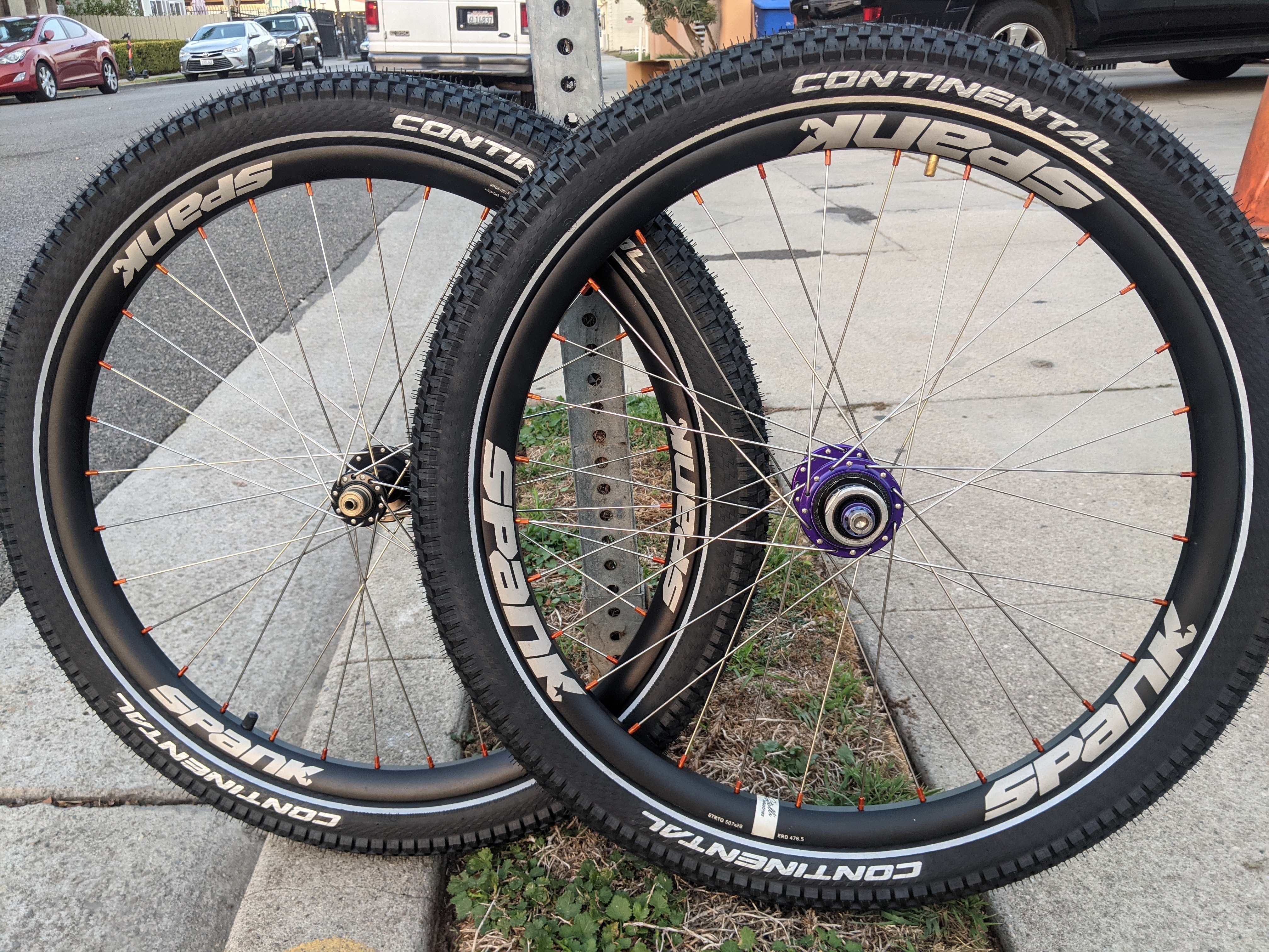

No idea. I plan on using a different sprung tensioner anyway. Unfortunately Marino doesn't offer a 135 through axle. Wheels are done now. My purple Profile hub will have to do for the rear; hopefully the color will fit. I re-nippled the front first and tried a silver - orange pattern that I might go back to.

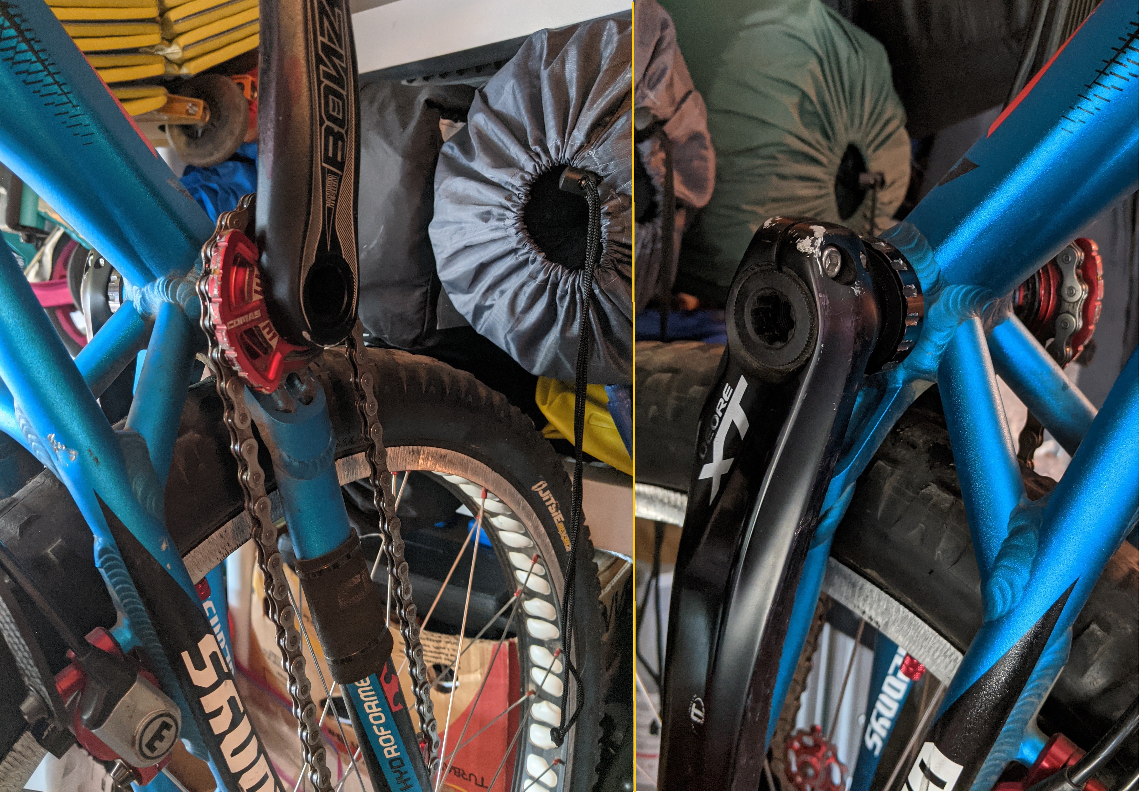

I have the Bonz on my Ozonys Curve also and it has been flawless. For me the key was to replace the non drive side arm and it's been great ever since. I think since the BB is so wide on the Guilty there wasn't enough meat on the spindle for the other arm to hold onto.
