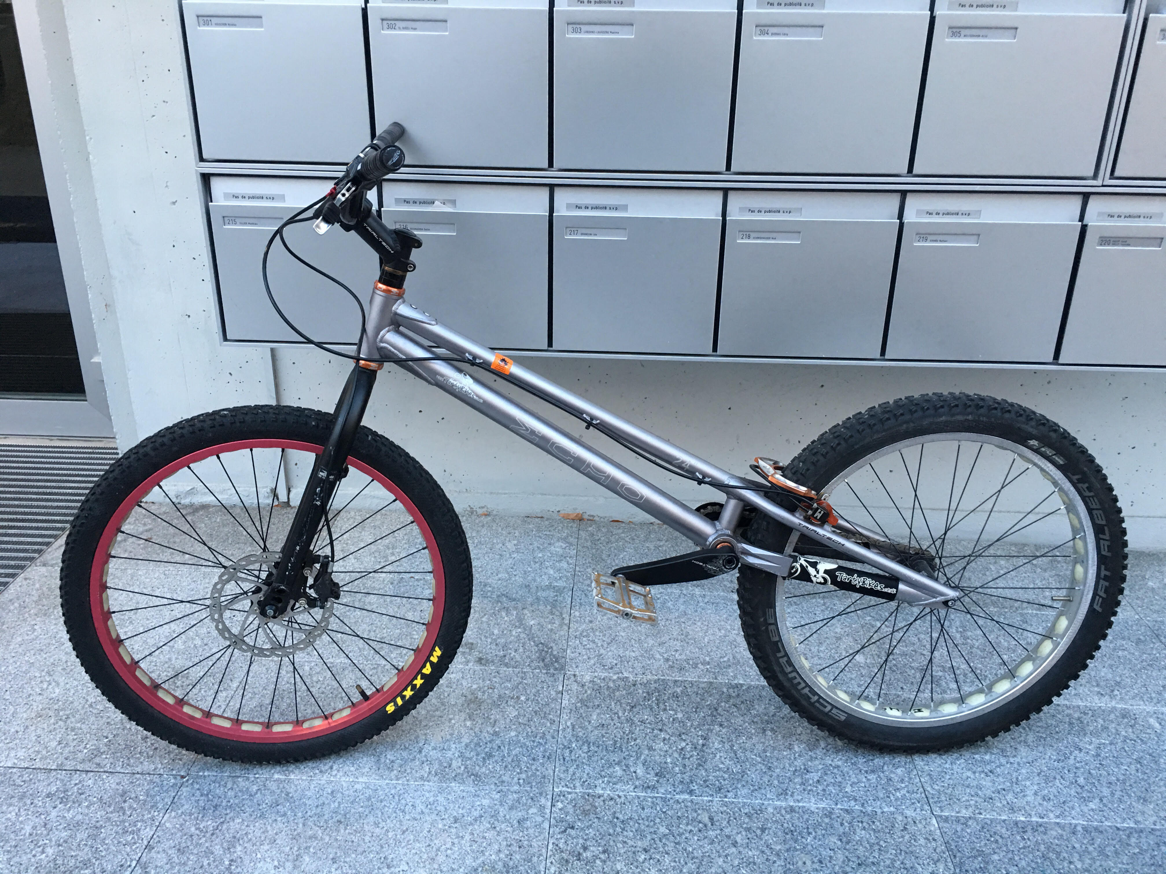

After running out of pure trials spots in vicinity and basically getting a bit bored of pogo sticks, but still keeping my love for high bottom brackets and rim brakes, I've decided to modify the front end of my bike so I can bunny hop and manual, but still do pure trials moves as well. Here goes... Frame: Echo Trials 24" Fork: Echo Urban 2011 (I think) Front rim: Echo 2016 Front tyre: Maxxis Snyper Front hub: Trialtech Sport Lite disc Rear rim: Neon Single Rear Tyre: Schwalbe Fat Albert Rear hub: Jitsie 135HS Race BB: Echo Urban Freewheel: Trialtech Splined 108 Cranks: Trialtech Sport Lite Pedals: Echo Urban platform Stem: Trialtech forged, not sure about the dimensions but probably 80x30º, comes as standard with Inspired bikes Handlebars: Jitsie Carbon 110mm rise, 690mm width Front brakes: Avid Juicy, 180mm rotor Rear brakes: Trialtech Sport lever with Echo slave cylinders and Heatsink Yellow pads Voilà les garçons, not as sexy as Ross's Vader, but I just love how this bike feels! And if I (ever) want to go back to pure trials, All I have to do is put my old long stem back and tilt the bars waaaaaay forward
