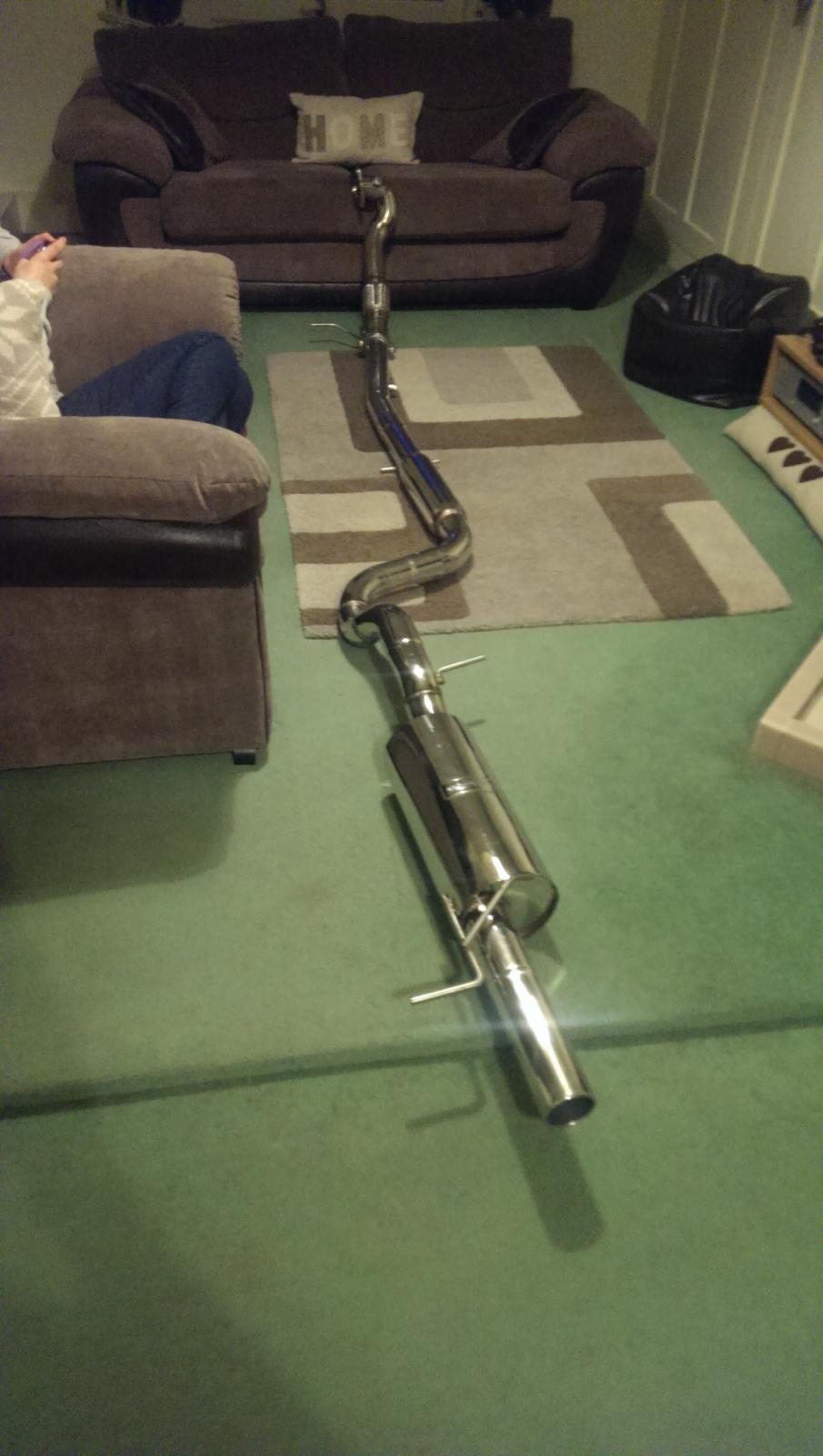

  16. Its not on the car, but hopefully this shows the shape clear enough: Hope that helps

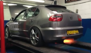

  17. Car only made 324bhp and 315ftlbs. Not happy The mapper isn't impressed with the exhaust manifold at all. Slightly annoying seeing as it's cost me the best part of £500 to get it on and fitted!

  19. If you're going your spend money on the exhaust anywhere, get a 3" downpipe. That's where the money is worth spending (the stock downpipe is SO restrictive its untrue). Infact, while you're looking, buy this complete system: http://www.ebay.com/itm/VW-Golf-GTi-Jetta-MK4-99-04-1-8L-3-Turbo-Back-Exhaust-Catback-1-8T-w-Downpipe-/331161432742?pt=Motors_Car_Truck_Parts_Accessories&hash=item4d1ac272a6&vxp=mtr Myself, Prawn (running nearly 400bhp) and a few other high powered 1.8t's are all running it. For the money it costs, the quality is insane. I had to buy a new downpipe because I have a different turbo, but it will fit from the turbo all the way to the tailpipe on yours. Works out to about £170 posted, and mine came in 3 days. Literally couldn't ask for better! Dooooooooo it!
