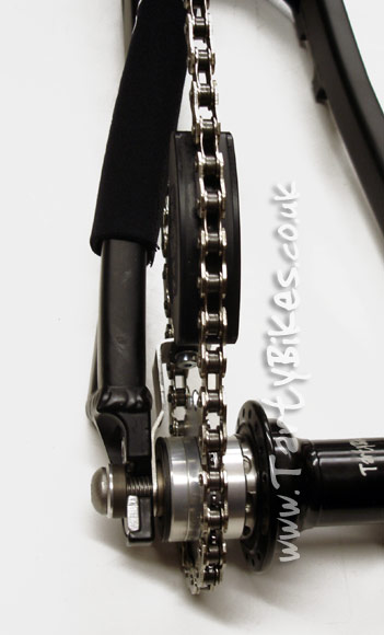

Hope Pro II 07 rear hub with a Surly splined sprocket (19tooth), Trialtech carbon single speed spacer kit, 74 Kingz single speed chain tensioner and middleburn RS7 cranks with (20tooth) chain ring?
Dont see why they shouldnt. I've been running an old cassette that I drilled and used the spacers out for the past 2-3 years, Never had any trouble. WIth the 74 kings tensioner it moves the wheel over to the left. if your running a fat tyre may have clearence issues!

As for your tyre clearence, you should be fine!
As you can see the 74kings tensioner only moves your hub a little, nothing to worry about!
