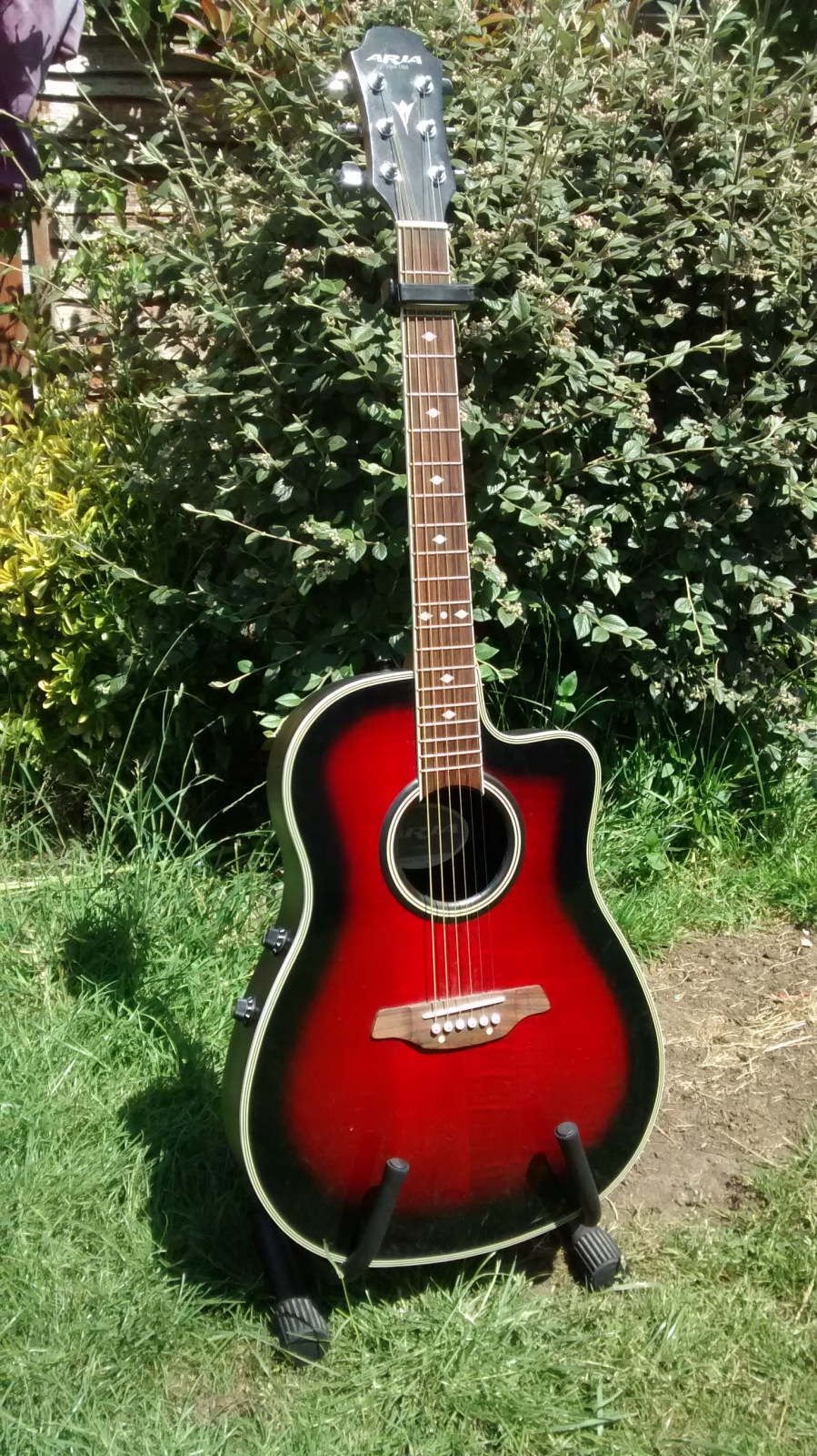

Not really, I highly doubt you'll get more than that on eBay. Even if it does sell for say £80 you've got fees to pay and maybe sending if it's not for collection. Best bet is probably your local gumtree and have someone come collect.
