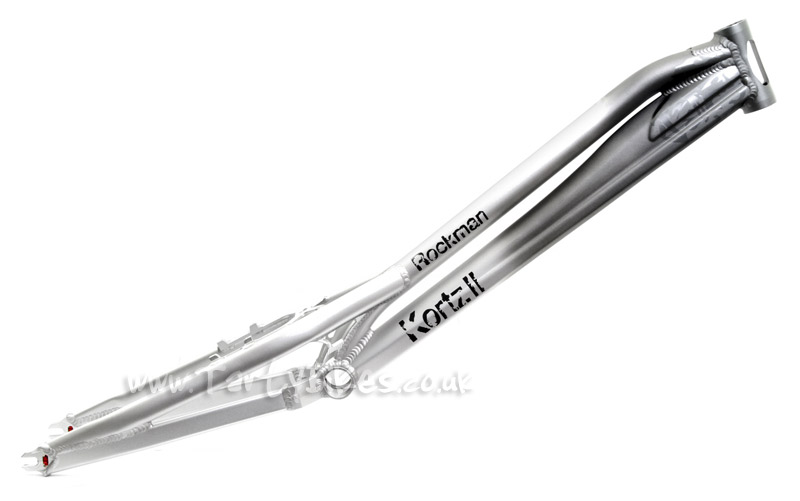

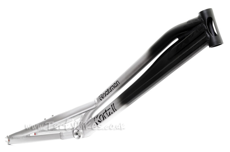

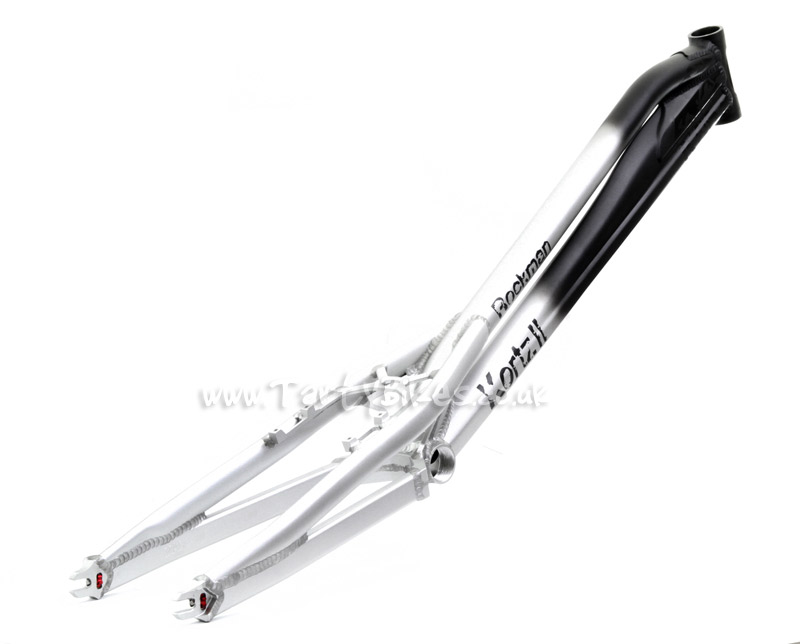

Update: Rockman Kortz 2 Will be released within the next few weeks!!
Here is a picture of my prototype:
Updates from the original kortz:
New Hydroformed Downtube with flat bottom to increase the resistance to Dents (seems very good so far)
2Piece hollow chainstay yoke from the slate 2 frame
New compact dropouts with integrated tensioners
New Headtube
New Geometry, 1095mm, +60mm, 380mm CS and 72deg HA
Reduced angle between seat stays and top tube, this has reduced the risk of cracking at this point as the previous frame did.
I have had the proto now for 4-5 months and it has been very good, rides very well and has out lasted both of my original kortz frames and is still going strong!
Thanks
Adam
First thought was copy of rockman traktor. Graphics ain't very good eather..
As far as i am aware these are not the final graphics, they just put those on the frame as it was a proto, I will update this when I get the final production pictures.
Adam
