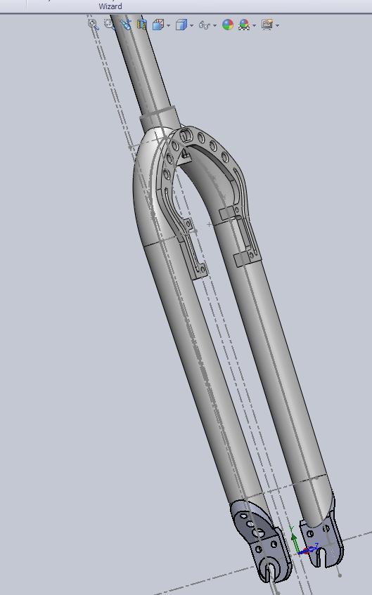

I'm not sure what CAD program you're using - looks like Solidworks - you should be able to put in offset while keeping the forks straight bladed by selecting an axis where you want the legs to join at the bottom of the steerer tube, selecting a plane at the same time and then selecting the 'make new plane' option. Then draw your sweep path along that plane. Works that way in ProE anyway.
Straight blade forks are the way to go since putting the same curve on both fork legs will be a manufacturing difficulty depending on the equipment you have handy, and welding the brake mounts to a curved fork blade will be a pain. I'd put the brake mounts on the front of the fork every time. The reason being that by default the back of the fork legs will be in tension at all times except while you're endoing, so the fork will fail more quickly all other things being equal with the mounts on the back. The last fork I used with rear brake mounts was an Echo Urban, lasted all of 6 months before snapping. The replacement Onza fork is still fine 1.5 years on, though it is steel :)...

Hmm, everyone seems to prefer the reverse mount :S I'll see i guess. Managed to get the steerer at an angle thanks to you (Y)

Are you using solidworks? for the CAD?
Certainly am :)

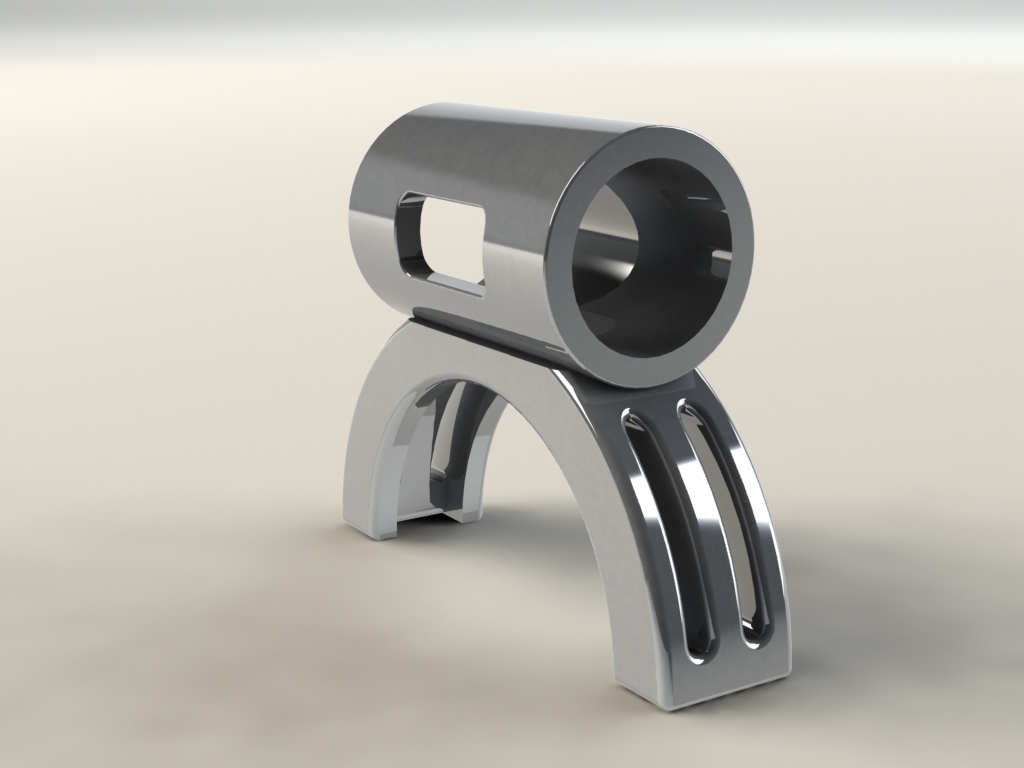

I'd still have questions about the BB yoke but it depends how far you need to take it and how clued up the assessor is. Are you actually planning getting the frame manufactured and built?
Erm, well in their eyes its fine as it is....however, as im building it i want it done to the best level possible. Any suggestions you have are more than welcome dave :)

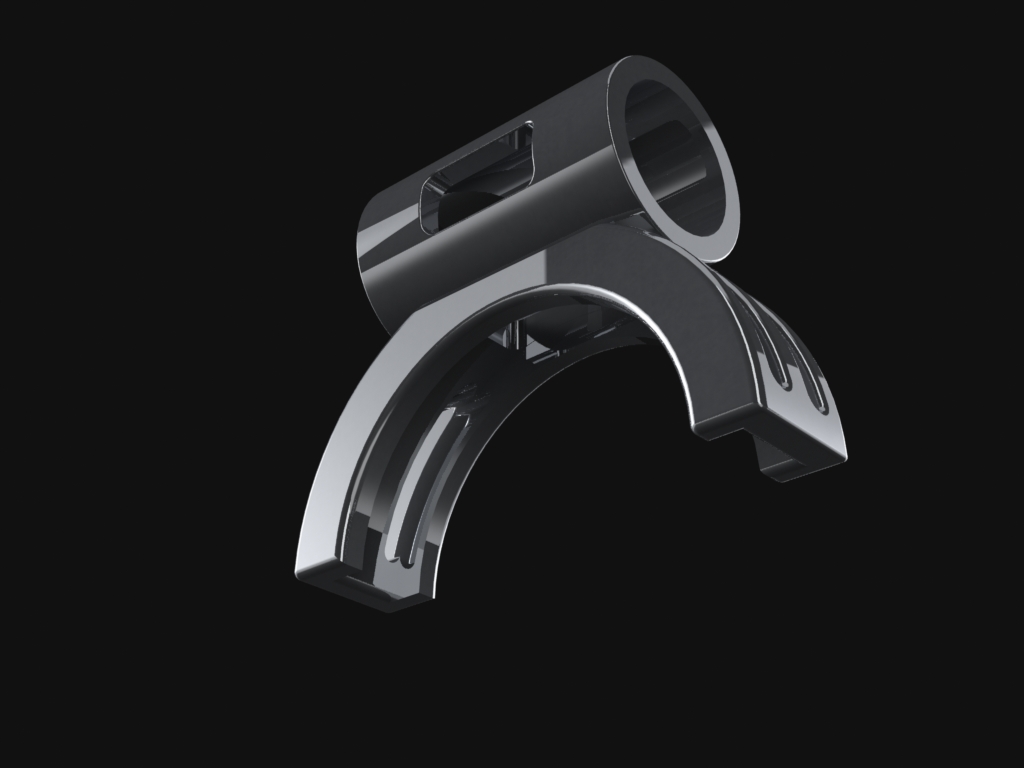

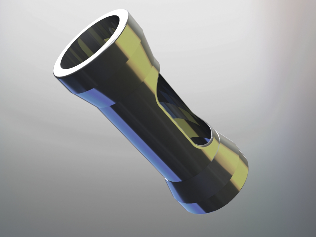

Hope that makes sense. Where the chainstays attach it might be worth tweaking it to actually meet the full section of the tubing as at the moment you'll end up with massive stress raisers at the ends of the 'C' section. There are also bits of the yoke edges which don't include a radius. It would tidy it up nicely if they all matched to create a nice, smooth flowing piece.
Where the chainstay parts of the yoke meet the BB shell itself I'm still not sure it'll be possible to produce it. If you could smooth the outside edges of the yoke to meet the BB cup ends it would make for an easier to manufacture piece although you may have to rework the lightening slots a bit as well.
The final point is probably just an oddity of the display but there seesm to be something a bit odd going on in the slot which passes through the BB shell.
It does look proper pimp in full render though! Very impressive :).
