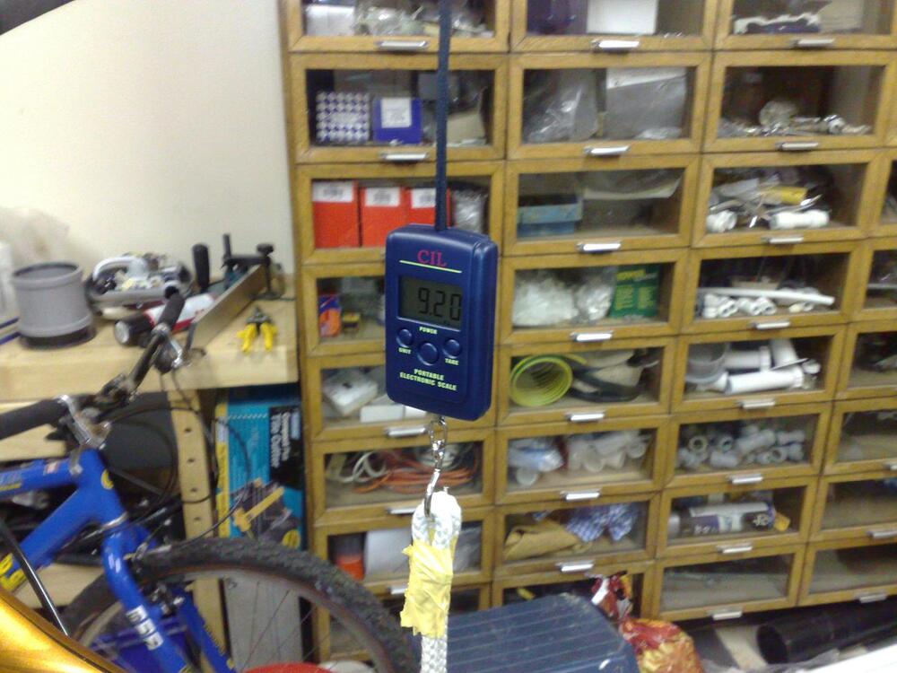

Coust V2 9.2kg

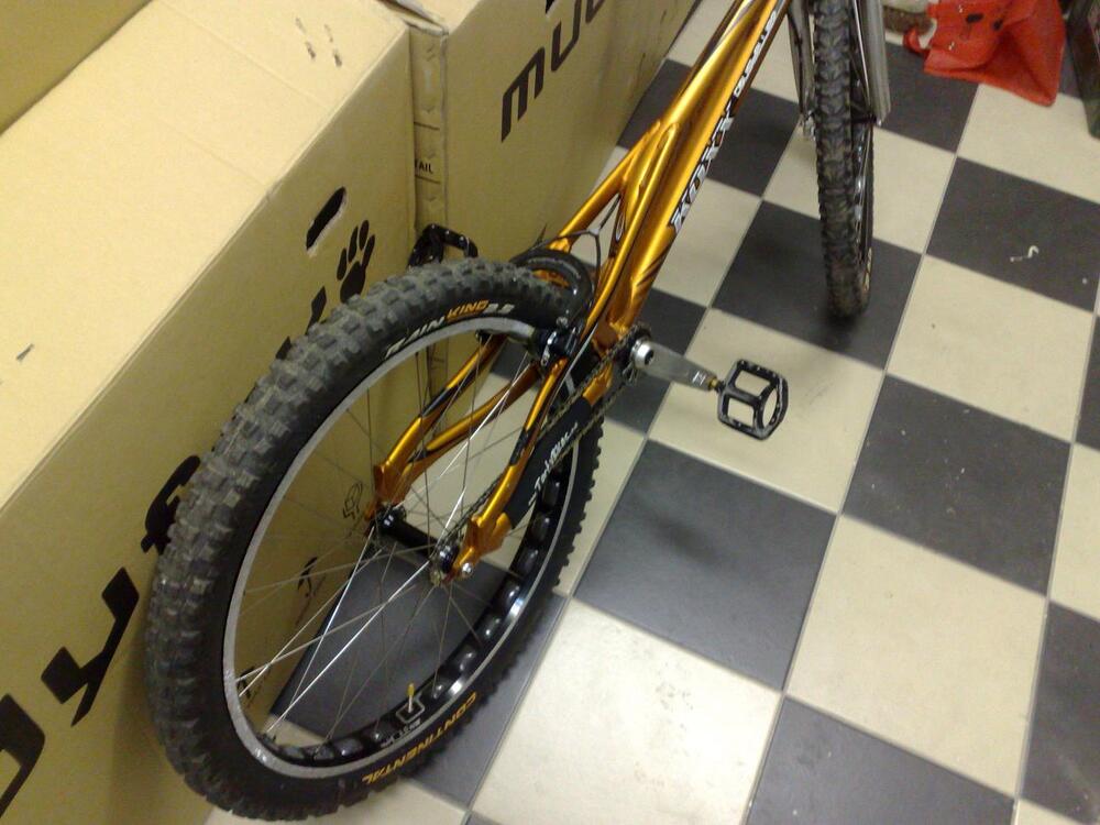

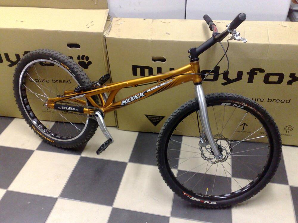

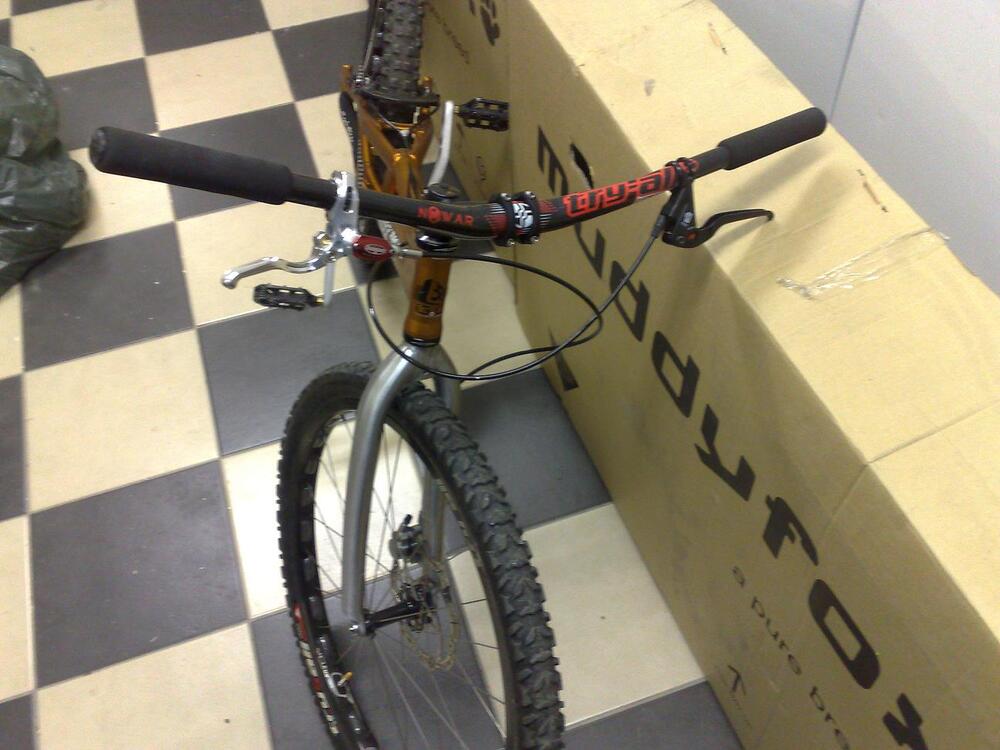

These aren't the best pics in the world I took them with my phone and in a bit of a rush but I just thought people might like to see my coustellier V2. I've gone a bit sick on pimping it out. Anyway here it is.
Got to give a big shout out to Adam at Tarty bikes where I got everything from.
Full spec goes....
Frame Coust V2
Forks Koxx Forxx
Headset Meta
Stem Tartybikes
Bars Tryall carbon
BB Reset Ti
Cranks Tryall 175mm
Bash Trial-Tech half ring
Freewheel Tryall 108.9
Chain Tryall
Pedals Trial-Tech Ti axles
Crank bolts Echo
Front hub Tryall H
Front Rim Tryall Hole
Front brake Hope Tryall
Front Tyre Tryall
Rear hub Tryall H
Rear rim Tryall Hole
Rear brake Magura 4 finger/Monty splitter/Tryall croco yellows/Echo SL clamps/Trial-Tech carbon booster
Rear tyre Conti Rain King
Grips Trial-Tech
Ti bolts and alloy bolts everywhere I could get them
Thats about all I can think of for now if you want to know anything else feel free to ask. Please don't ask me how much it cost because I really don't want to know lol.
argh mines 10.6 the tank :(
soon to be 10.4.......then maybe sub 10 if i can find enough dolla for new tyres
looks pimp as fek though dude (Y)
Thanks man I did have it down to 8.72 but the tyres were cack.
