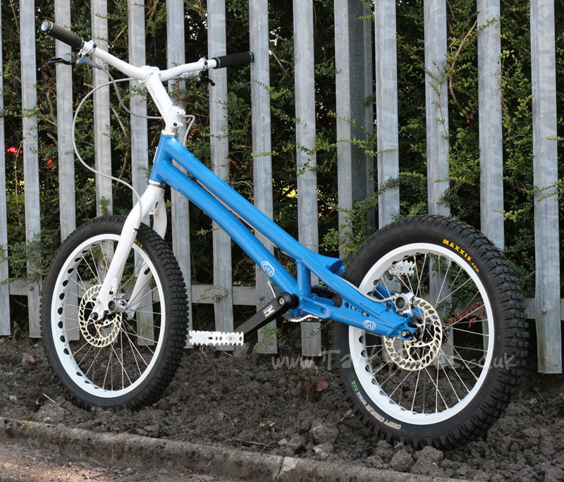

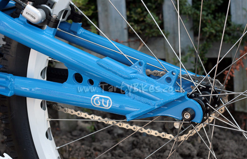

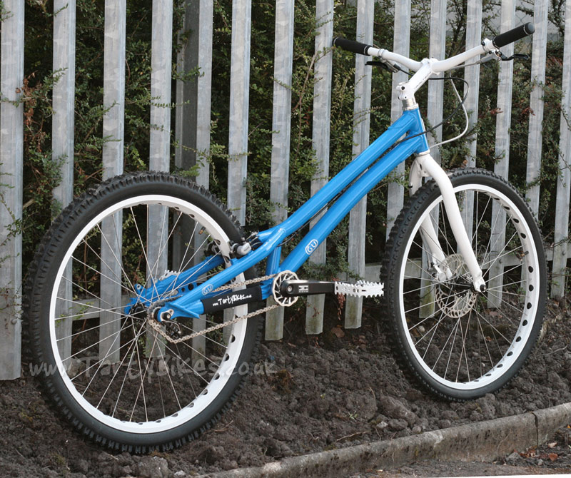

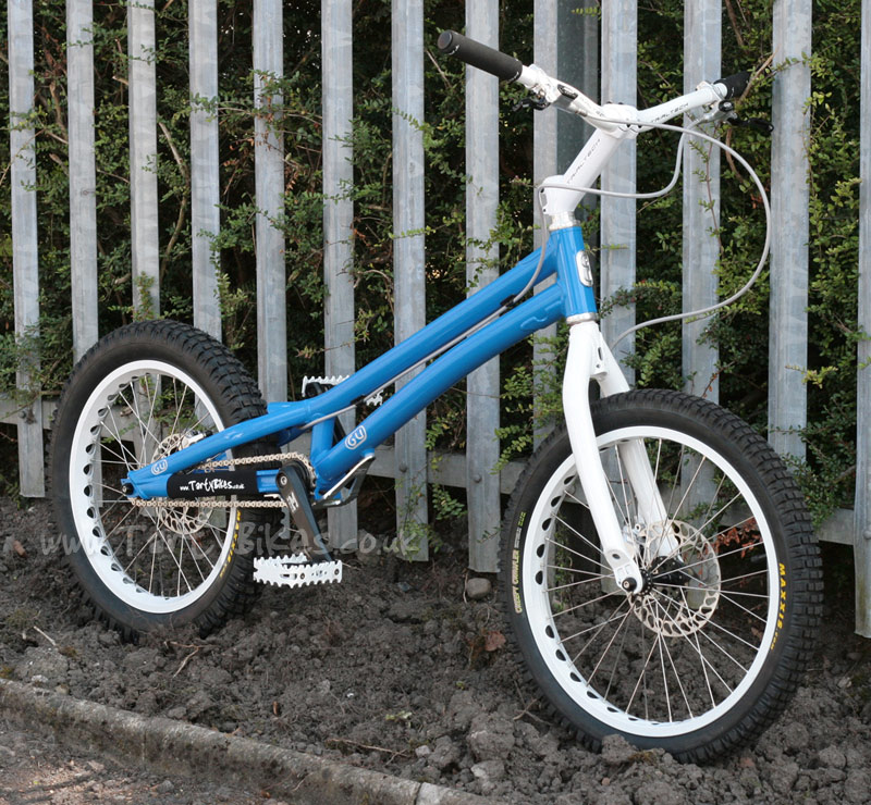

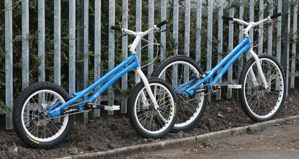

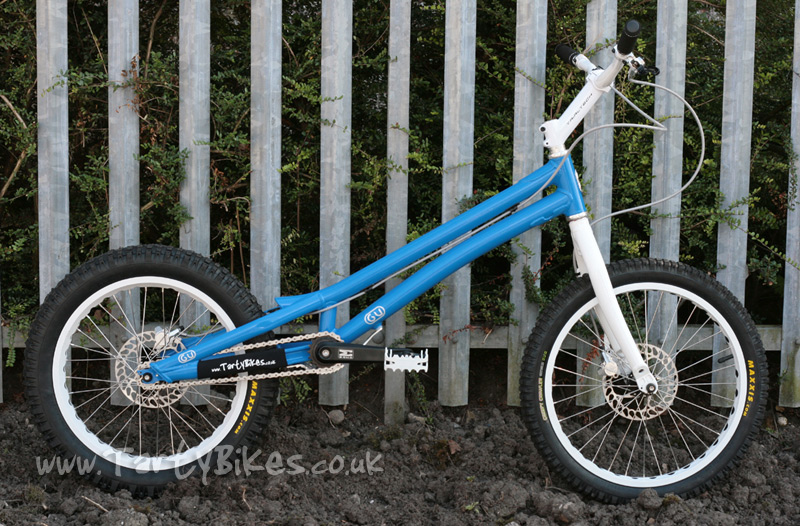

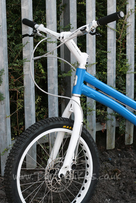

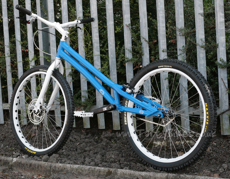

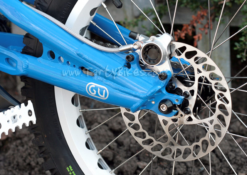

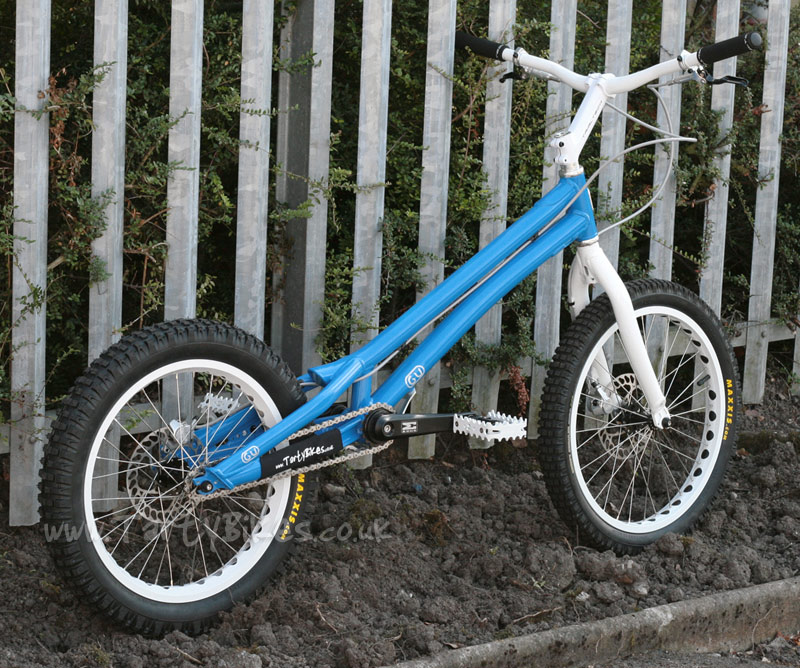

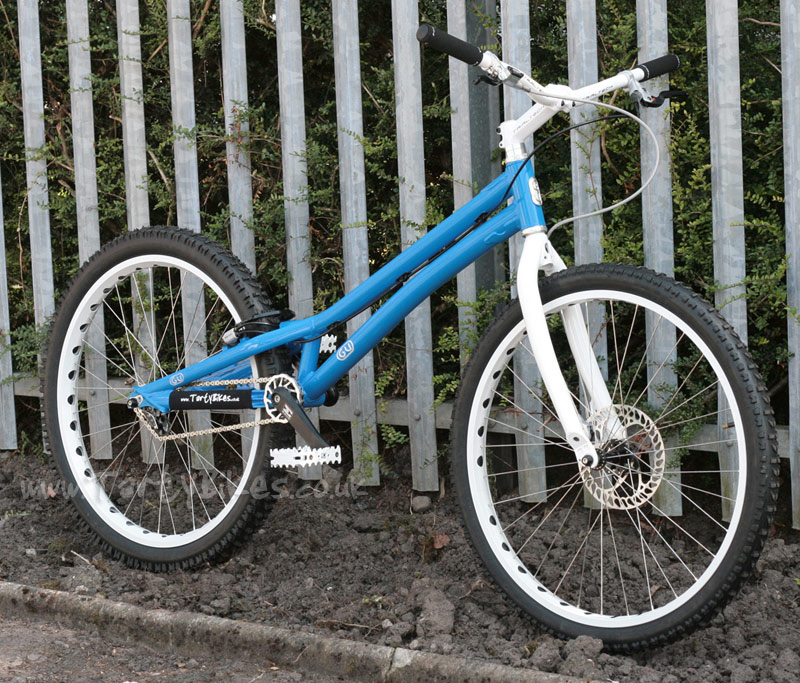

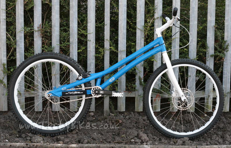

We got some of the new GU frames in and thought it would be rather cool to build them up into a pair of 'little and large' twins... here's the result!
20" model with dual Hope brakes:
Wheelbase: 1010mm
Chainstay Length: 362mm
BB Rise: 60mm
Head Angle: 72 degrees
Centre of BB shell to top centre of head tube: 615mm
Weight: 9.92kg
26" model:
Wheelbase: 1085mm
Chainstay Length: 380mm
BB Rise: 35mm
Centre of BB shell to top centre of head tube: 680mm
Weight: 10.48kg
Hope you like!
Adam
Wow! Haha, bit of a surprise to see them in baby blue! I thought they'd be in yellow.
Anyway, looks nice, and it's interesting to see Deng step out of the ol' silver and black frames.
I have wondered this though... reading that this new LE is made of 6061 alu, whereas the black 08 ones were made of Ultra 6 (6066 alu); being a slight downgrade in material, does the same hold true for the 2009 Python and Team? Similarly, are the Lynx and new Lite made of 6061 too? Sure, the prices are lower, but I do miss seeing bunches of sturdy and beefy U6 frames.
The white fits this bike very excellent though!!
