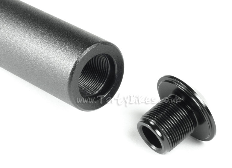

The steerer tube is cut to fit my friends frame and is 15mm too short when on mine. This means the top of the forks is 15mm too far away for the top cap to screw in.

I have this exact problem with a set I am currently trying to buy.
I am going to make an adapter that screws into the fork using the thread designed for the top cap thing, and has an M5 thread so you can use a normal topcap and bolt.
If I can get it made, I will see if I have enough material to make two, and if I can I could make one for you aswell?
If not I'll send you the design and you could get someone like Edd Potts to make it for you. (Y)
It may be a week or two before I get it sorted out though I'm afraid, will keep you posted though.
I made a ghetto star nut thang when I wanted to use a Try-All sloping stem on my trialtechs. I cut the 'mushroom' top off the screw in bolt, found an M5 nut with a small ridge around the bottom on Porter's dashboard, screwed the threaded bit into my forks with the nut on the bottom, put in a normal top cap and bolt and there we are.

Basically, picture a steerer tube with a huuuuge bolt in it, that goes through your top cap, and a nut that you can tighten, which presses on the outside of the forks - thus pulling the topcap- and everything underneath it - into the forks.
